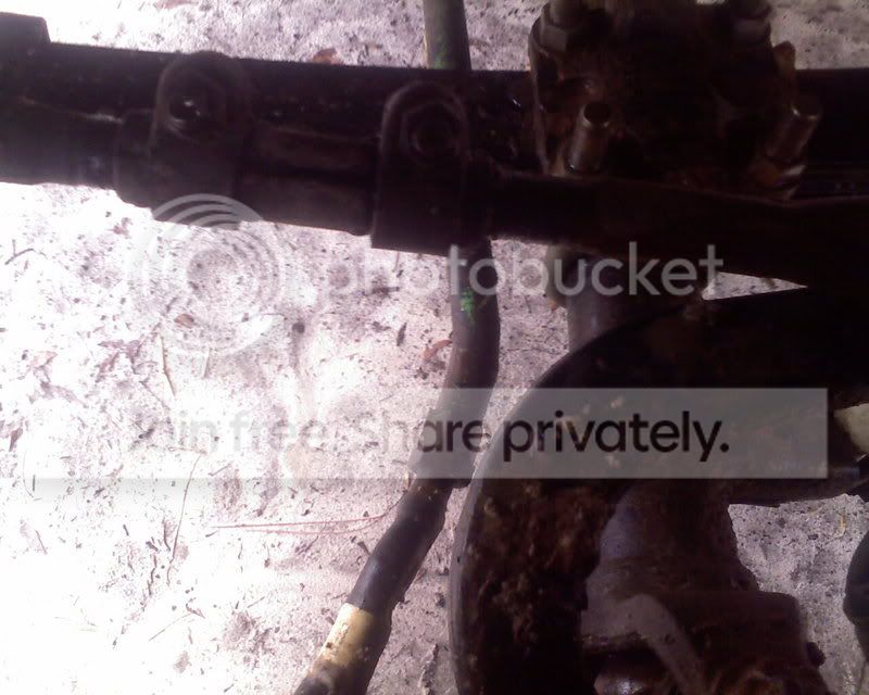

so i'm pretty sure i found out what the problem was today, but it was never as bad as it was today, the sleeve that connects the 2 tierod ends.
so does anyone know were i can get a new heavy duty one?
Yeah that would be a problem.
I bought my HD tie rod from SKY a few years ago.
