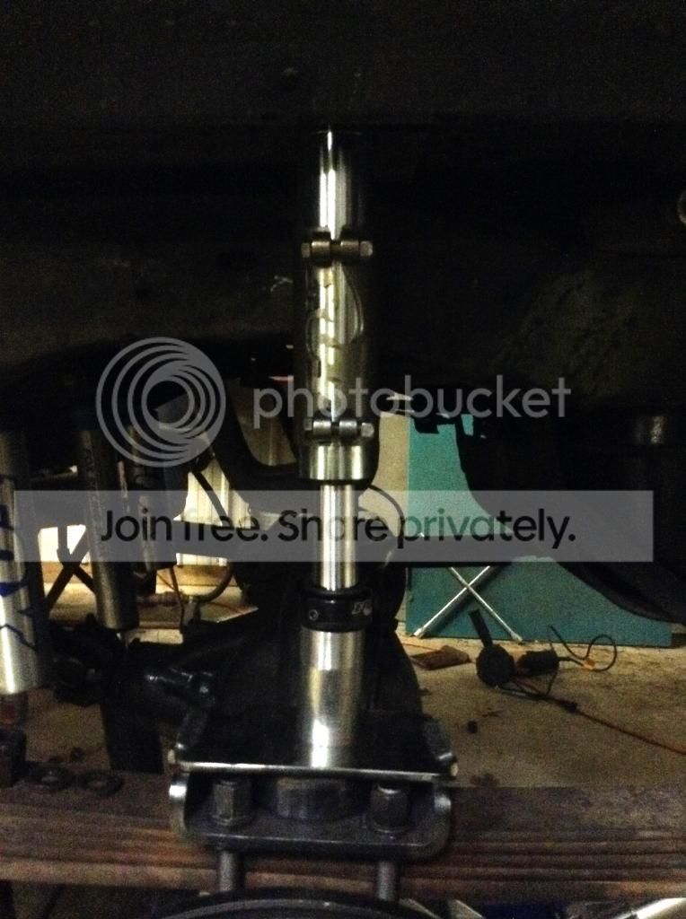

Does anybody know what kind of bump travel you can safely achieve with stock 52s with the overload before you start ruining them?
Im setting up my air bumps in the rear with the intent on running some ORD springs in the future. But for now I will be running the stock springs... My bumps will be set just shy of 6" static bump travel. But I can install a tube spacer between the can and bump stop so that I dont kill these springs really fast in the dunes if it is necessary. And then remove the spacer later on when i pony up for the ORD springs.

Well I talked to Stephen, he gave me some good info and some things to look out for on my suspension setup..... But i think im still gonna setup the bumps with a tube spacer to run 4.5" of bump travel with these springs. :whistle:
Ill make it an experiment :D
