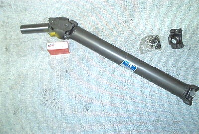

does it look like
a:
or
b:
It looks like the first one except the slip shaft is on the transfercase instead of the rear end.
he has a fixed yoke 205... u should be fine with the stock shaft. i had the stock shaft lengthened for my 8" on my k5 which has a shorter wheelbase and it worked, jus had vibs. when i added zero-rates, it now longer worked.
