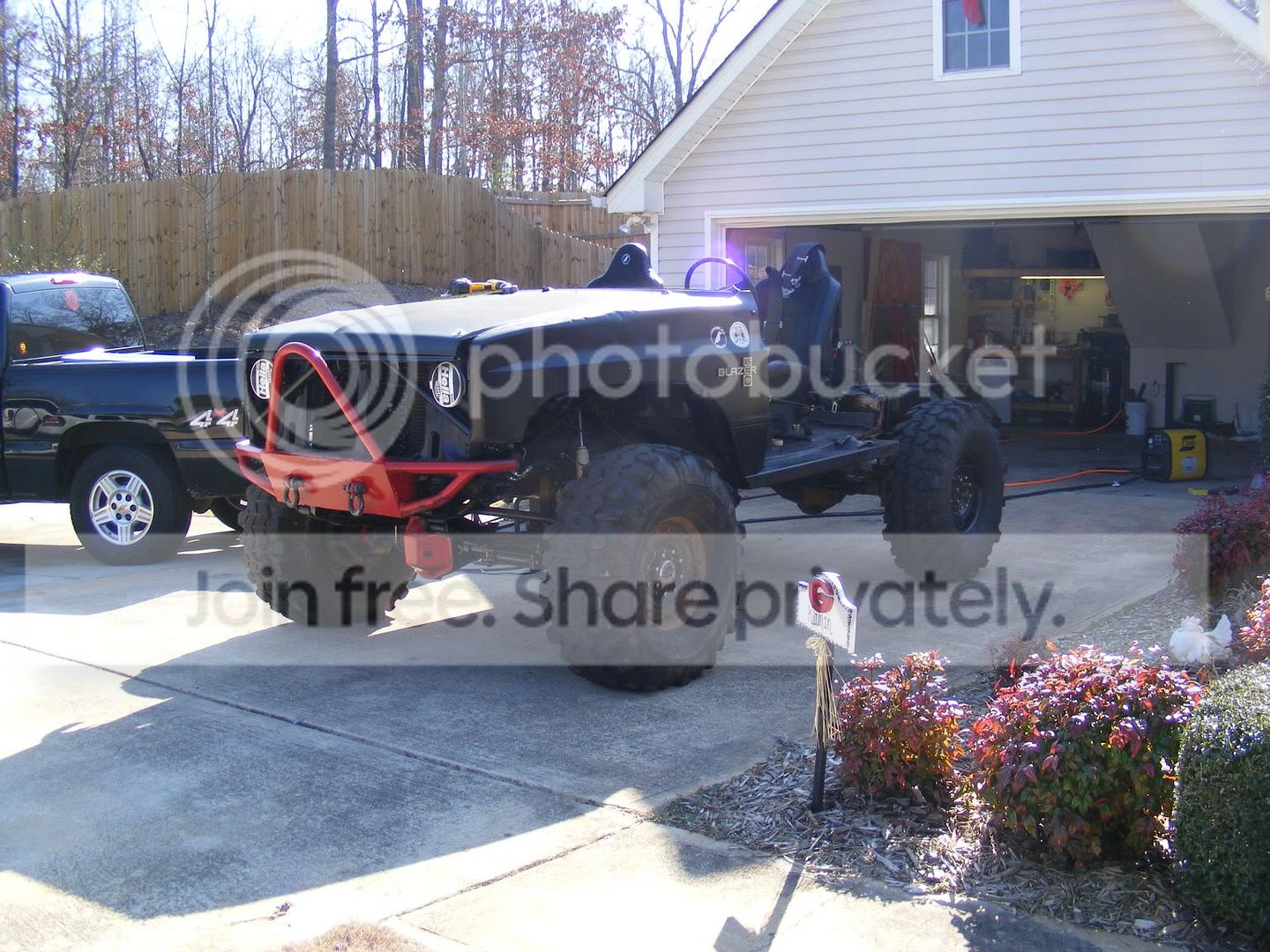

its pretty sweet. my truck when i bought it had a 1 year old paint job. rebuilt motor and trans 15000 miles old. sweet truck with the only thing wrong with it was a few stains in the carpet. not after a year of owning it it has 6 inch lift 37's herculiner interior 14 bff and dana 44. and some other odds and ends. just trim the front of the fender and trimming the rear of it today. a new 241 is in the mail and ordering a SYE and new driveshafts. it should be pretty capable after im done.
When i bought it
Did some things
Then came the lift and axle swaps

Here's a pic o my rig fully flexed
