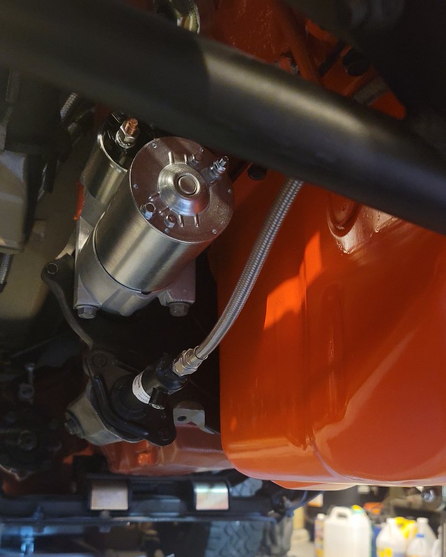

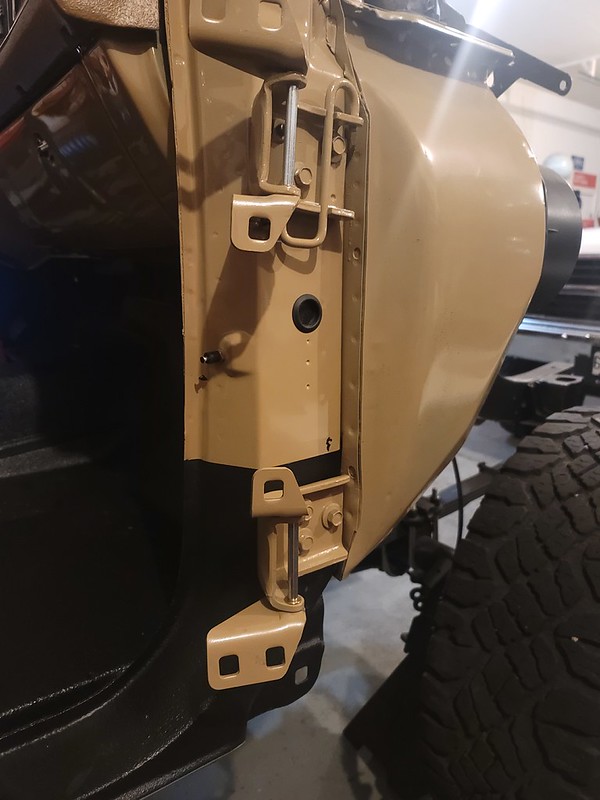

It’s not much, but if you try to spend at least an hour a day on a project progress is being made even if it’s as simple as sand blasting door hinges one day, painting them the next and assembling and installing them on the 3rd. All of the little BS needs to be done sooner or later. I still need to go shopping at my favorite retail establishment for a driver’s upper door hinge. Not sure if I lost it to toss it because the spring was broken. I seem to remember the door driver’s door hinge from the donor C20 was trashed.
Very small wins for the K5 this week but it’s still progress.........:waytogo:

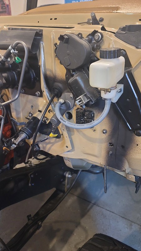

First, the clutch got juice and bled. This one was definitely one of the more difficult ones I’ve bled alone as I’m using a early 90’s bell with the passengers side slave cylinder so the hose is 5 feet long! (Earl’s PN 64191960ERL hose, 592054ERL fitting for the master cylinder and LS641001ERL for the slave). When I couldn’t get juice down to the slave I just decided to leave the bleeder cracked open at the slave over night to hopefully get some drips by morning. Hell no! The entire reservoir spilled out of the floor sometime overnight! o_0 Even with juice now though the line it took some finagling between a power bleeder and manual bleeding to finally get the air out. In the end, it worked out fine but boy, is that pedal stiff! That doesn’t make sense as the clutch is the typical Centerforce that I use in everything, the master is the same but this is the first time I’ve ever used this particular early 90’s GMT400 slave in anything. My dad owned a few of those trucks back in the day with this particular slave cylinder and I don’t remember the pedals being this stiff on those trucks. On the other hand, I love these Tilton reservoirs as they hold a lot of juice whereas the small original reservoir for the 85+ squares are too small. My K10 still has a tiny original reservoir and you can feel the fluid getting warm on the trail after about an hour of being in an out of the clutch a thousand times. I need to upgrade that one someday....I should have done it when the fender was off a couple years ago to fix Desert Trip trail rash.
Then it sprouted a new Remy starter as well as a two-piece speedo cable. I needed up using a two-piece speedo cable from an old 70’s Buick/Cadillac/Oldsmobile big body car in order to route the cable the way I wanted it to go for clearance of JB Custom Fab triple stick shifter cables
