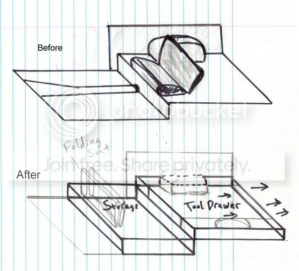

Strange idea for 84 Blazer interior mod..
Here is a drawing of my design..
Basically.. what is happening is that I am raising the floor height from below the front bench all the way back almost uniform. And chopping the wheel wells. And then putting storage beneath. And then by having the bench moved to the front, and fold forward, it will allow more room throughout.

It looks like your new design won't work.
Won't the seat hit the steering wheel way before it ever gets close to being in the vertical "space saving" position you have in your diagram???? :thinking:

diesel4me, that sounds really cool. If I can't figure out how to do it this way.. or if I don't have the guts to cut my wheel wells I might try this route. That's the biggest question for me.. I don't want my wheels hitting the lowered wheel wells. Gotta figure out some easy way to test that.
Greg72, I was planning on having the surface that the folding seat is mounted on slide on the tracks that my current seat slides on. Hopefully this works.
