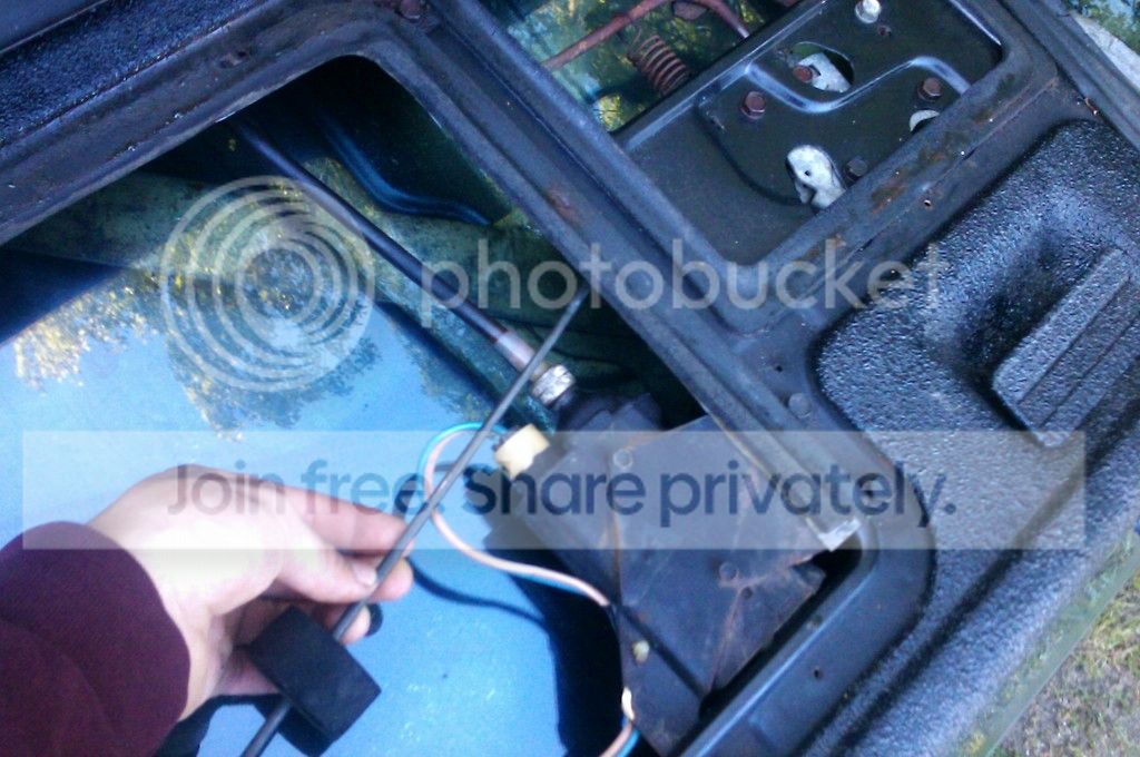

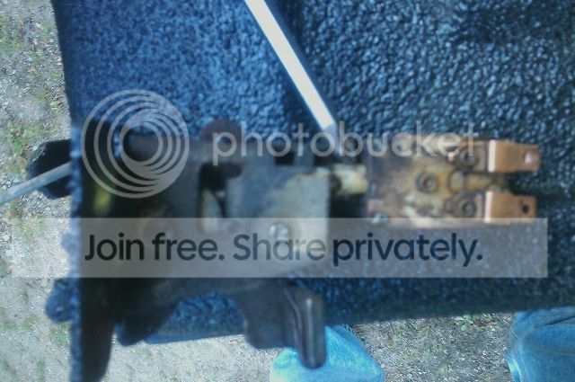

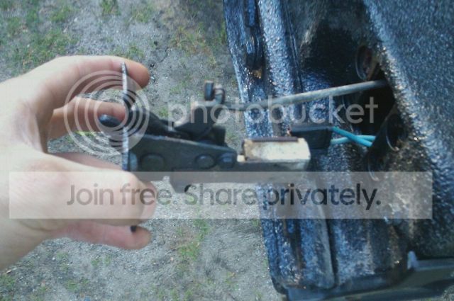

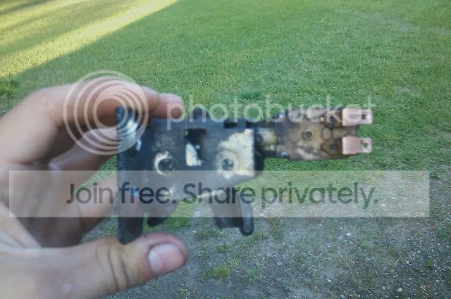

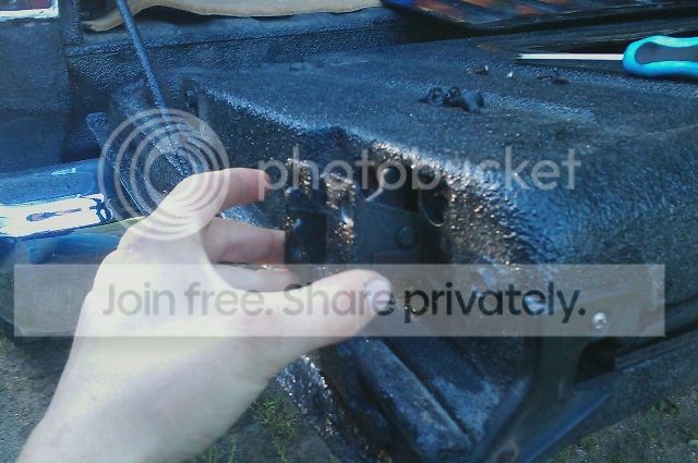

Here is that switch brian. With detailed removal pics for noobs like me :thumb:
1. Remove the "rod thing" :haha:
Mine broke here and must not have been making contact when closed. I cut the wires and soldered them together. Now i can open it in the down position to clean and grease. Just make sure to support the glass. :waytogo:
Are you talking about the two blue wires that go into that plug on the drivers side latch inside the tailgate. Splice those together?
