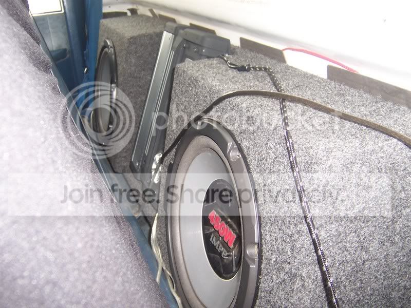

If it's going in a blazer you could do something like this. Leper built this one...

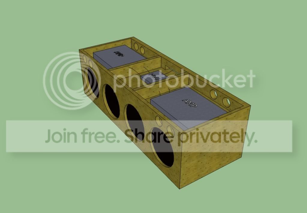

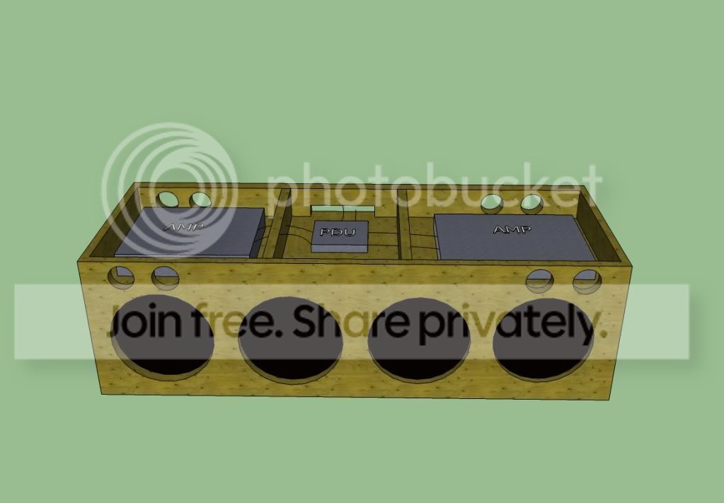

Moving on...a buddy and I built a box for his K5 that held 4 12" subs and two amps. We used a bunch of 5/8 no-void marine plywood (free scraps from a local boat builder) and sprayed it with rubber undercoating. It sounded awesome but it was ridiculously heavy...took 3 people to load/unload it.
No pics and it's a slow day at work so I modeled it (roughly) in Google SketchUp. It was designed to fit between the rear wheel wells and the tailgate. There was also a hinged top covering the amp rack. Originally we had fans in the vent holes but at highway speeds with the top off the airflow was messing them up so we just put fan grilles over the holes and left them open. We wanted something that could still hit hard on the highway with the top off and this beast did the trick.

the one leper did is EXACTLY what I wanted, but these sound pretty good, I can't wait until I get a larger amp, I only have a 420W, if you have one sitting around, please, feel free to get a hold of me.

Leper, if you read this, I may be interested in PAYING you to make me a box like that.
Here are the internal pics of the box. I built that box with a $20 saber saw and a Harbor Freight dremel knockoff, in my driveway. Patience is the only thing you need to do a copy. That was done for my daughters truck, and I would only build something like that for her. Besides, it weighed over a hundred pounds when it was finished, kind of a shipping killer.

your gifted, do you realize that?
I had NO idea it was THAT involved, I may just stick to my bandpass for a bit longer, till I have the time to do something like that.
