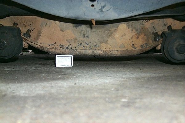

    Seen it and the Blazer will be getting it done. Although I have no idea why I would want to do it since I got this one this low and will raise it and put the 2.5" spindles on it.
    [​IMG]
    BTW, that is a standard matchbox. It is in front of the crossmember because it wouldn't go under.
    For the rear, you will HAVE to notch the floorpan under the rear seat to get it low.
