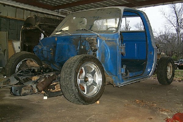

The pics above are of my bagged trucks crossmember.
You ain't gonna get lower than that! As far as bag vs springs, you aren't thinking in correct terms. An airbag IS a spring. You can make it as low as you want an still have the same ride quality, but with springs, you are limited to your height. In essence, your limiting factor of going low isn't springs or bags, it is the body, like Ken said. You are pretty much going to have to mod ANY truck for full suspension travel after about 5" front and 7" rear. For the front, you will have to modify the inner fenders, for the rear you will have to notch the frame. Otherwise, you will be hitting. You get lower than 7" in front, and you will be cutting the A/C box to clear the tire.
Notice the clearance above the passenger front tire at the heater box.
For the rear, after about 7" you are going to have to cut into the body tub so the differential will clear the body.
