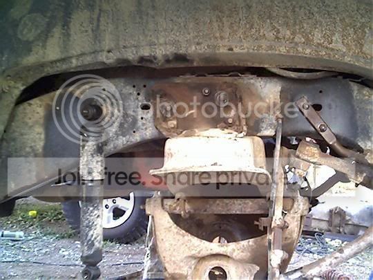

lookin good but WOW that makes my frame look beefy(no offence). No wonder I have had sucha hard time making things work. the one ton frame is this big all the way to the engine bay then its normal sized.
heres a pic to explain as you can see the front where the steering is is normal 1/2 ton frame rails then as you move back the frame gets taller but it does so from the top down. So in order to make shackle hangers work I have had to drop the front hangers down. Otherwise my pinion would have a sever downward angle.
you can see the square tube i used to drop the front hangrs down in this pic. Its 3.5"x3.5" 1/4" wall
It would have been much easier to do it like you did I think and possibly I would be driving the dang thing by now.
Anyway good work Im liking it.
