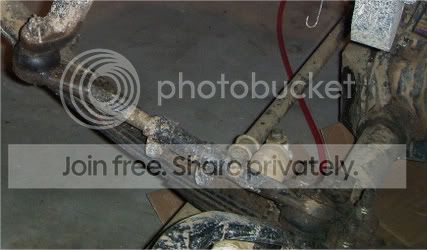

Here's a pic of my stuff:

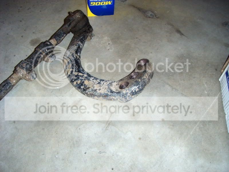

Avery, I have a Skyjacker raised steering arm thats 2" taller than a regular raised steering arm. Skyjacker offers a 4" and 6" raised arm and I have the 6". I will sell it to you and then all you need is the stock type drag link which is 100 times better than any S-shaped DL.
If you use my 6" arm, you can get the CA50 pitman arm and your stock type DL will be damn near parallel which is the ideal operating angle.
PM Me and I'll make you a hell-of-a-deal on this...
It's a little dirty but worked fine when I did my crossover steering.
Avery already has a raised steering arm. Do you have a drop pitman arm in that pic other than the straight DL?
Nope I sold it to ? forgot his name in Oregon, sorry no just the arm and the linkage.

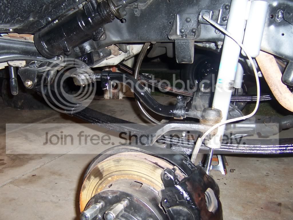

I'll take some pics of the truck tomorrow as it sits at ride height because with removing some leaves from the front pack it sits a good 1-2" lower than it did before and I'm concerned that I might have too much drop with my current setup so I'm thinking the 2" drop pitman arm with a straight draglink and my 4" raised steering arm might be ideal since I'm closer to a 6" lift right now anyways.
Thoughts on all of that?
Eliminate the SL drop DL immediately and go back to the stock straight DL. Not sure what anyone was thinking when they designed the aftermarket DL's but the stock type is the best over all of them.
Yes, get a drop pitman arm and since you already have a raised steering arm, keep it. With the 1.5" drop on the pitman arm and the 4" raised steering arm, you'd be at 5.5" of steering correction. I know your springs are 8" but after you removed the leaves, how much did the truck lower down?
If your truck didn't lower more than 1" or so, I'd look into the 6" steering arm from SJ and still use their pitman arm for a total of 7.5" of correction. This setup puts the DL right damn near perfect operating angle.

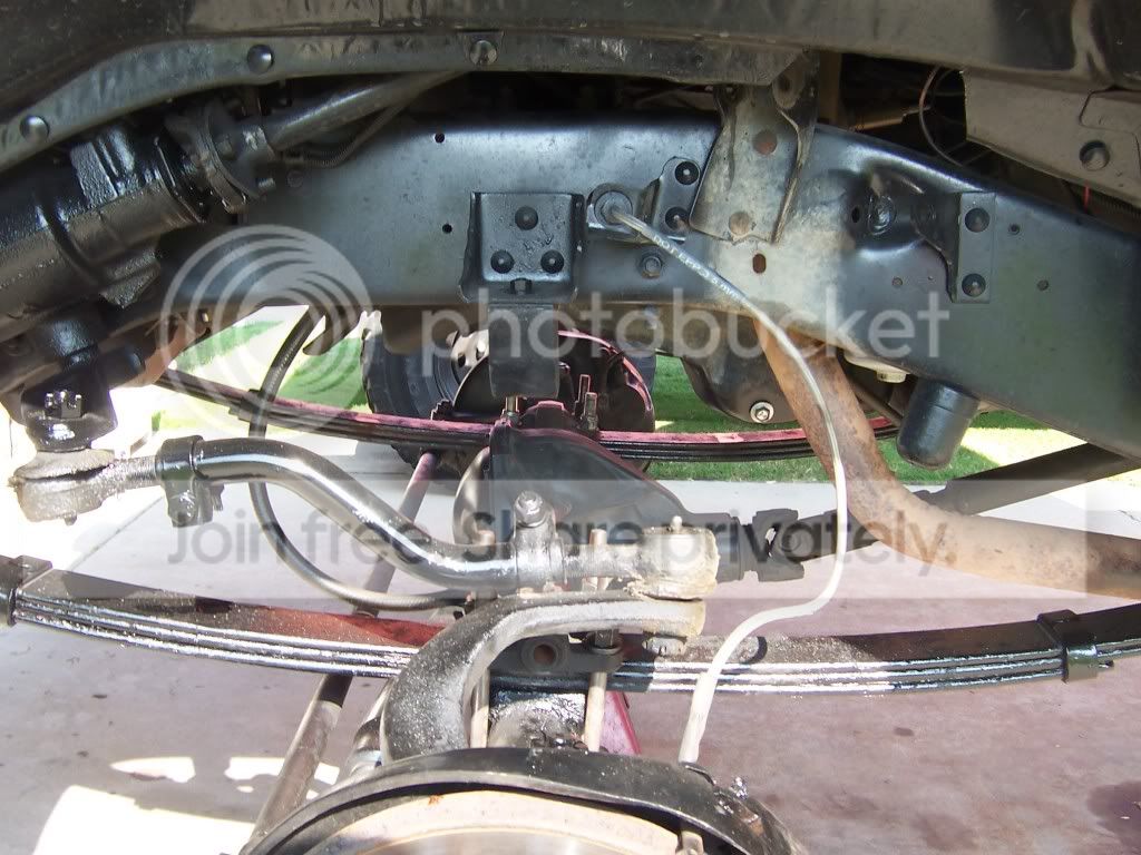

I just took this pic and as you can see the collar on the lower part of the DL is rubbing on the steering arm... plus the DLE's are all out of whack so I think a drop pitman arm and a straight DL will be just about perfect (well as perfect as push/pull steering can be). :)
Yep, I agree. Drop pitman arm #CA50 and new DL from your local Pep Girls and you're good to go.
