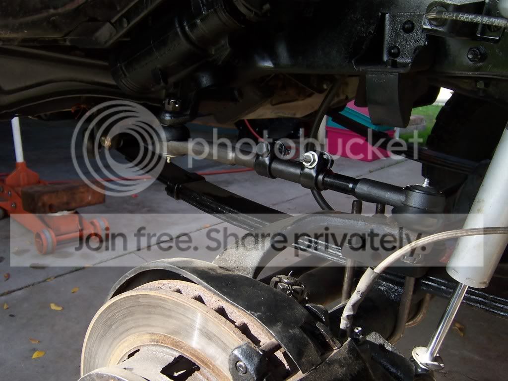

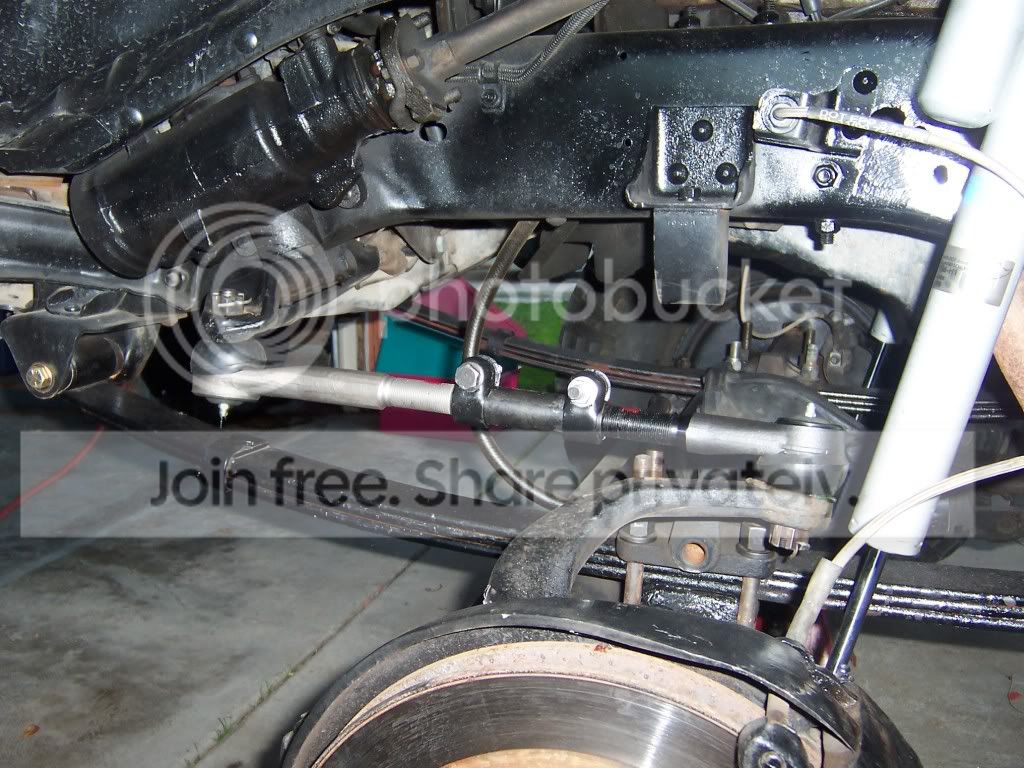

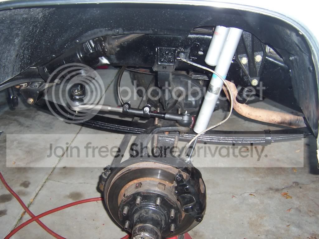

I picked it up from him tonight and the sleeve is in pretty good shape. I'll use it to mock it all up and see where I stand then get some new ends... if it's a PITA to thread apart I'll get a new sleeve.
I got this whole steering issue taken care of today... I had to go to 3 places to get the parts but it's done and man does it steer great compared to the old setup.

Yeah I never had a problem with loose or wandering steering but I did notice today that I pick up a lot more coming through the wheel, but in a good way. It's nice and tight (at least by push/pull standards).
I think I might look into an XJ shaft to help tighten it up even more, but for now this'll do... it's 100X better than the old setup at least. :wink1:
