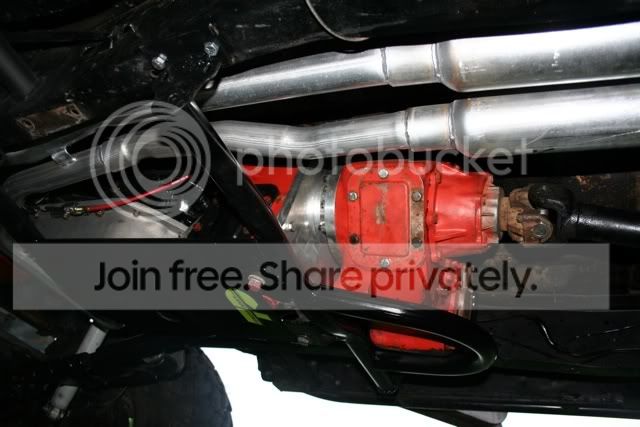

The PTO cover is on the driver side of the case. It is sheetmetal and about 4"x6" with 6 bolts holding it on, it can be seen in the right side/middle of this picture. The drive sleeve is removeable on the newer adapters and is also in this picture (bottom/middle), it will have 27 internal spines on both ends and it is smooth on the outside.
The PTO cover is on the DRIVER side of the case. It is sheetmetal and about 4"x6" with 6 bolts holding it on, it can be seen in the right side/middle of this picture. The drive sleeve is removeable on the newer adapters and is also in this picture (bottom/middle), it will have 27 internal spines on both ends and it is smooth on the outside.

In order to check for the sleeve you'll have to split the trans and case it goes inside the adapter and joins the two splined shafts.The pto door is on the ds of the case and will have 6 bolts holdin it on and look like this.
