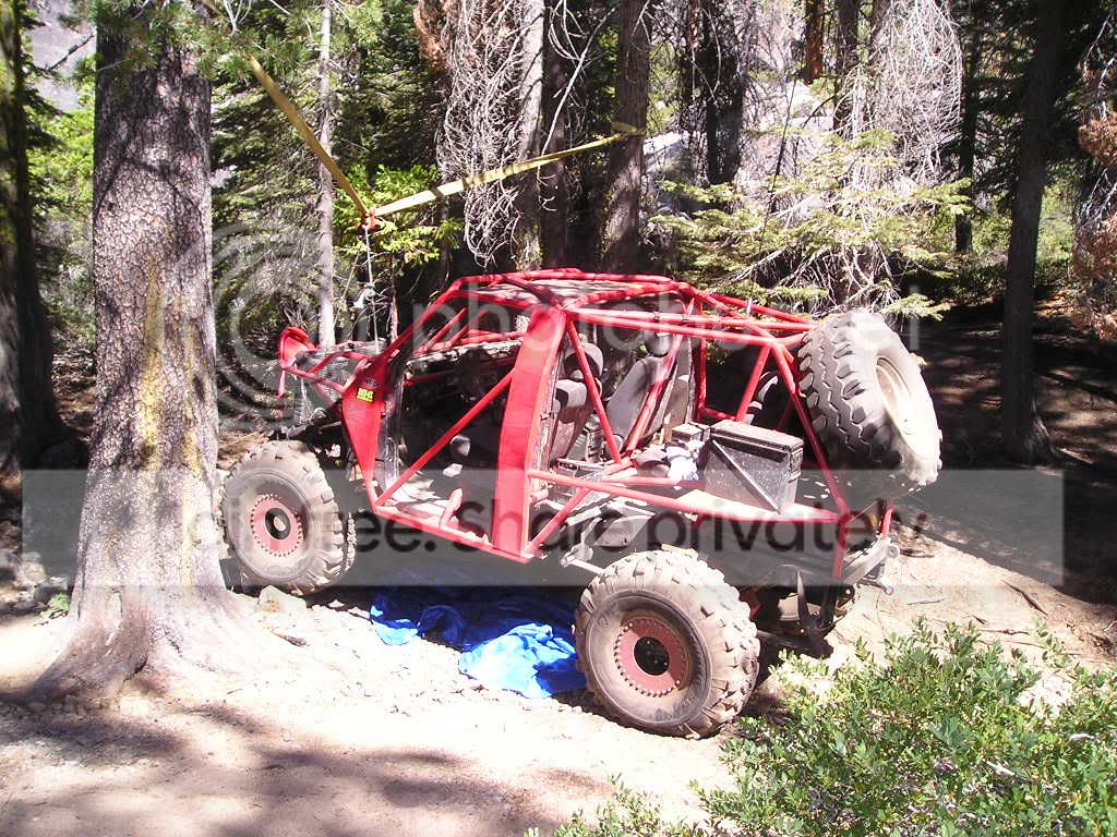

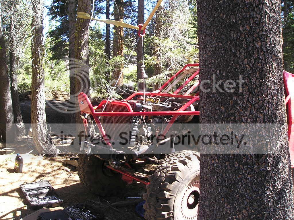

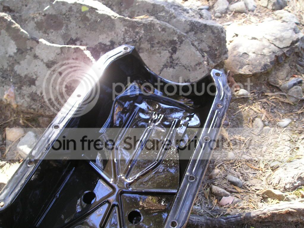

What your lookin at is a McGyver style engine hoist. I was running Fordyce Creek Trail a few months ago, and came down off a 3' ledge super hard and bounced the oil pan off my gay, booty fabbed engine x-member. Dented it enough to cause the crank to hit the oil pan. I couldn't remove the x-member cause it's welded in... :doah: So the engine had to come up enough to get the oil pan off so I culd pound out the dent. I was a good 10 hour walk to anything resembling civilization. None of the guys I was with had a jack that would work out. After figuring for a an hour or so on how to get it up, we came up with this. Strung the tow strap between the trees with the shackle, ran the winch rope up to the shackle and back down to the motor. Worked perfect. Was done and back on the trail in under two hours. Ealier that same day, I flopped on Winch Hill #1. Was in a narrow spot where no one could really help out with another winch... So we had to get creative. Routed the winch rope through the exo so that it exited just in front of the drivers door opening, and up the side of the hill to a tree. Rolled myself back onto 4 tires in less than 1 minute. A winch can save your ass in alot of ways, not just pulling yourself or a buddy out of a mudhole. :D
