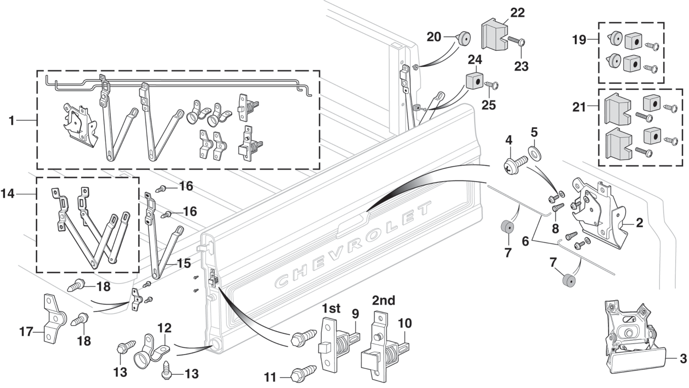

Note the years are listed down below. The graphic shows different year ranges combined. #22 and #23 are where the hinge arms hit below the hinge assy. #19 is above the hinge assy. However, you may not have the right hole for that one if your K5 is a 1981 up. I am not sure if you can use t#20/21 (81-87 style) with the older tailgate, but those are backordered anyway.
..thanks for the pics. My blazer is a '78
