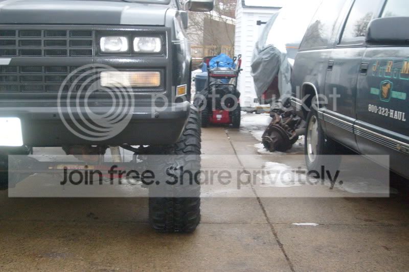

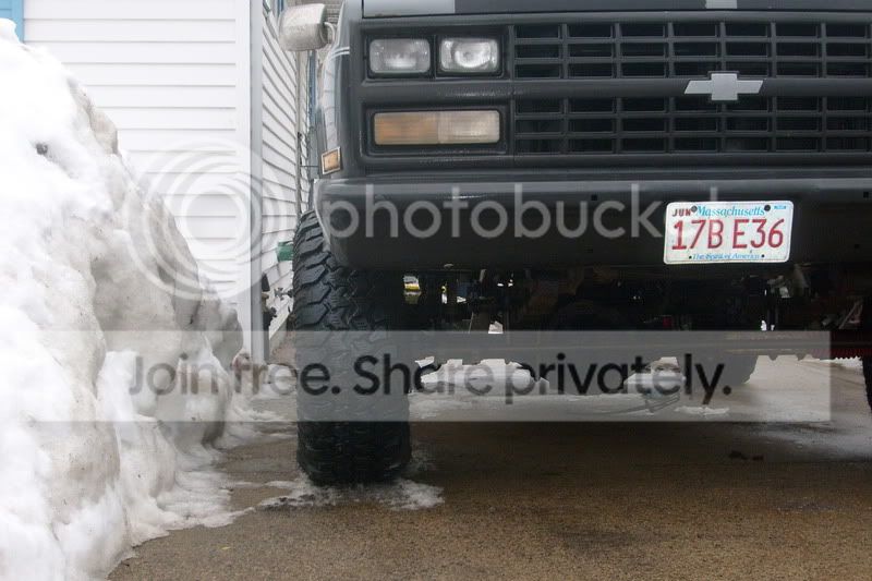

On the ride to my meet and greet yesterday after I finished bleeding my brakes, my buddy that was driving behind me mentioned that it looked like my front tire was point out (positive camber?). I`ve taken some pictures but I`m not sure if they`ll show the issue.
Is there anyway I can check this out, or am I going to have to take it to an alignment shop. My steering wheel is off center, so I will need to go to an alignment shop anyways.
What is that stuff on the passenger side? Its about grill high.........................
If you`re wondering whats hanging down, its my ebrake cable setup that is about half way removed. I stopped halfway through the removal of it, and took these pics:o:D

No I can care less about that. Its that white stuff next to the house. Joke of mine. Its 70 degrees here.:D

It only looks as though the front right tire is tilted out a little bit at the top, so will that still help me?
