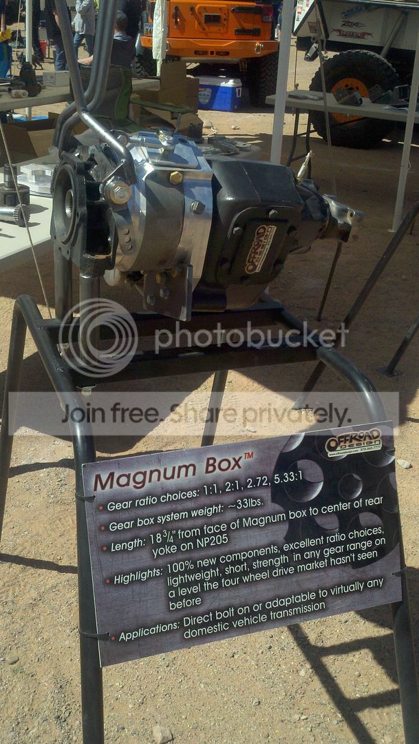

ORD now has a new Style they have made that offers more Gear, is 60lbs lighter and probablly 99% stronger. its called the Magnum Box. call and as about it, Its pretty amazing what they have assembled over there.

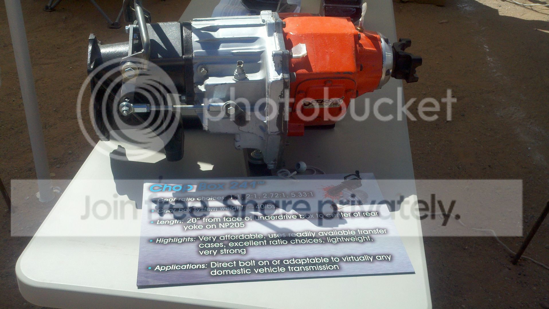

We have the "241 stock rotation to fig8 205 2 inch up rotation" kits are ready to ship right now. Other versions are drawn and design work is finished, it's a matter of getting it all in production. Rotations options are pre-set since the bolt patterns all have to mesh.
any underdrive system using a 32 spline intermediate shaft is not what I would consider a true 4 speed in anything big since the intermediate shaft is always a weak link when the front box is in low and the rear is in high. Not everyone will break it but everyone should know about it.
The Magnum box fixes this problem and gives you a true 4 speed since the shaft between the underdrive gearset and the 205 is now big enough to support the underdrive's torque output. It's also 6.25" long, all new parts, user indexable, 33#, and generally pisses excellence.:pimp:

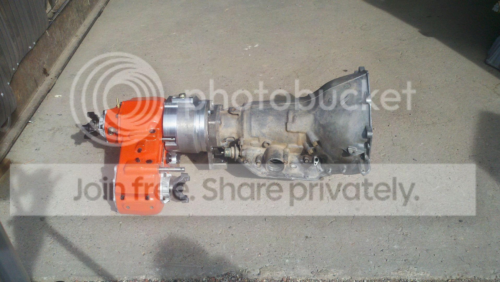

behind a TH350:
pic of the "Chop Box" display from EJS:
