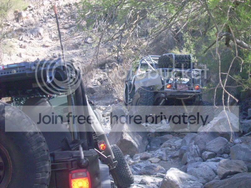

mine front
mine back--cut the floor completly out and just cut the inner quarter panels all the way down 1' rear of the door and a pie shape on top. folded it in welded it shut.

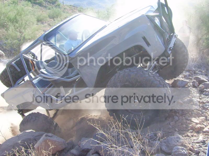

a little less extreme is my friend Zeke's
front
and rear. he completly cut out the wheelwells and cut a pie shape out of each side of the floor, folded in the fenders and welded them shut. to keep the structure in the back he tied the tubes to the fenders.
