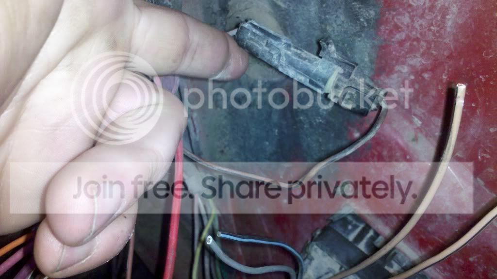

The problem im running into is figuring out where the connector i need to disconnect in order to bypass the advance is...
Manual says its a tan wire with a black stripe thats separate from the 4 wire bulkhead next to the distributor...
Can anyone post a pic of which connector it is or help shed some light on it for me...
Thank you to all who help me in advance
That little black connector to the right of the booster
Exactly what i needed thank you guys so much...
Based on the location description in the haynes manual and the sticker on the core support i was looking like 2 feet away from where it actually is lol
