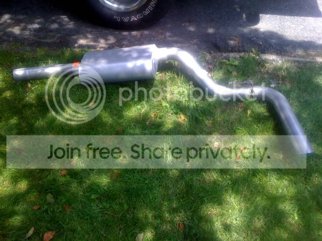

Flowmaster Cat-Back Exhaust kit $209 from Summit Racing
I replaced my roughly 6 year old Flowmaster Cat-Back 3" exhaust setup with a new one today. Comes with a 50 series muffler. Flowmaster guarantees their aluminized setup for 3 years, and after 6 salty winters, mine was showing some rust around the welds. I was getting ready to finally install the high-flow 3" Maganaflow Catalytic converter, so I thought I might as well replace it since I needed to disconnect it anyway... I love this kit, it fits perfect on the stock setup, sounds great, and for $209... how can you go wrong? Both times I have installed this kit, it took me longer to cut the old one off than to install the new flowmaster setup... Easy!!! Flowmaster Part #17161

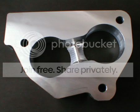

I installed CFM Technologies throttle body spacer kit yesterday. This is one item I thought for sure would be a waste of $83... Was I wrong!!! Holy crap what a difference!!! It took a bit for the ECM to get used to it, but definately a noticable difference in throttle response and low end power. I really had a hard time spending the money on this one, I've read reviews of other spacers and really thought it wouldn't help. What sold me was their design, they've machined the center out to allow the motor to draw incoming air and fuel from both throttle bores instead of just one side. The kit came with all necessary gaskets and longer bolts for mounting the throttle body.
The only difficulty is that I had to bend and move the fuel lines to accommodate the spacer, which caused a rattle and the fuel lines to contact the body of the truck at first, not a big deal, but it took me a bit to figure out. Second problem, it changed the angle of my TV cable for the trans and threw it out of it's proper setting, so it will require you to reset your TV cable so your trans will shift when it's supposed to. Pics to follow, it makes the rest of my engine bay look really ugly... I'm curious to see how it affects my fuel economy, I'm really enjoying romping on this thing now!!!

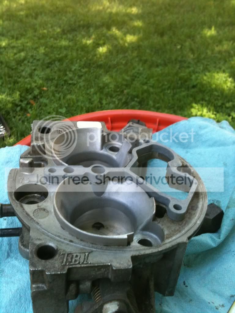

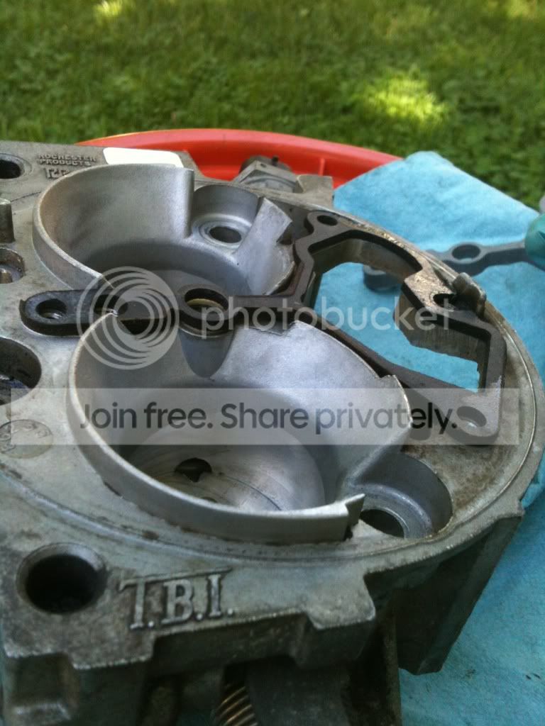

I started by pulling the throttle body off the intake.

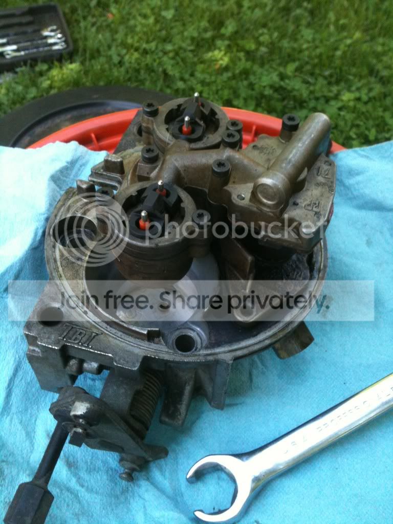

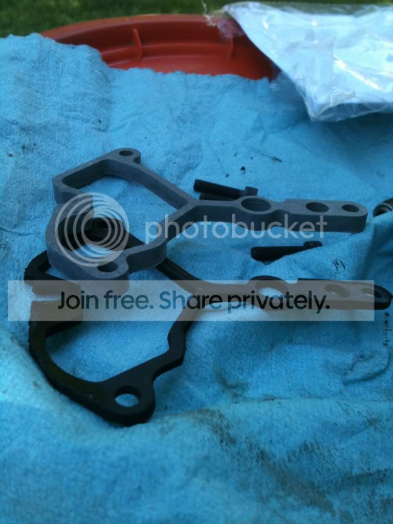

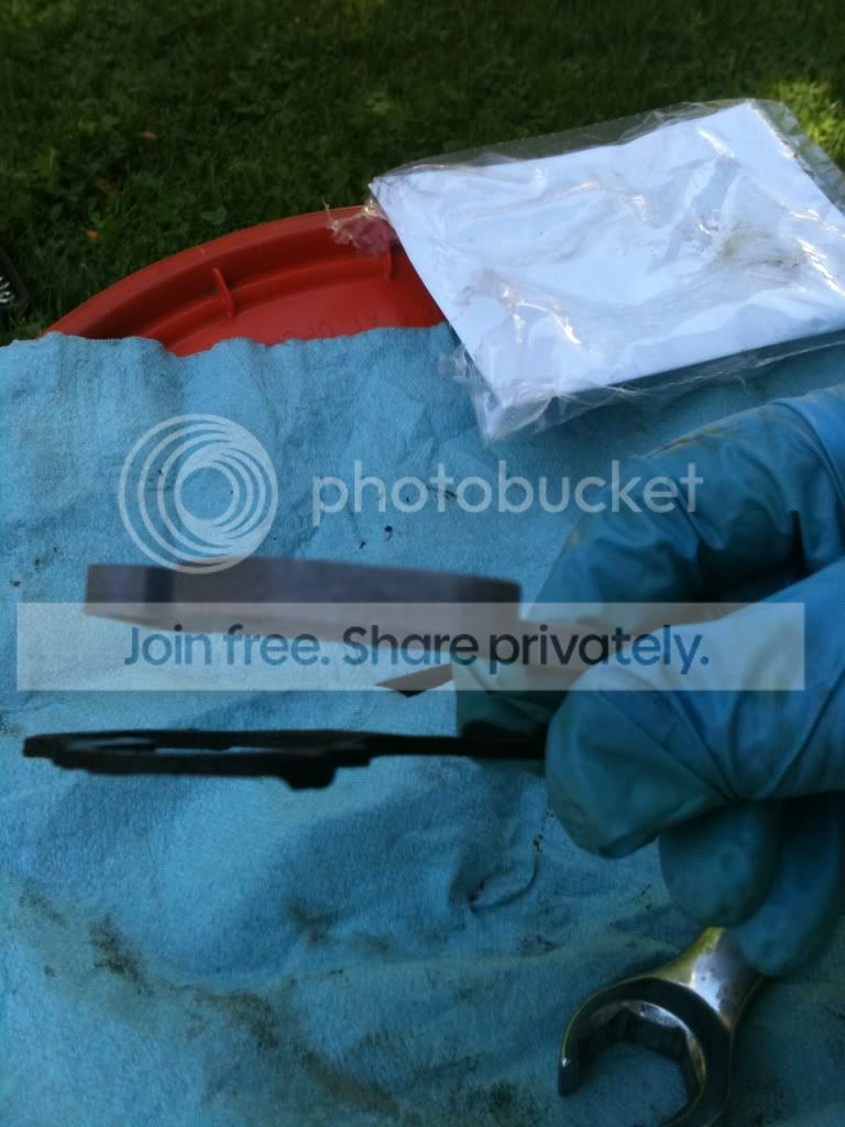

I originally had high hopes of trying each item out individually, but at the rate I'm moving, it'll never get done... To my surprise, my fuel pressure regulator was leaking around the diaphragm gasket. I guess that explains the occasional gas smell I was smelling but could never find! Here's some pics I took along the way to show the difference between the stock gasket and the pod spacer.
Stock gasket:
CFM's Pod Spacer:

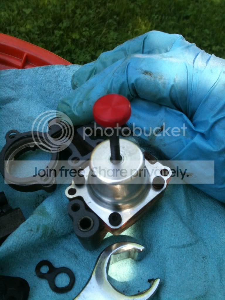

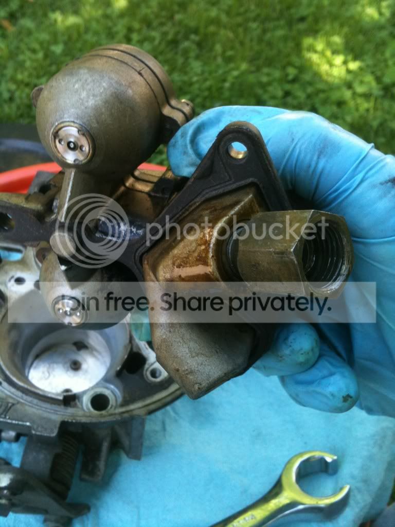

***(5/19/12)***I also finally installed the AFPR (Adjustable Fuel Pressure Regulator).
It was easy, and thankfully my throttle body injector pod assembly already had an access spot for the adjustment knob so I didn't have to drill. You can see where the fuel was seeping down the fuel pressure regulator and down the back of the throttle body, you can also see the thin, stock Pod gasket that I replaced with CFM's Pod Spacer gasket:
It's a real pain to adjust the fuel pressure because you have to be a contortionist to turn the knob after you have the throttle body reinstalled... I ended up setting the fuel pressure to 13psi, it really idles beautifully at 13psi. I took it for a quick spin and it seems to run great, but I haven't driven it enough to see any other improvements yet...
