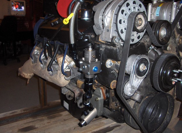

The 2 different variations of fittings that I have found in trucks. One is 1/4" to 1/4" the other is the 1/4" to 1/8"
What was the stock location of the three wire switch/sender on the R/V trucks?
I want to say all the ones I have are 1/4" thread, but I suppose they could have made them in 1/8" too.
I should have clarified....I was talking small block with the fitment issues.

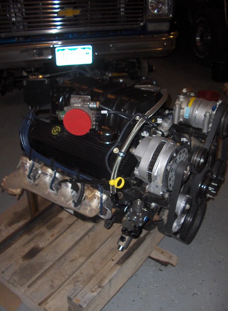

The back of the block by the intake. This is my spare '90 Blazer with the transmission. The transmission is out, which is why it is so light beyond the fitting and sender.
From what I'm reading, I'm thinking I won't bother to install the oil pressure switch at first. I'll see about finding the upright 90° to adapt it to the port at the back of the valley.

what is the brass piece called and where can you get it thats not 65 dollars
Is there something special about the 90* elbow? For my rig I just grabbed a street elbow from the plumbing section of my local hardware store. I know mine is a diesel, but the accessory configuration is closely patterned after the 350. :dunno:
I’ve been running without the switch for almost 10 years. I guess it would be bad to loose the fuel pressure if the truck was in a spot where the engine dying would be dangerous, but it’s been worth the simplicity so far.
