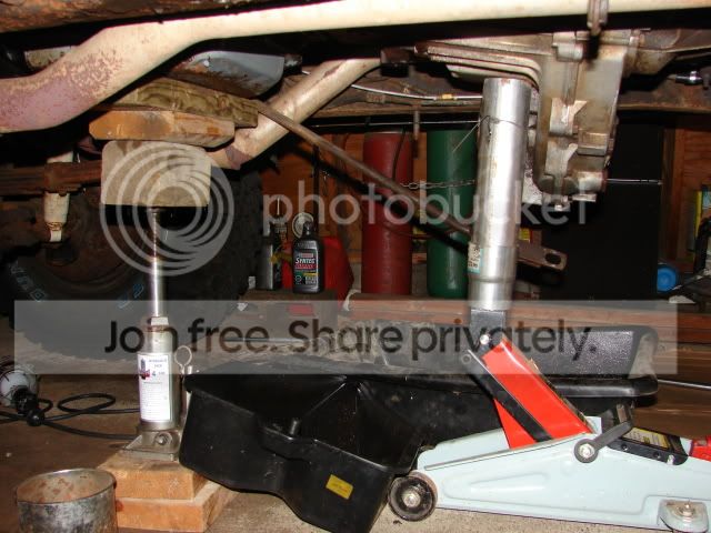

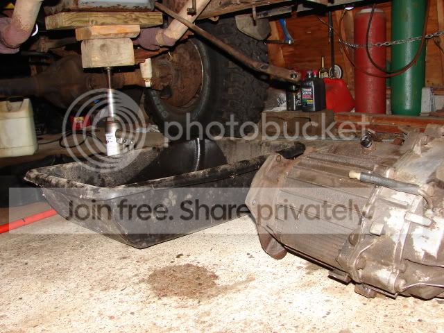

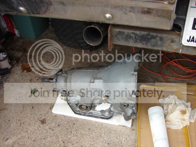

I have a TH350 in my Jimmy. I had to remove it, have it rebuilt and install it. See the pictures below. The RV's tranny looks the same.
