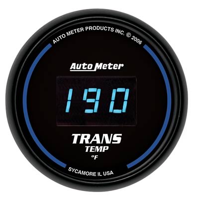

Ok, another $350 goes screaming out of the bank account. Picked up the 400-1-2 kit, the TCI deep pan, a filter kit and this gauge-
http://www.summitracing.com/parts/ATM-6949/
I like the digital gauges over the standard ones, easier to read at a glance.
