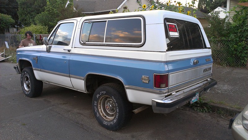

HEre's a pic:
Off topic, but curious...What's up with the fenderwell exhaust on that blue truck? Seems like a weird method to have it dump in a stockish location.
I have run a few systems with the tailpipes done that way, including the current system on my Blazer. It solves a bunch of room problems around the shackle/spring area and gets the pipes up high out of harms way.

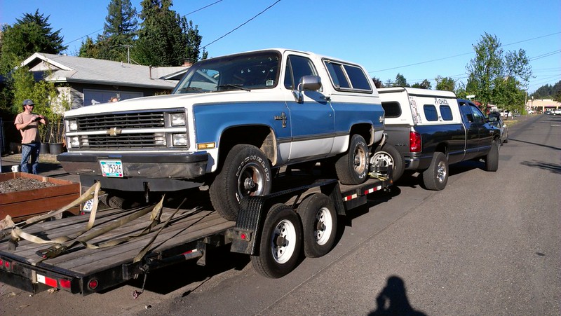

Well, we are on our way!

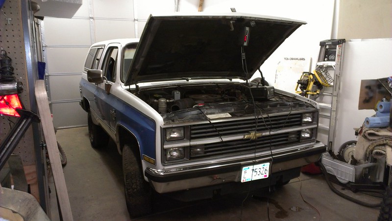

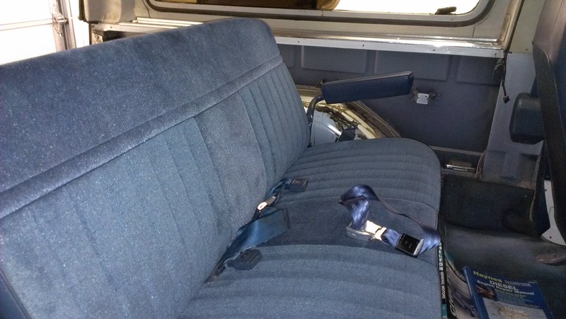

Picked up the 1984 Diesel K5 with a bad engine, but pretty clean otherwise. It had a repaint sometime in the 2000's. I gave it a quick bath and am charging the batteries, but it needs new ones. All the electronics work, which is great.
I'm going to try to start this engine to hear the 'bad noise' first had, and I'll shoot video of it so you all can give me your guesses.

Budget: $1060 + $950 for Boggers = $2010
1984 Diesel Base Truck: $1000
Remaining Budget: $1010.
Pics!

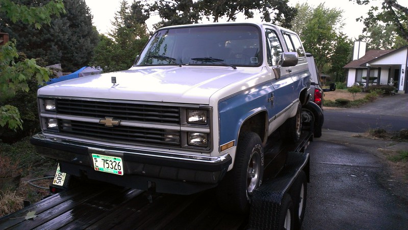

Loaded up:
Washed:
GEtting charged. All the windows work, albeit slowly with the low batteries, even the rear one.

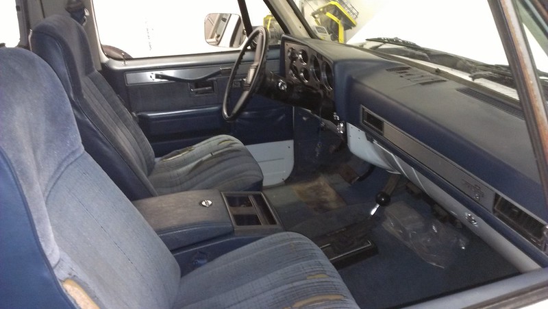

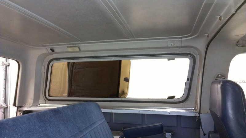

Pretty clean:

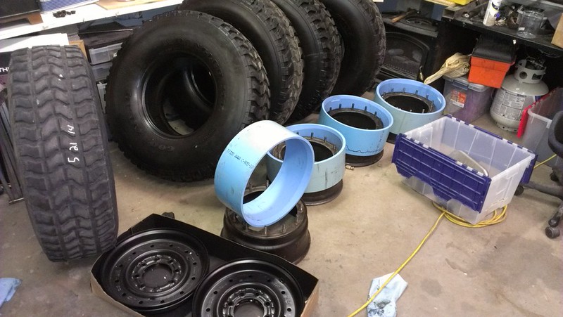

Gotta build these now that I have all the parts:
What happened to the tall one with 60/14?
Also, I've got the 20g airsoft BBs in my tires too. Running 2,500 each tire, cause I buy the 10k count bucket. Works out to about 1lb each. Lol

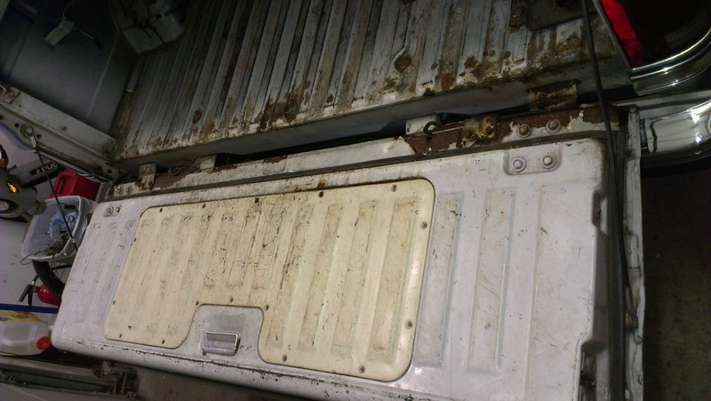

Besides the tailgate area that thing looks like it's in really good shape. Nice score!
Yeah, I've been crawling all over it, and I'm hapy with it's condition. I'll fix the tailgate issues at some point.

Looks like I have to pick up some batteries. The ones in it are 2003, and they charge enough to power the lights, but it wont even think about turning over.

So, I went to Costco and bought 2 new Interstate batteries. (They have changed to Interstate from Kirkland) Group 78's were $83 each with a 42 month free replacement warranty.
I installed them. The electronics all come one, the manual Glow plug button works, but when I turn the key nothing happens. No starter. Not even a click. I tapped it with a hammer. Nothing.

Ok, I figured out the cranking issue. This truck has a little security card under the steering column that kills the ignition if removed. It wasnt in right. Now it starts fine...
Except for the END-OF-DAYS noise it makes when started. CROUNCH CROUNCH CROUNCH! Metal on metal badness. Here's a video, but it doesnt pick up the sound perfectly.
https://www.flickr.com/photos/rbgerrish/15241571011/
PO thought main bearing(s). Thoughts?
