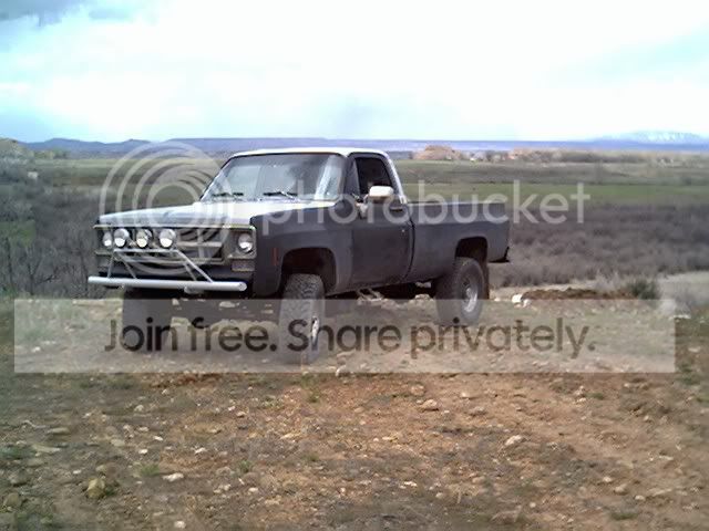

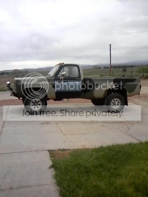

The pics have been posted a million times but, this is its build thread so its only fitting I post both its first pic and the last pic I have took of it.
Ok this pic is pretty much what it looked like when I got it. With the exception of the front bumper and KC lights.

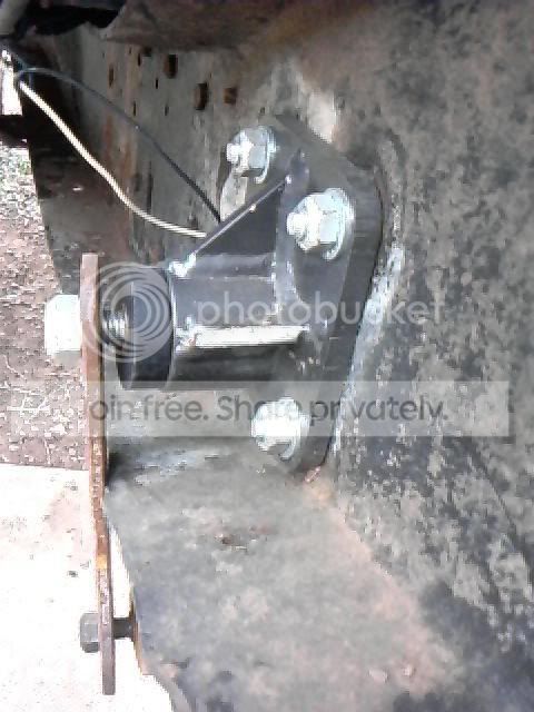

I built the front bumper using 3" drill pipe and a solid dumb bell bar. I had to notch it and heat it bright red and push againstr my ford 655 back hoe to get the 3" to bend. This thing is beef! For those of you who dont know drill pipe turns and the friction causes it to become magnetic. To overcome this and weld solid to it you have to put 5 or 6 wraps of your welding cable around it. OK OK enough pattin myself on the back over the bumper. I actually dont like it anymore and will probably go into the for sale section or the scrap pile. :haha:

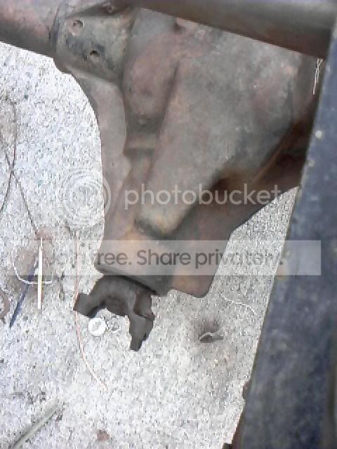

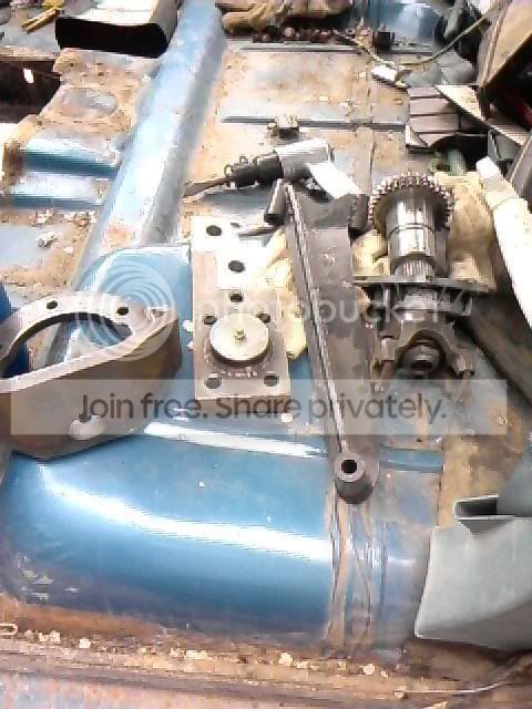

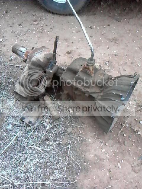

I will also clean and repair the 465/205 that came from my 85 K5 the transfer case will get a fixed rear yoke and the 465 has the notorious problem of popping out of 3rd gear.
Once I get EVERYTHING ready I will swap it all over. The truck has a 4" lift and 315x75x16s I will add Kerts eazy inch and extend the wheel base 2". 1" forward on the front axle and 1" back on the rear axle. I think this will center the tires a little better.

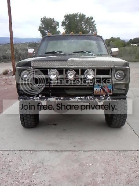

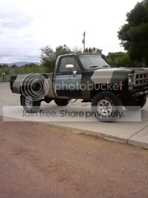

Heres how it looks now.

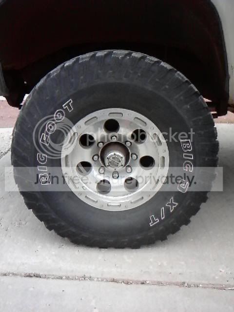

It has some wheels and tires that I actually put on before I traded it to my dad.

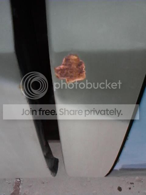

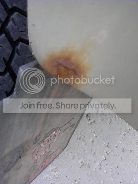

Heres all the rust. You will see some bondo that wasnt sanded down, this is mostly tiny dents or dings.

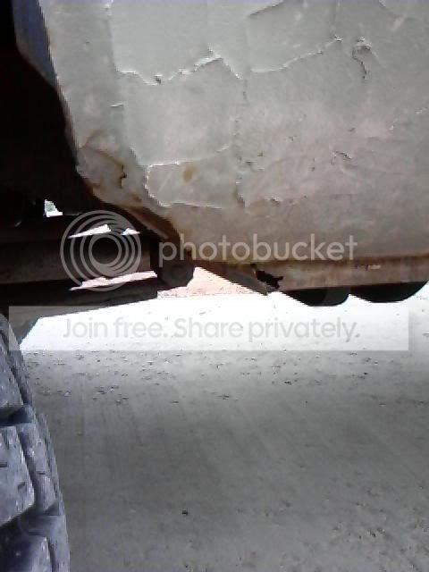

This is the left front fender it has about 15 tiny rust holes under that unsanded bondo. I will replace this fender eventually.

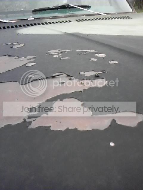

paint is pealing in some spots.

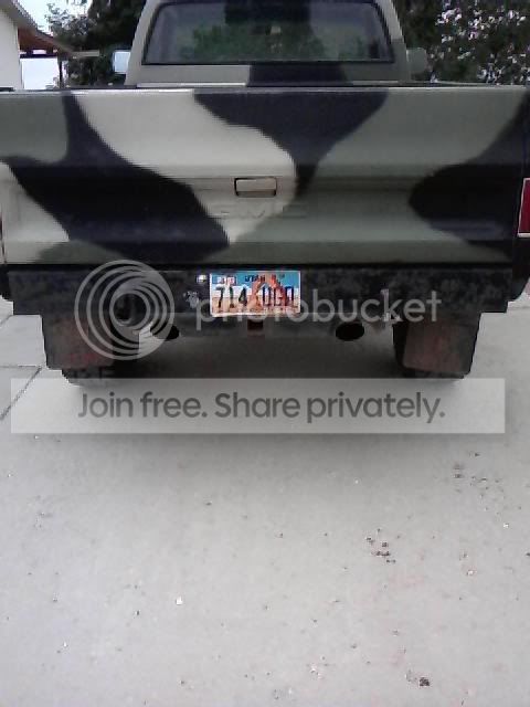

The rear bumper I never finished.

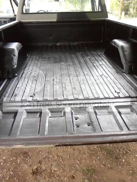

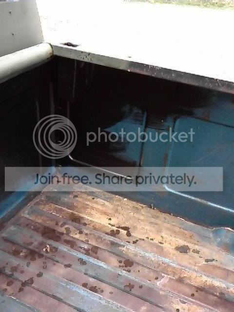

And finally what I did today, it was a lot of work. I scuffed it then cleaned it with acetone let that dry hit the rust with napa brand rust converter then used 1 gal of dupicolor bed liner. It was barely enough to get everything coated there are some thin area and I have 2 small spots that it wouldnt stick to. I will have to hit them with the wire wheel and recoat the floor with a second gallon next pay day.
not many pics but I did get one while I was doing the sides. I did the sides and corners with a brush first. Then the texture roller, then moved onto the floor.
And finished

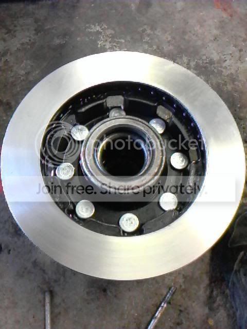

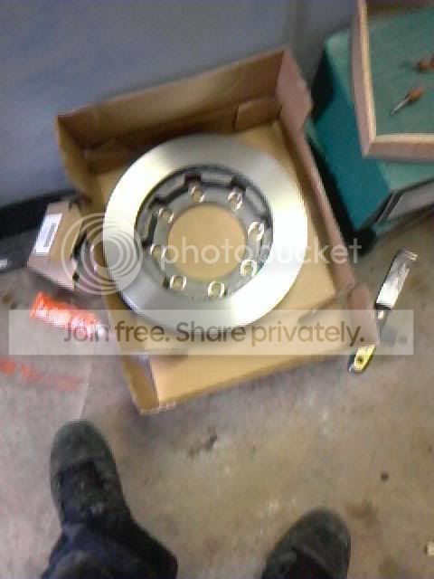

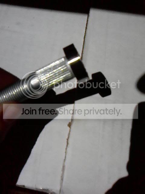

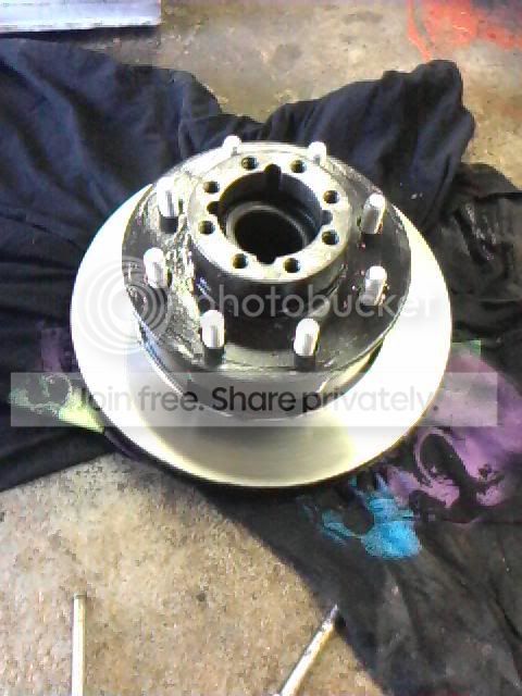

OK so as was warned by others the head of the wheel studs for the 14B did not fit into the rotor recess. BUMMER
However, one of my best friends was a machinist in the Navy and has a cute little bench top lathe/mill thing. He swung by today, while I was at work, and grabbed a rotor and the box of studs. It was about 3pm when he called me and asked where they was, by 5pm he sent me a text saying he had them done.
SWEET I love free stuff!
Naw Ill buy him a beer...........
Baby steps baby steps. But as my Dad says any forward progress is good.
Bad pic and not so exciting but heres the machined wheel studs. I cant remember what the measurment he said but its a slight resistance fit meaning its almost a pressed fit. and yes its almost a mirror finish on them. Oh and I called the 2 local machine shops and told them what I needed one quoted me $160 the other....... a WOPPING $250 are machine shops just flat out LOONY everywhere or just here where the oilfield pays big money?

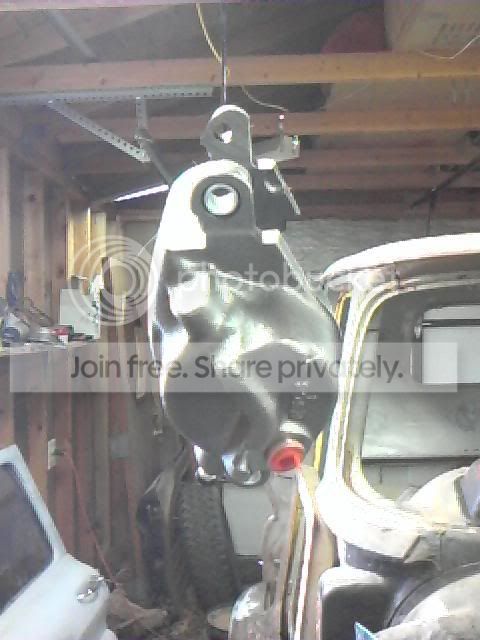

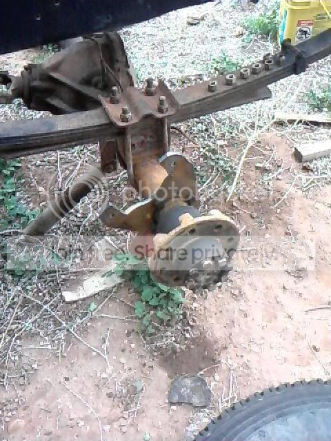

I took1 hub off the crew cab and applied a generous coat of grease to the spindle and just inside the axle to protect it from rust. I wont be using that axle as it has the narrow spring perches but the hubs where already stripped down. I will use the matching axle that was used in the K5 when it went to 1 ton. The 85 k30 pickup had narrow perches and a gov bomb that had seen better days I swapped it for a 3/4 ton 14B, with matching gears and open diff years ago.

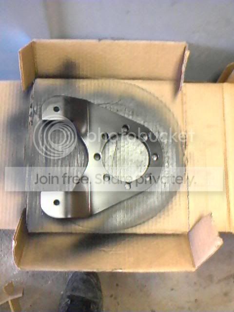

I bought some sand paper and a can of high heat black paint. I then got 1 hub rotor brake bracket and caliper cleaned up and painted. The caliper and rotor are new I bought them last pay check. Once the paint dried I put the hubs rotors and wheel studs together. Next pay day I will buy new bearings and races. The old ones look fine but I figure I might as well go new since its a slow project anyway.
I didnt get progress pics as there where boring, but heres the finished product. All cleaned painted and assembled.

As to the truck, the pictures don't do it justice, it looks much better in person (at least from 20' away:grin:)

What is the deal with the 14BFF studs? Mine fit fine.
I run 4.88's with 37's, borrow a set of 40'" Boggers for the trail. I'm very happy with my set up. I'm running a 465/205. Even on the highway it isn't too bad. I can keep pace with traffic and pass if I have to.
Apperantly some rotors are made with smaller recess' and it was just my luck to get them.
Its ok though my friend saved me and left a slight resistance fit. It worked out great.
