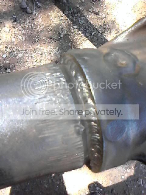

Got my 14B tubes welded to the center section...........

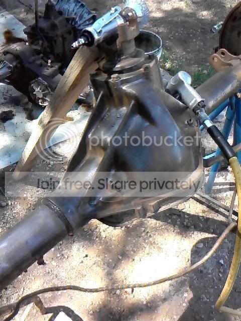

Got the trans and transfer case moved so I can work on it. Years and years and years of grease and crud. Its stuck on there like concrete. My pressure washer hardly did anything to remove it. I sprayed some diesel on it and hope that will soften the crap up so I can clean them. I was literally chiping it off with a welders slag hammer. I got hot and sweat rolled into my eye. DAMN THAT STINGS!
In the morning I will start tearing the 14B down and get it ready to paint.
Something tells me the wire brush and I are gunna be real close friends after tomorrow. I should have both rotor/hubs ready to put back on it by afternoon.

SO today I have been cleaning and wire brushing and cleaning some more. The area I am working in has shade most of the day but full sun durring the hottest part of the day.
Anyway not much progress to speak of but I did find something rather disturbing. After soaking with diesel the crud all over the trans and x-case softened up enough to get it off. Under all that crap i found the top 3 bolts from the adapter to the x-case where not even close to tight. they was backed out about a 1/8 inch gap. I used to wheel the blazer pretty dang hard and it held up with the remaing bolts. Im glad I decided to clean them up this time around though.
Wire brush cone, cup, and wheel in a die grinder and a 14b have been most of my day. I am dirty! but most of it is cleaning up nice and will get some paint this evening when I get my shade back.

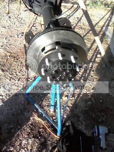

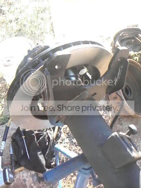

OK so I got most the housing cleaned up and painted. got the hub/rotor that I already had ready and put new bearings in it with a light coat of grease. (14B hubs are lubed from the 90wt gear oil no need to pack the bearings.) new seal and got it and the caliper braket installed. The calipers will be pointed forward about the same as front rotors tilt rearward. I got the other hub and started cleaning it until I realized that having loose parts from the brakes inside there had chewed up the hub. Particualrly the shoulder near the seal. Looking at it it had wore into the seal its self and is tapered off. So I will use one of the other hubs. The seal would still work in this hub but I would rather have the full shoulder.
wire brushing away the rust
One side almost complete.
weld
good looking truck and im glad to see somebody else is doing a 77 pickup. is the cam a melling cam or millings? reason i ask is ive never heard of millings and i might look into that cam depending on what the powerband (basic operating RPM range) of it is. what wire did you use when you welded the tubes to the housing? i might end up doing this to mine if my lincoln 110 is enough to complete the job.

I didnt use wire, 7018 rod.
Just an arc weld with 7018 rod using my diesel lincon 300. I just found the best looking spot to take a pic of is all that is HAHAHA. But thanks.
I had a bunch of grease melt out while heating the center section. had to keep it hot and wire wheel if a lot until the grease stopped seaping out. Then I just lt it air cool no insulation or anything.

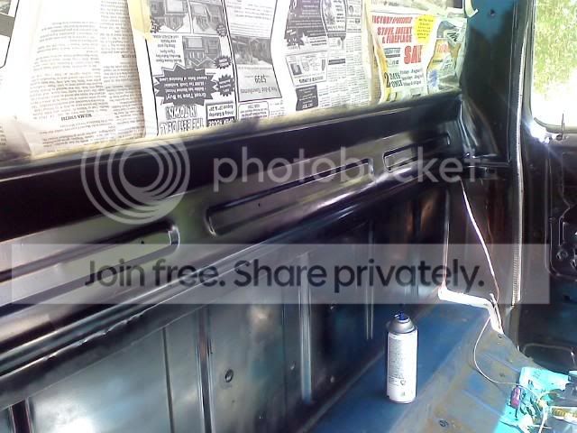

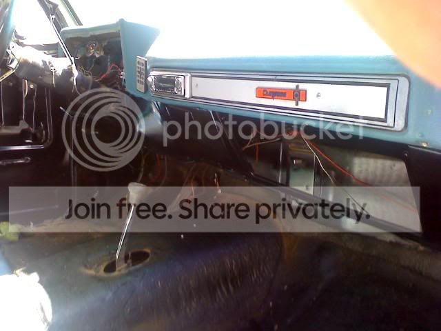

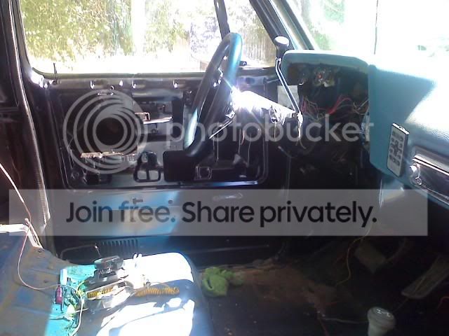

I am currently changing all the interior to black I have the interior basically gutted and all the metal that will show is painted black. I have painted all the a pillar, b pillar, and crown trim as well as the kick pannels. I havent decided if I am going to smooth the dash of just epoxy the cracks, sand and paint. I will be buying a head liner, door panels, lower door carpet, and floor carpet all in black. I want to do a roll on bed liner in the cab that way I can kill any surface rust that may be under the pad right now and hopfully prevent future rust. Then new pad and carpet over that. I will also buy some automotive carpet and cover the back cab wall.

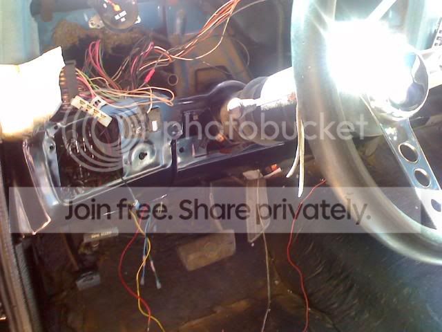

I am also waiting for some of the stuff I have ordered for the wiring project. That is a bit overwhelming but once I get the stuff I can start on that. I have several mods Id like to do while Im at it such as headlight relays. I have been writing a lot of notes and planing it out the way I want it, and just basically trying to convince myself it wont be that bad.:haha:

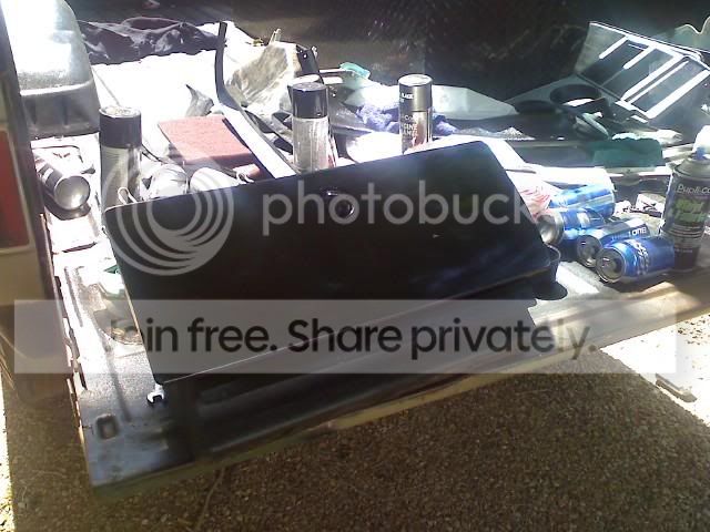

Heres some interior pics everything used to be blue there was no black before. Most of the blue you can still see will not be seen being covered by trim parts. I scrubbed everything with a scotch bright type pad untilit was dull finish, then cleaned it with acetone before painting it. Just using rustoleum rattle cans. I think that should hold up on the interior, if not it will be easy to touch up.
This is the glove box out of the red 83 truck the blue one in this truck had a broken hinge.

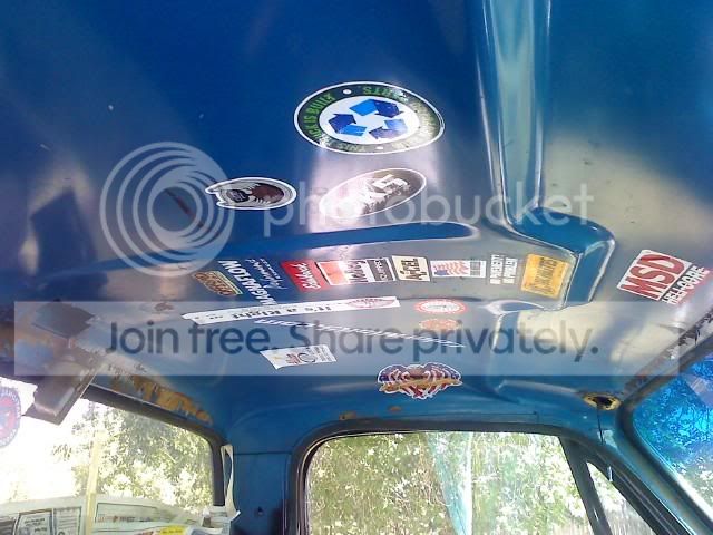

Sadly the stickers will all be covered by a headliner.
still need to pulll up the old pad/insulation and bed line the floor with herc or duplicolor bed liner
I havent decided weather to smooth the dash pad with fiberglass resin or just epoxy the cracks sand and paint.
I will put automotive carpet up to where the cab bulges out with a piece of wood trim at the top also painted black.
