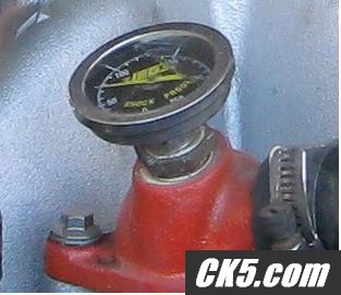

Hey man, where did you get that little gauge on your thermostat housing? Your engine bay looks pretty clean.:waytogo: Do you have your wheel wells removed?
I got the gauge at Jegs.http://www.jegs.com/webapp/wcs/stores/servlet/product_10001_10002_750805_-1_10339 I used a thermostat housing the takes a ½" pipe fitting and used 1/2" to 3/8" reducer to fit the gauge. If I used a housing that the gauge would screw in, the probe would the thermostat. The reducer spaced it out enough to clear.

Ok, I tried to put my water temp sensor in there and ran into that same problem. So I put it into the manifold. It would be nice to be able to work on the truck and know what the temp was without having to go back to the insice of the cable. Cool I"ll check it out.

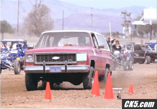

Too bad it is going in this ugly POS.
I don't see an ugly truck in this picture (?) :dunno:
The only problem with the guage being mounted there is that it's on the wrong side of the thermostat to read correctly. It needs to be in the manifold in order to read the correct temp as that's where the HOT water is.
Yeah, I've thought of that. I'm hoping the bleed hole would let enough warm coolant to get an acute reading. So far it seems to work okay. It slowly rises to temperature as the motor warms up. It doesn't jump when the thermostat opens. It does not get the same reading as my in-cab gage, but it is not a big difference to cause me to worry.
For me it worked okay, but I could see where it wouldn’t work as planned.
Oh, I didn't see Craig’s and thealien's posts.

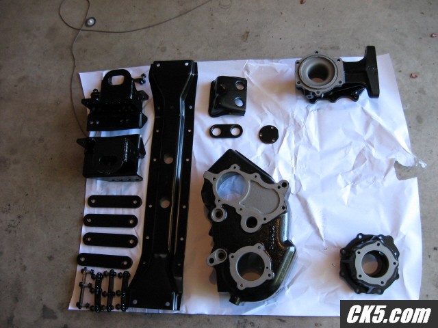

thealien-It cost me $200 to get all that coated. What is not shown is the factory rear and PTO covers which is also coated. I'm not going to use those pieces because I got a NWFab billet kit.
Craig-I like the looks of the second generation blazers also which is why I own one, but this blazer has a cheap peeling and fading red paint job. If the blazer had an immaculate rust color (name of the paint, not the rot), I’ll be in heaven.
