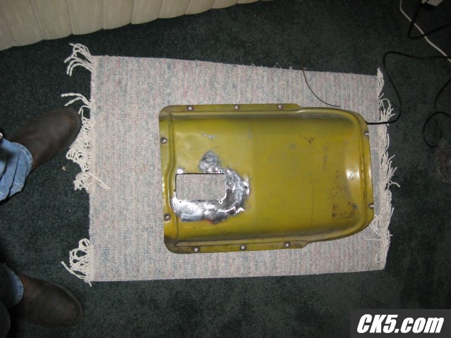

Well, I haven’t gotten much done lately even though I had the nothing to do the last couple of days. But, I had modified my transmission tunnel and installed my HAD driveline which I had since September.
This bad boy has 1350 u-joints all the way though so I could transfer all of my big block destructive power to the Dana 44 for spectacular carnage.

Oh yeah, I mounted my Art Carr shifter.
