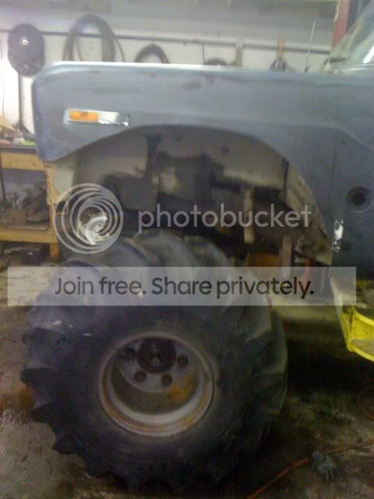

front ride height set.theres about 8" to the oil pan.i will bump stop it at 2" from the oilpan.once i put a 454 in it i will be able to lower it a few inches and still have clearance.the international engine is a front sump.
