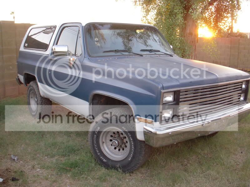

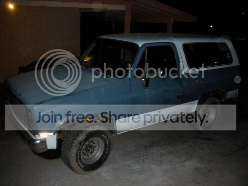

so today i was bored and called on a blazer.. I was really only looking for a rust free tub to use on a project or for my friends son ryan.. well blazer is cleaner than I thought. I called on it, settled on a price for a non runnng blazer with a "motor issue"..so I get ready to go snatch it with a trailer and the guy calls me and says he deliver it..:eek1::laugh: he lives a good 20 miles away so I accepted..now you should have seen the look on my face when he showed up and was driving it:eek1:
im not sure where im going with this, might cut the top and replicate the old 75 or my green 86 and herc the floor, build a cage and some 3/4 ton axles, cross over and 38's..
or ???????????????
hmmmmmmmmmm

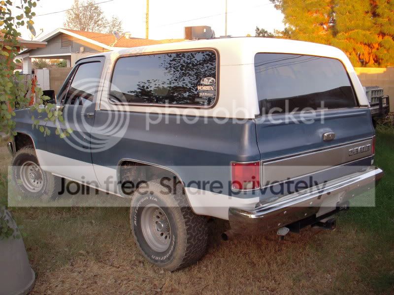

305, 700r4, 208 10 bolts, working ac, nice interior, newer carpet...clean rust free body,! ill poat some better pics, hell even has tinted windows, im really up in the air on what to do with it or which way to go with the build.The nice thing is the body is straight enough that i could scuff and and shoot it tomorrow:D

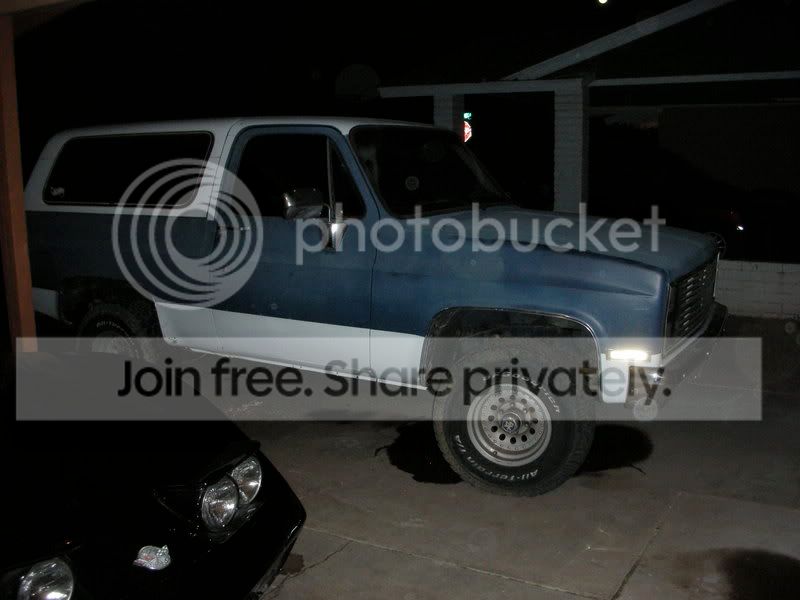

Got some better pics, looks like next week the 305 is coming out and the 350 will go in. Also came across some 6 inch front and rear springs. I hope this thing rides decent.
Looks like this blazer will get used for that kid ryan I talked about in my last thread, I dont know if I am going to give it to him or make him pay me for it yet. He is a real good kid but I want him to have some pride in the fact that he helped build it and payed something for it. He starts driving around june should he keep the parental happy. I talked with him and came up with some ideas. He still wants to do the bright green color I painted my last blazer, but he likes the way they look with the half cab and no doors or tube doors. Lucky for me cause that is alot of work saved:D So i think im going to get him over here and start gutting the interior and teach him how to sand and prep for the paint job.
