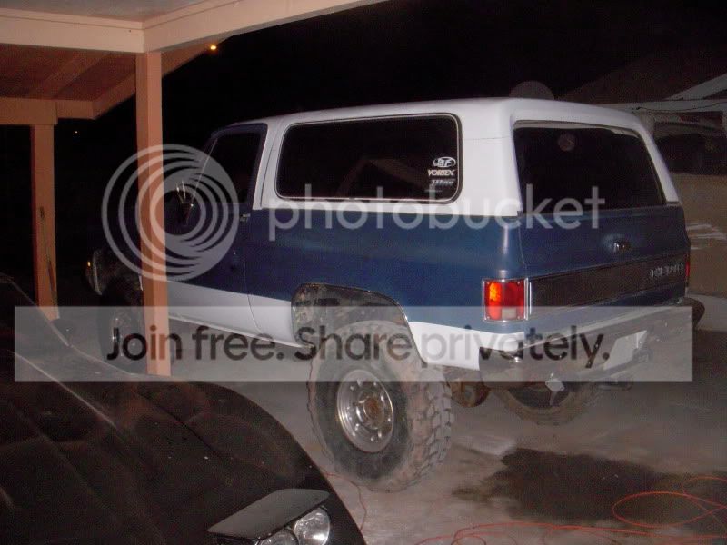

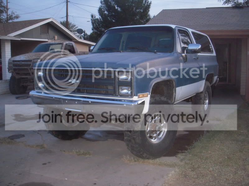

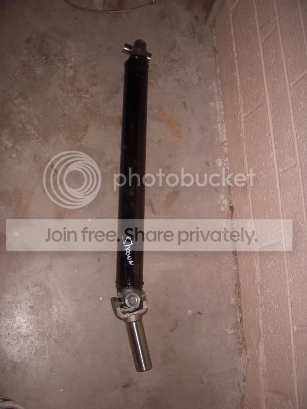

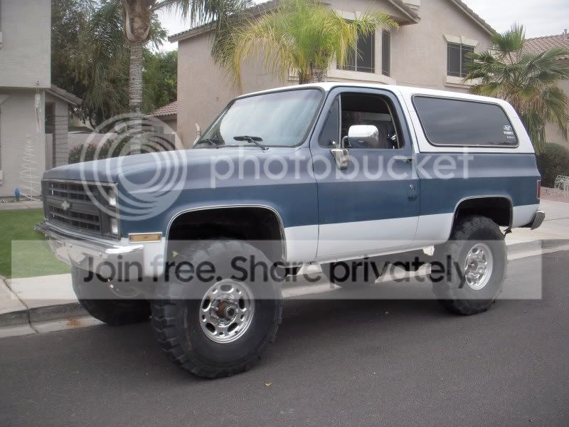

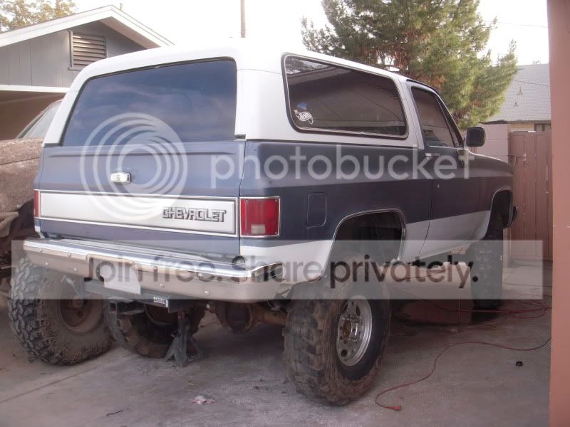

today dropped off the driveline to my d-shaft guy..45 minutes later i get a call saying its done!

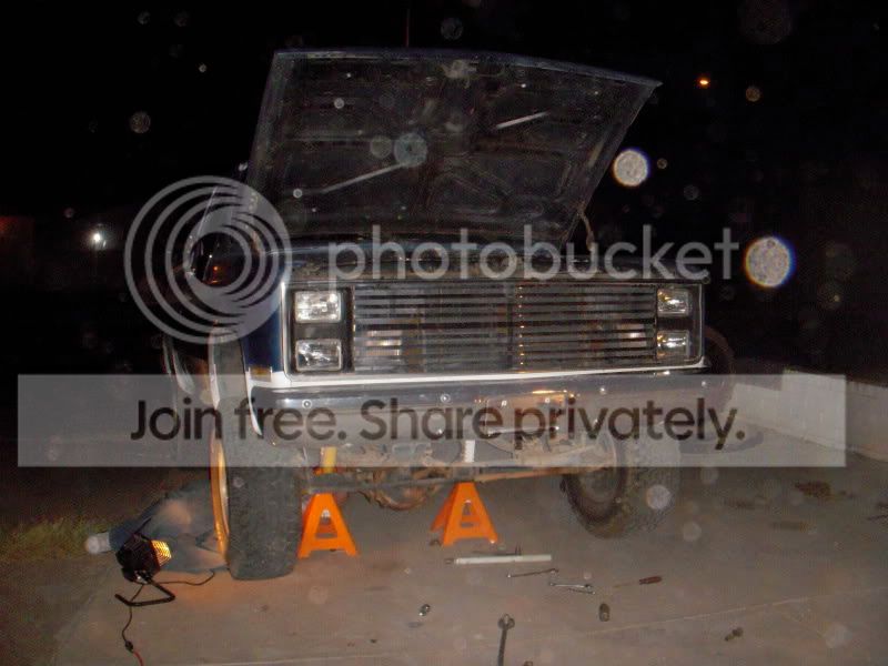

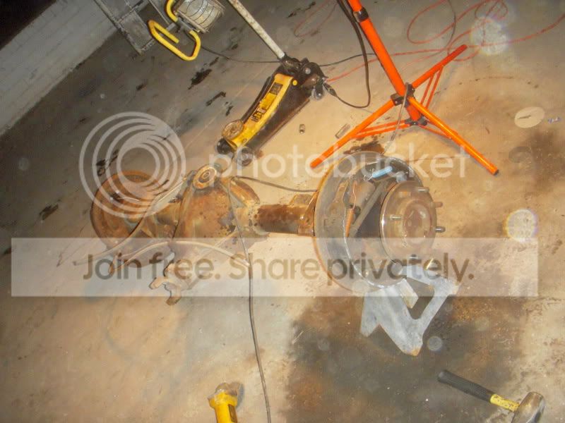

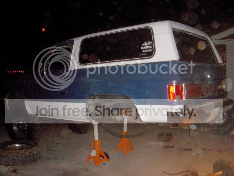

Tonight we yanked out the rear, removed perched, reinstalled, tacked perches, pulled, finish welded. Installed the driveline, tracked down the right bango bolts, bleed brakes. Installed stock steering arm back on and used the new superlift draglink.

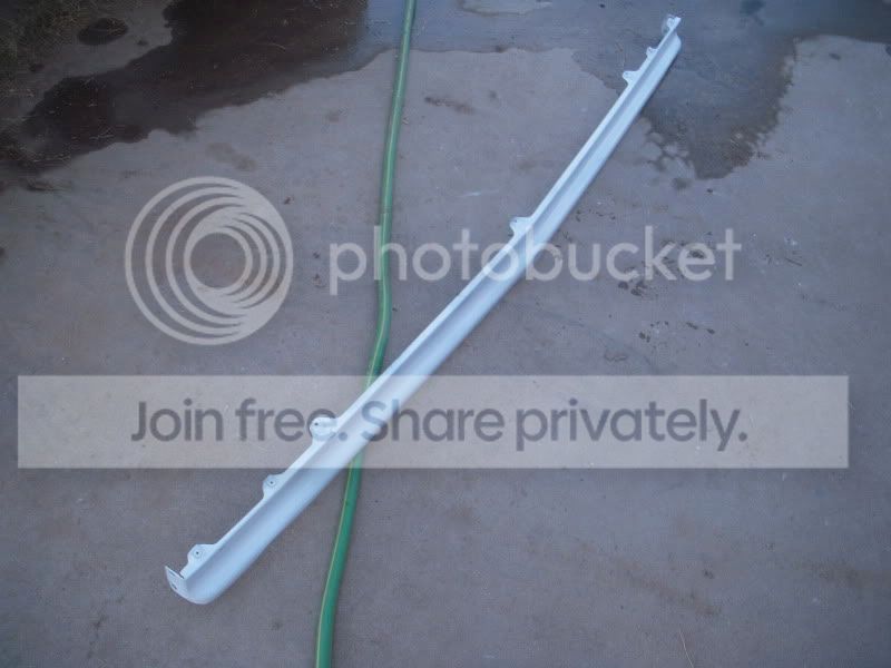

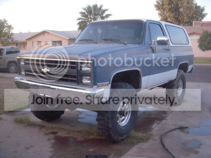

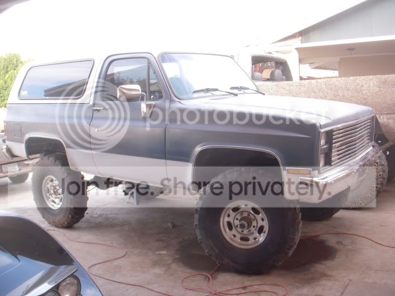

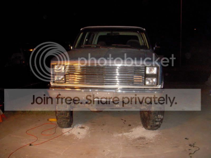

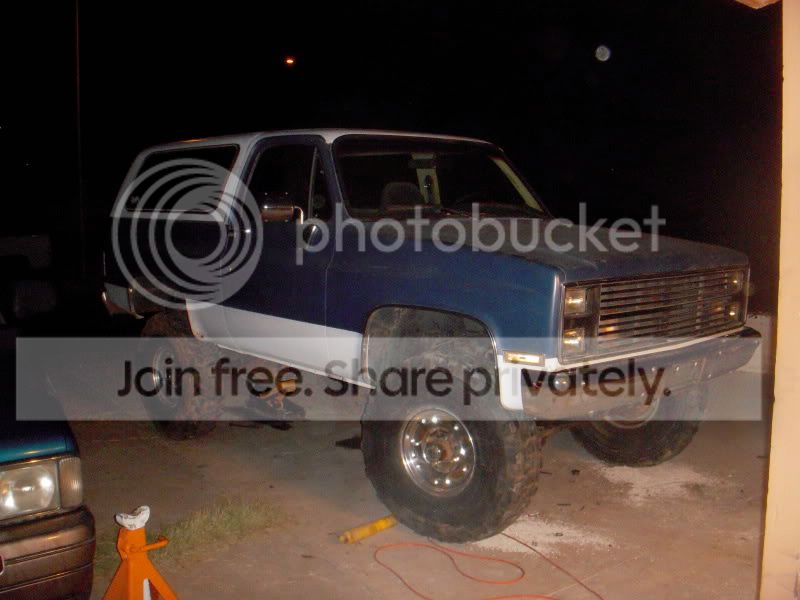

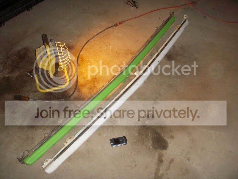

Now im working on putting the restored grill from my old blazer on it and removing the chrome grill. I ran into a problem though as gm changed the lower valence and I have to use one from the old blazer. So tomorrow ill shoot the valence white and be in business.

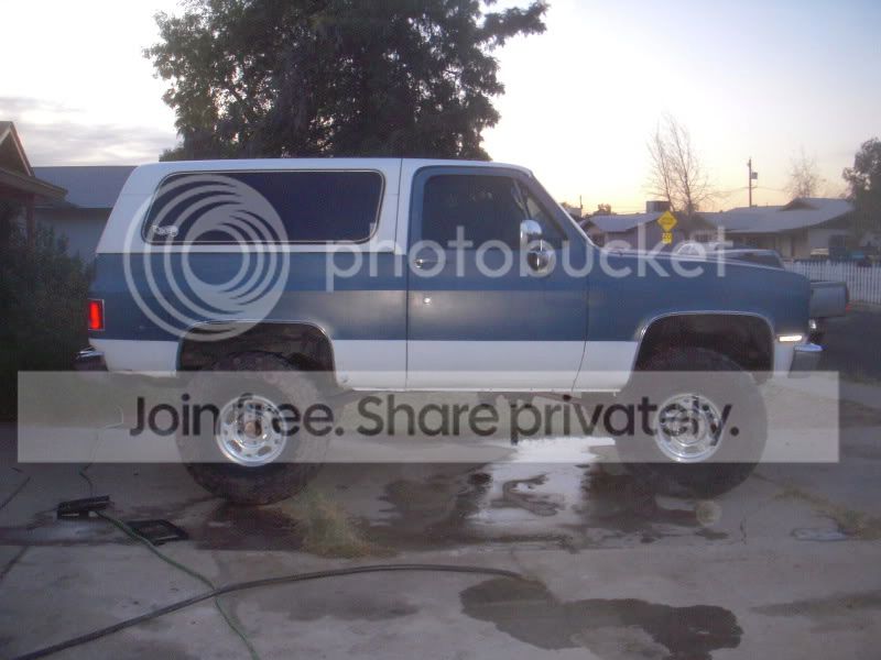

left to do is the exhaust install, change fluids and a new set of military tires, i also still have my old rear driveline I will build a spare out of. Other odd balls such as sliders, roll bar, paint and misc are on the brain.
