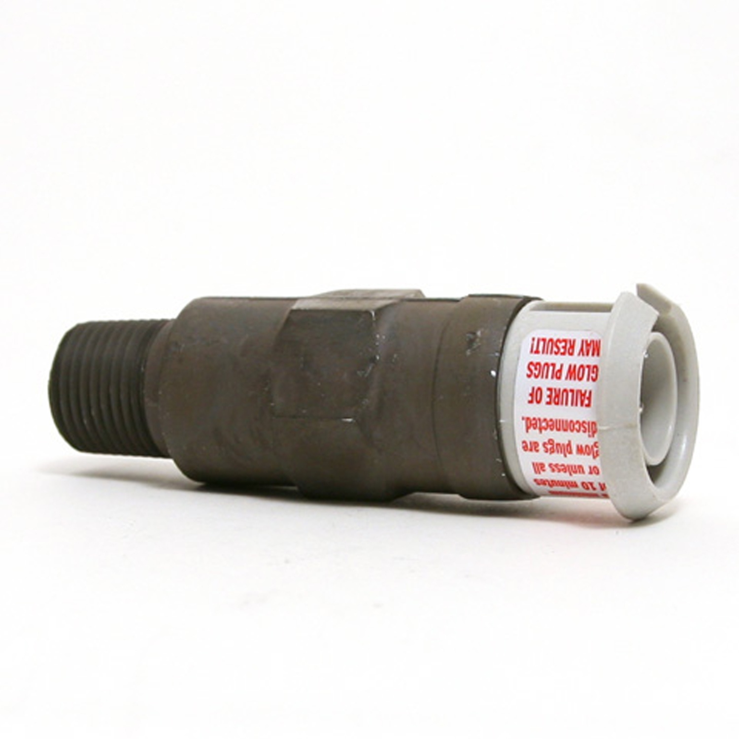

Ok. There are multiple styles of GP controller. But the usual squarebody one involves this temperature probe:
It plugs into the water jacket port just aft of the last intake port on the driver-side cylinder head.
Crummy internet picture (turn head sideways):

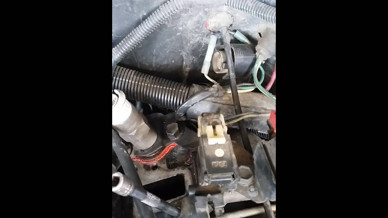

Perhaps this provides a better view ...
Oh! Yeah, that's a blockoff plate where that stock probe would have gone. I just saw the empty hole and wondered if you were going to have a waterfall when you started up with your new GP system.
This is only for up to 83.
After that it was a different style and shape.
I will take a picture of it tonight

Yet another non-stock thing about this engine bay. What style of controller did you have before you wired the new solenoid?
Not certain, but I still have it and will post a pic of it after dinner. It was easy to remove. Just unbolted it and rerouted the positive and negative cables.
Your setup is a flat piece with 4 I think connections.
Interesting. I thought the switching date was later. My '84 rig came with the large (separate) temperature probe and the solenoid mounted to the inner fender. It looked like factory wiring, but who knows? :dunno:
The CUCV had its own system with a much smaller probe in the head port, and the solenoid mounted to the firewall.
