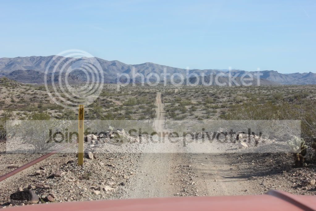

This is the pipeline road heading out of Swansea. Lots and lots of uphill and downhill: (That first little "dip" in the road is actually hiding a Suburban)

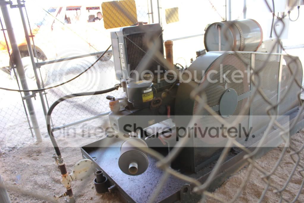

This is an engine-in-a-shack that I was checking out near the bridge. It is an Arrow engine which are designed for 100% duty cycle, 24/7/365. It looks very similar to an old hit and miss agricultural engine:

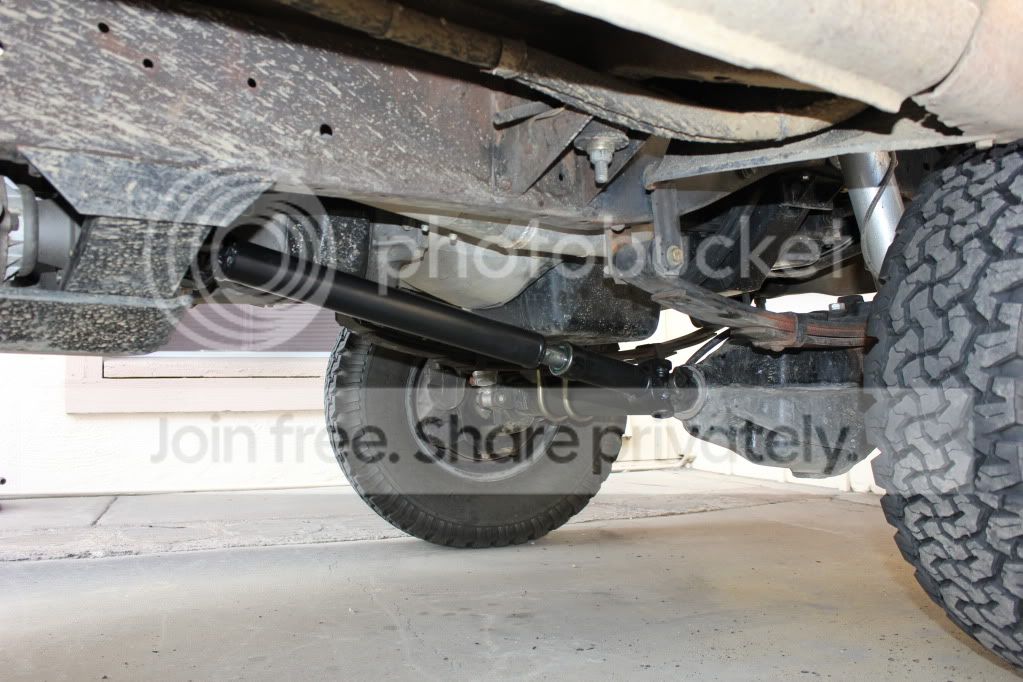

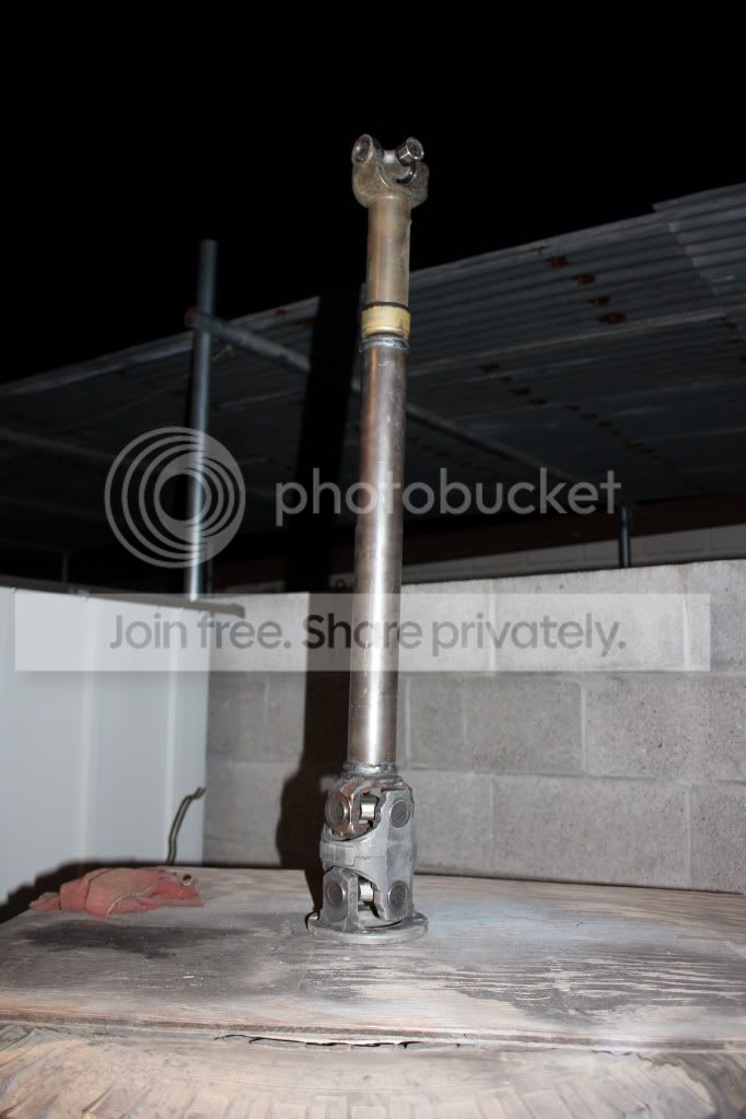

I wanted the front shaft because it was a Saginaw CV shaft. I have a Spicer CV shaft with a Saginaw adapter ring on it. The Saginaw is much stronger than a Spicer joint and figuring that I have it bolted to a flange on a 32 spline front output on the '205, I figured I should have a better double cardan joint on ther too. I had the shaft re-tubed and brought it home and washed it before painting it.
I have a feeling this shaft had been gone through not too long ago as the cv was real tight as were the splines on the slip yoke. This was a good thing as both of those parts on my old shaft were showing signs of wear. I painted it up and threw it in:

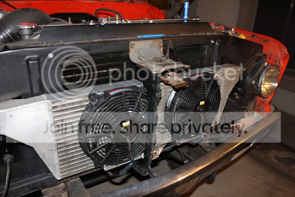

Some of you may remember that the smoke got released from one of my auxilliary electric fans awhile back. That left me with one functioning fan which is fine for cool temps, but Summer will come eventually and a second fan will be a good thing.

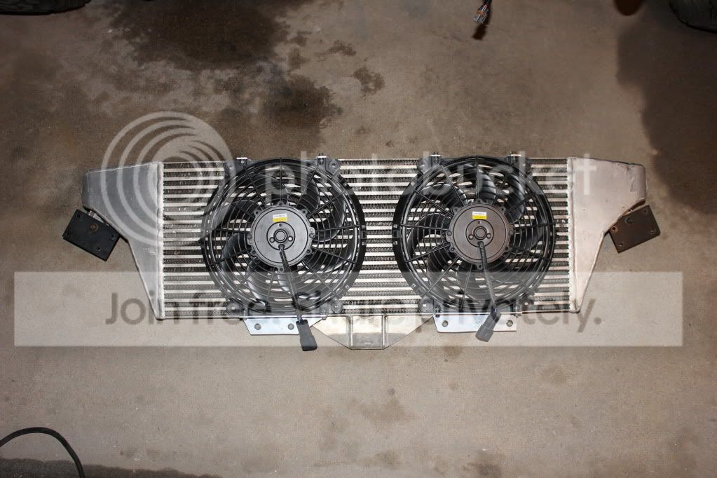

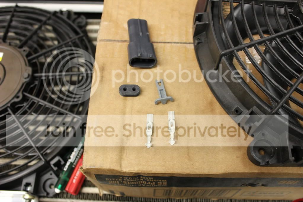

Before I installed them I installed the same factory fan connectors and terminals that I had onthe old fans so they can be easily disconnected and swapped out if necessary.
I decided that I needed a different mounting configuration than I had so the next time a fan fails, I don't have to tear the front of the truck off to change it. I came up with a hard mount on the top and a couple pieces of aluminum angle on the bottom--one welded to the bottom of the intercooler and one bolted to the bottom of the fan then both bolted together. This allows the fan to be dropped out the bottom without having to diassemble the whole front of the truck.
I also did something else that is visible in the pics, but I am not saying what. I'll see if anyone notices.

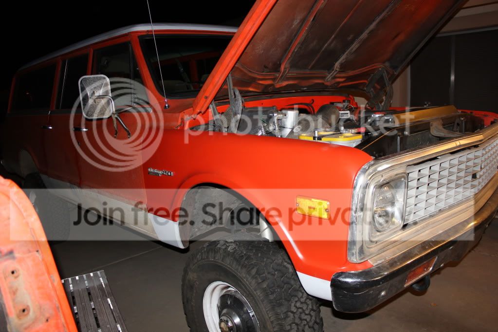

While I had the front of the truck off to change the auxilliary cooling fans I got a used fender, painted it and installed it. I used flattening agent to match the sheen of my old paint. The color is not exact (it is actually a whole lot closer than this pic shows), but it is pretty close considering what I had to work with. After a summer or two it should be good.

I was thinking, it's obvious, you changed the fender! Then I realized it was something besides the fender. How about that shiny pipe on the building behind the fence? Or the new u-bolts on the drivers side of the front axle? How come the parking light is loose behind the front bumper? ha ha
Wow...no dents! Not gonna recognise the old gurl...
The dents are still in every other panel on the truck, so it shouldn't be too tough to recognize.
Nice pictures, and good work.
Thanks!!
Shiny pipe is not my creation. Like they did not have a saw or something?? Jeez. U-bolts went in with the axle whenever it went in. They got a nice wash-job in the snow and sleet and rain and hail so they look shiny. Parking light is loose because the bumper was going back on in that pic and had not been installed yet.
The dirtier the fender gets, the better it matches.
OK, well al my guesses failed so someone else will have to guess what else you did. I'm sure you did it well whatever you did. :waytogo:
No intake, already has rear a/c, no need for rear heat in this desert, same intercooler mounts as before.
Yeah, that got replaced with a used piece when I did the fender, but not what I was referring to.
