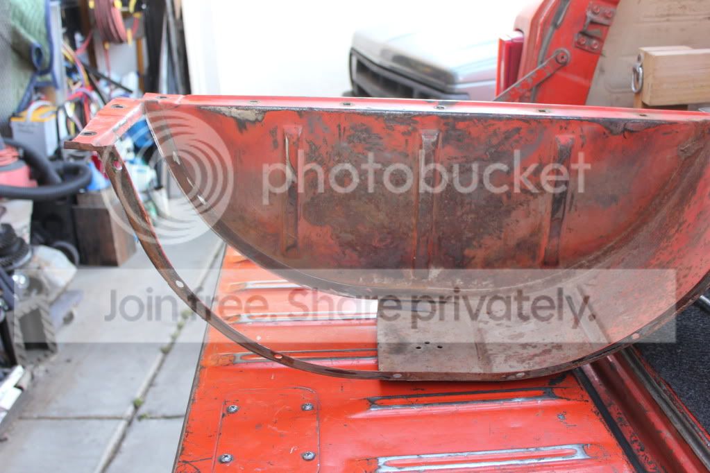

So, with one tire gone, what to do now?? I got rid of the stock size tire that I carried in the spare tire well. My other spare rides under the sleeping platform. I decided that since the larger spare would not fit in the spare tire well, that would be a good place to start renovations.
I pulled the spare tire well out and cut the back half of the radius out.

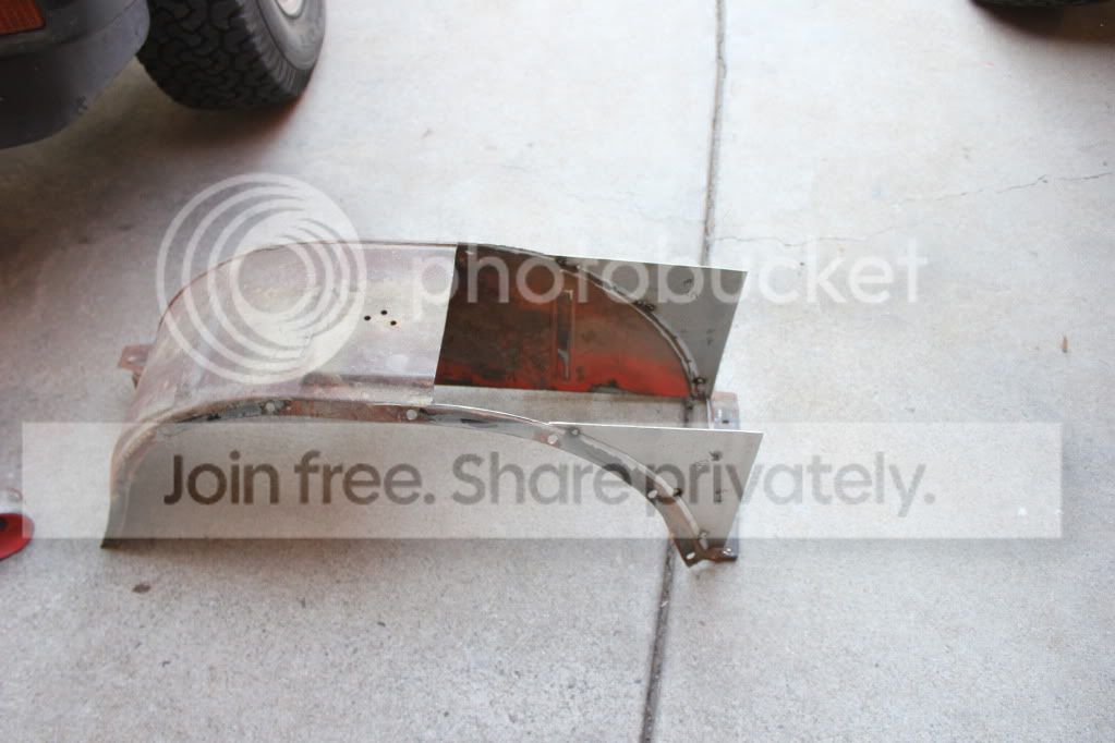

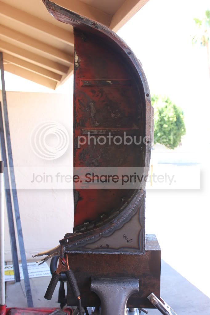

I wanted to do the front of the well, but that part of the well forms the lower part of the fenderwell for the right rear tire and I thought it would look goofy. It's all about the looks. I then welded some filler pieces to the sides of the open radii.
I then took some sheetmetal and made a piece to fit in the bottom and in the rear area:

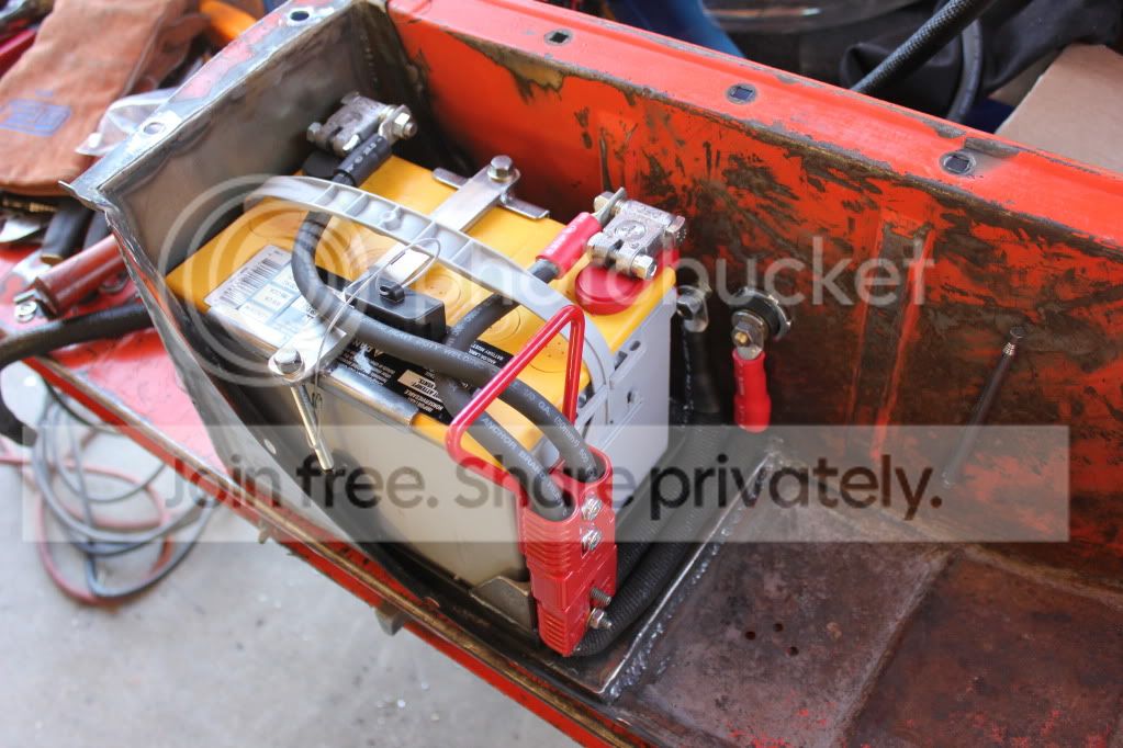

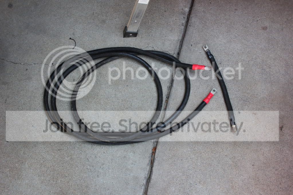

Now it is fully enclosed. I then went and jacked the battery out of my Nova figuring if I am somewhere needing this power, I can't be driving the Nova simultaneously, so I decided to share its AGM Deka battery. I got some high amperage disconnects and made some cables out of super-fine strand 1/0 welding cable with the military battery lugs. This pic is a final test-fit of the goods--not a final assembly)
I have it wired so everything that is hooked to it can be used whether the battery is there or not. That way if we are doing a quick overnighter, I don't need to have a battery in there and everything will still pull off the main charging system, but if we are going on a longer run, I can drop the battery in and everything will run off of it. So, for that to happen I need soe sort of an isolator.

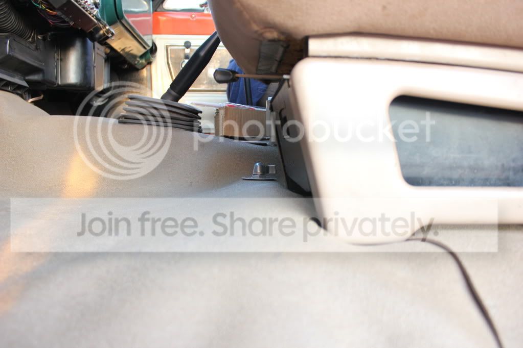

I looked at various styles and decided they were either too much money or not enough quality. I have never been a real fan of automatic units--not syaing there are not some decent ones out there, I just don't particularly care for them. I decided to use an old, dumb, battery master switch. Yep, clunk, on and clunk, off. It doesn't get much simpler than that. I do not have to worry about whether it is connected or disconnected when it should or should not be. Stupid simple. My favorite kind of part. I mounted it at the base of the driver seat.
I also put a junk drawer under the seat. It is a nice addition as sometimes the stuff under the seat would come out under braking while going down hill. Not a good stiuation.
