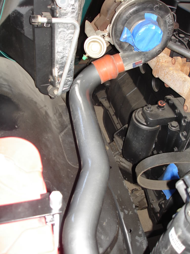

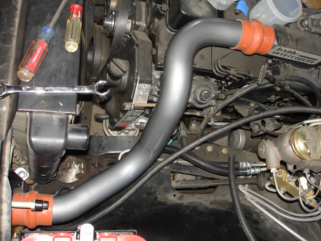

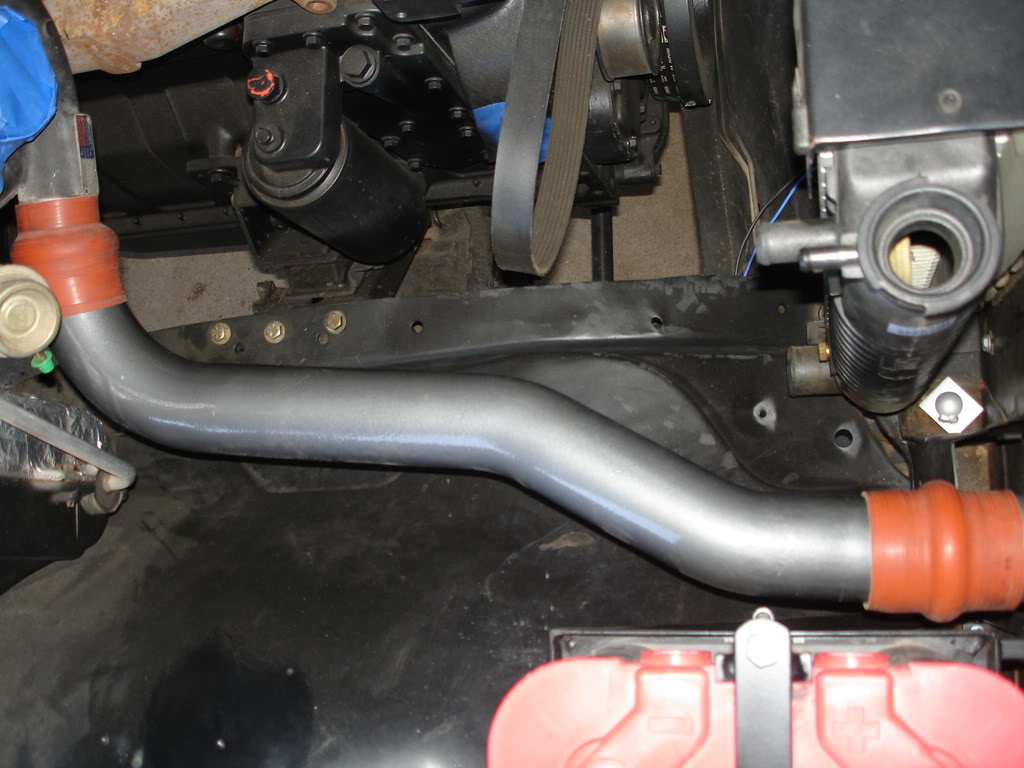

I got a little more done here this weekend. I have been working on the intercooler tubes off and on for awhile and finally got the fitted. They worked out pretty good as I was able to re-route and re-engineer them to fit where they need to be. I cut some out here to bring this up or over or down and I used the chunk I cut out to lengthen this piece or drop that part down etc. When the sparks settled I ended up with about 3/4" of tube left over.
Passenger side tube:
full
A different angle:
full
The way the Banks kit was set up, it used a hose that ran from the intake plenum, ran across the top of the motor, across the exhaust manifold, past the turbo to the wastegate actuator (the thing with the green cap on the end of the hose nipple). I did not really care for the aesthetics of that. The pressure is the same after the turbo and before the intake manifold anywhere in the system, so I decided to make the plumbing a bit cleaner. I installed the passenger side tube and reached around to the back and found a spot that could not be seen from the front of the vehicle. I pulled the tube back out and put a dot on it. I then bored a .187 hole in the tube and took a hose nipple I made out of a piece of .187 brake line that I put a bubble flare on the end of and silver soldered it into the intercooler tube. Now, a hose can be run off of that nipple around the back of the I/C tube and loop up and around to the wastegate actuator. Instead of the hose hanging out in front of GOD and everybody, it will just kind of show up from out of nowhere and loop around to its final destination. About one foot of hose versus about four feet.
Like this:
full
The driver's side was quite the pain in my hinder. I think every straight section of the pipe had to be modified. After all the work that went into it I think it looks pretty good. In the bottom of the pic the infernal power steering lines can be seen. The chunk of bulk hose running kind of parallel to the I/C tube is power steering fluid return to the pump from the cooler that needs final routing and to be trimmed to length.
full

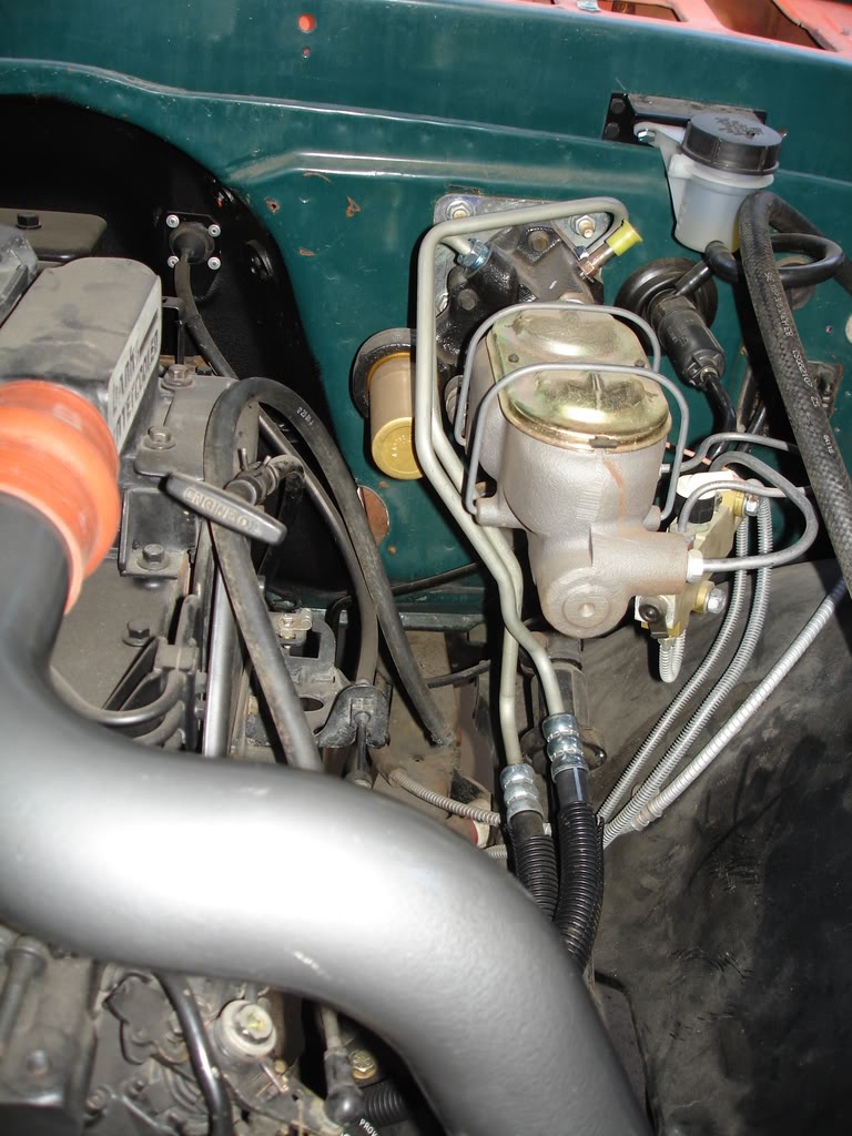

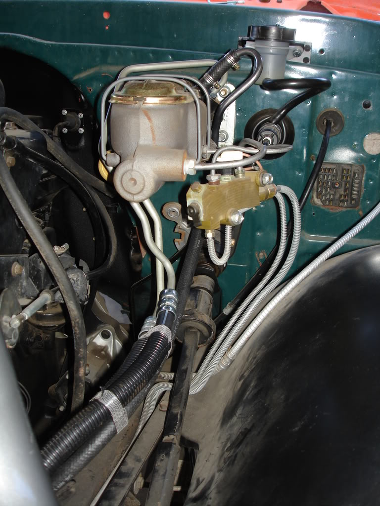

I built my hydroboost and installed it awhile back, but there was no photographic proof of it. I was going to use a H/B off of a late 80's V3500, but the mounting plate was so gangly I did not like how it looked and was not enthused about the amount of work needed to make it fit. I had another H/B off of a '99 C3500. This is the way to go. It has an extremely simple mounting plate that lends itself well to modification. I inverted the mounting plate and bored two holes in it and that was it--done. I had to enlarge the hole in the firewall a few thousandths to get the nut that holds the H/B unit to the plate to fit through the hole and I lengthened the input rod a bit. I used some fluid lines for a mid 90's C3500HD with a 5.7L. They were NOT a bolt on deal, but they required the least amount of modification to fit (the least amount, but still a lot). I liked them a lot because they come off the H/B unit on the engine side of the unit instead of the fender side like the V Series hoses. This gave me room for my clutch master cylinder which is also visible in the pic. Obviously it is in, but I do not have a couple key pictures to illustrate the work done and it would take too much to try to explain what I did, so I am going to hold off describing that whole deal until I get a few pics of a couple parts.
full
That is going to be so nice! I put hydroboost and a hydraulic clutch from an 89 old body style 1 ton into my 69 K20 - your going to really like the h/b!

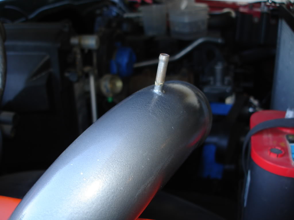

Part of the reason for needing another different water outlet was because a bracket for the top of the alternator was needed. It looks like this:
full
It is going to get a slight modification later on for reasons relating to lack of space for another part, but that is s story for another day. Now, with all of this, I get to use a different alternator. I decided to go with a nice hefty medium duty truck unit. Dodge alternator on right, MD truck is on left--slight size difference:
full

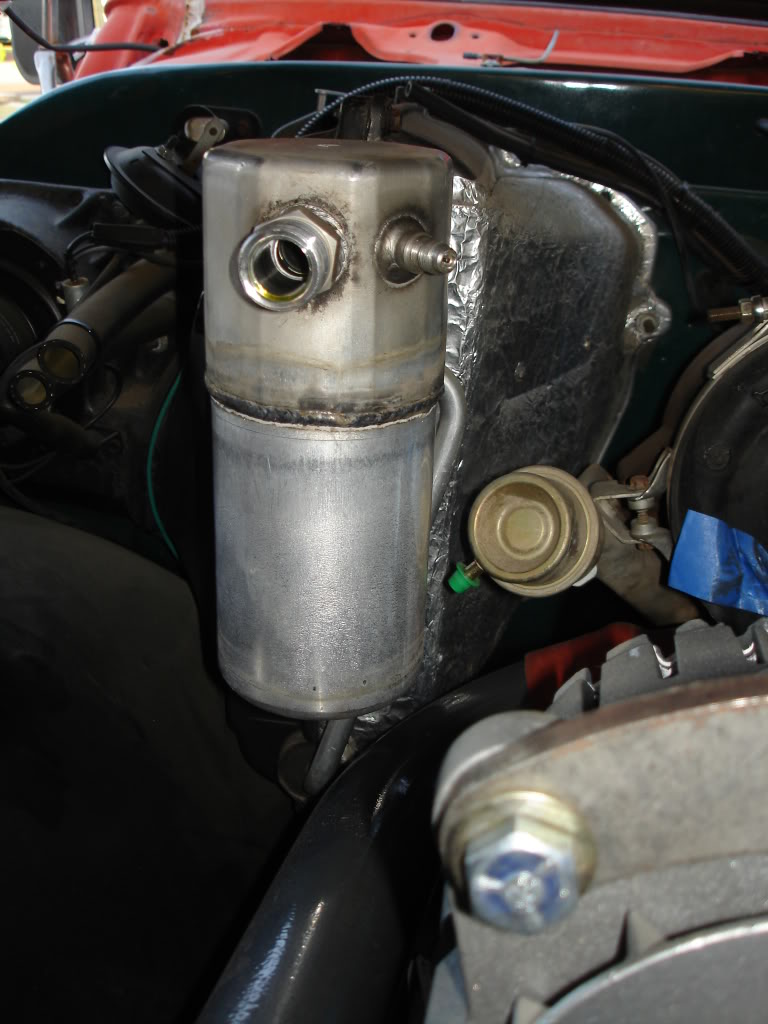

I was a bit nervous about clearance for an accumulator to fit near the intercooler tube, so I dug out one that I had here and did a test fit:
full
By the looks of it, I am guessing my eyes were in calibration when I laid it out because it looks like it will fit good. The pic does not illustrate it too well, but there is a decent amount of clearance all the way around it.

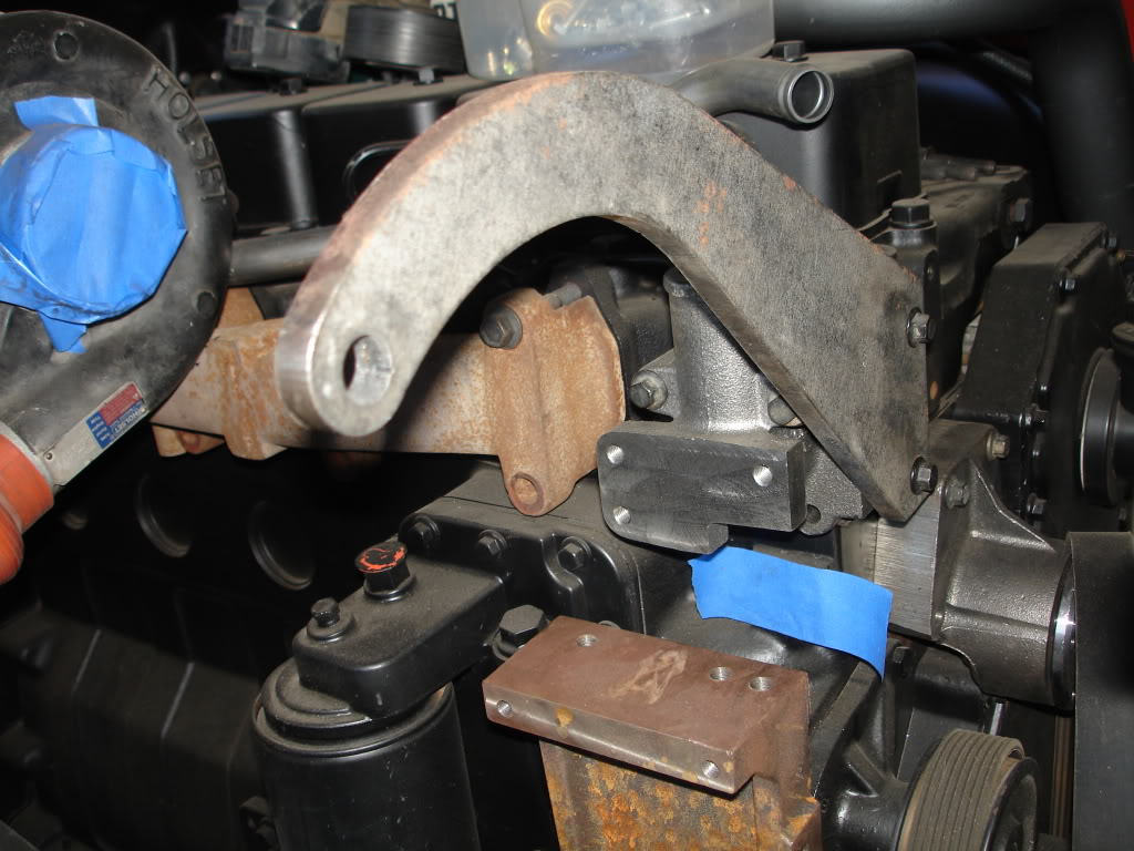

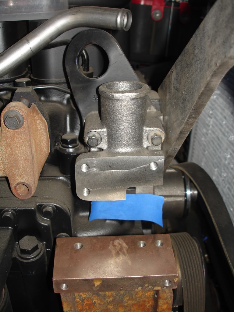

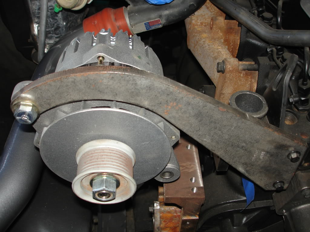

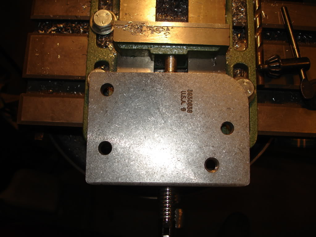

I decided the fun-for-the-day would be the lower alternator bracket that I ordered months ago from Cummins and am still waiting for.
I started with this:
full

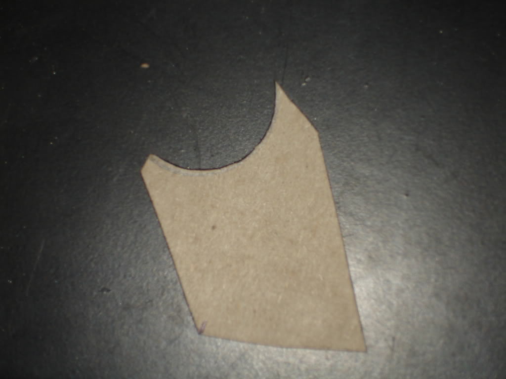

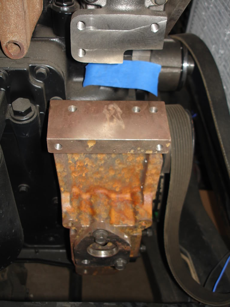

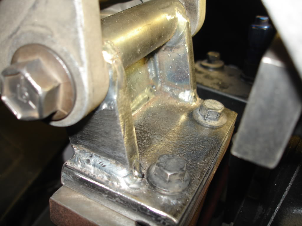

I took a piece of 1/2" plate and cut a piece to fit the top of the water inlet housing mounting to the two rear holes (front hole not used). Then I took a piece of 3/8" plate to make legs that look similar to this:
full
The legs will go between the 1/2" plate and the 1" round bar that Russ (BadDog) bored a .500" through-hole for me. I welded it all together and ended up with this:
full
It turned out good. Mounted up and gave some more girth to an already fairly stout upper bracket. While I was doing this, I got a call from Russ and was informed that he had finished machining an uber cool part that I dreamed up to solve a problem that arose in an area near this. I will post details and pics after I get over to his place and acquire the part. Stay tuned.

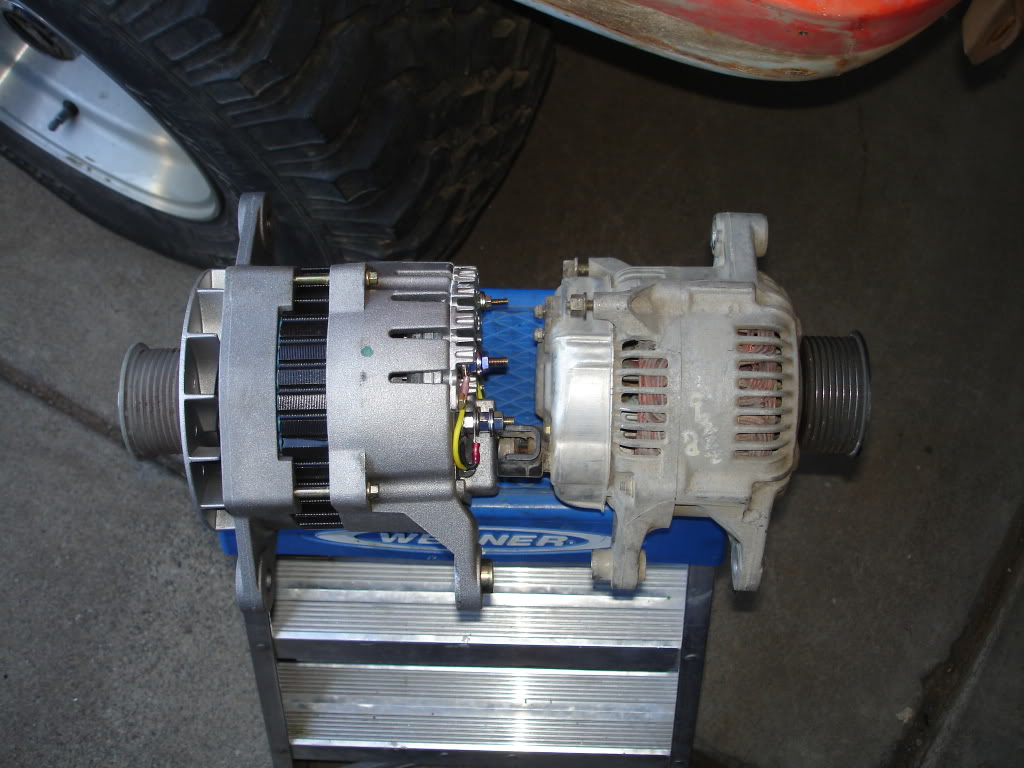

Is that one of those altenators that came up missing from a freightliner dealership in colorado and magically reappeared in your garage but in slightly reburbed form?
Actually, no. I was going to use one of those and I picked the nicer looking one and decided to clean out the "big truck funk" that was plugging up the internals and when I got it disassembled I found a broken part in the rectifier area. The other one was a low amp unit and looked rougher than the first one, so I got in contact with a pal at a big truck supplier in town and got a very nice deal on a brand new 130A Leece-Neville. I used one of the other ones for the mock-up and when I was welding nearby.

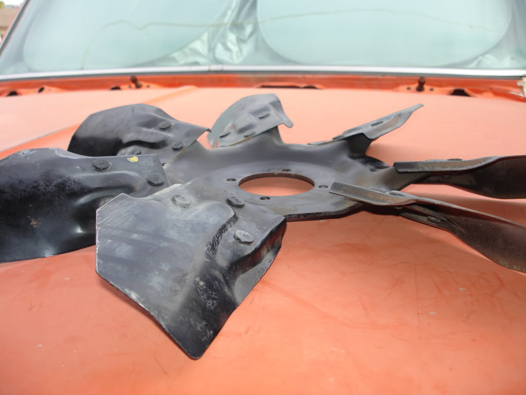

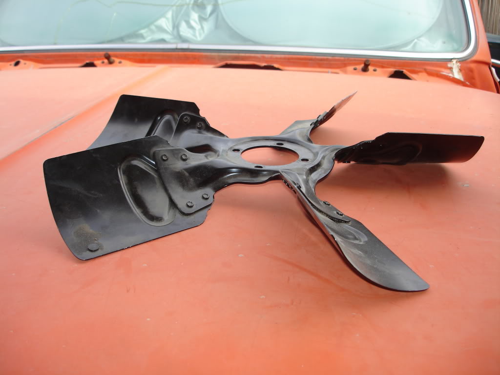

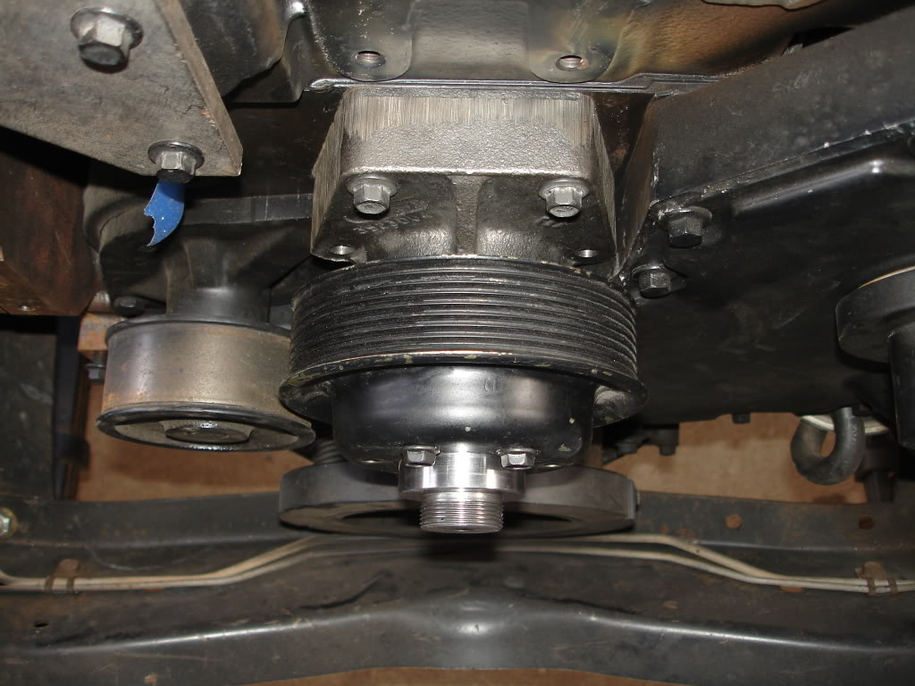

Well, I determined a problem that I knew existed was more of an issue than I initially believed. The stock fan from the Cummins has a couple bent blades. Now, they are not bent horribly, but I am not too excited about straightening a fan blade. I did a bunch of research and learned a few things. The first thing I learned was that these fans were known for pitching blades off at speed--not good, but even worse when the stock viscous clutch is replaced with a direct drive clutch that has no "cushion" to speed up. The clutch engages and it is at speed right now. This is not a good mix with a fan known to pitch blades.

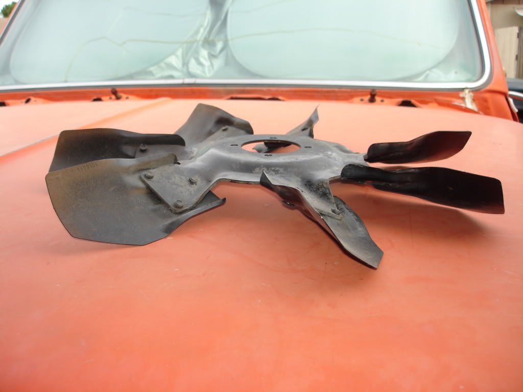

The next thing I learned is that this fan is not correct for the fan hub I am using. A few posts back there are pics of the differences in the fan hubs. The main difference is the length of the hubs. The offset one sticks out further than the non-offset one. The fan I have is designed for the longer hub which creates a fitment issue when run on a short hub. This pic illustrates what I was going to do until I realized my problems were more severe than I initially thought:
full
In the pic it is just barely visible, but the clutch is not threaded completely on to the hub. This is for clearance between the fan and crank pulley. I thought it would be ok because it did not hit and the fan would, in theory, pull away from the engine toward the radiator when engaged. Then I learned how crappy the fan was stock among other things and decided something else needed to be done with it. The stock fan itself is a rather weak fan compared to others I have used in the past which did not thrill me, but what could I do?? The fan is a strange animal. Here are a couple pics to illustrate the strangeness:
full

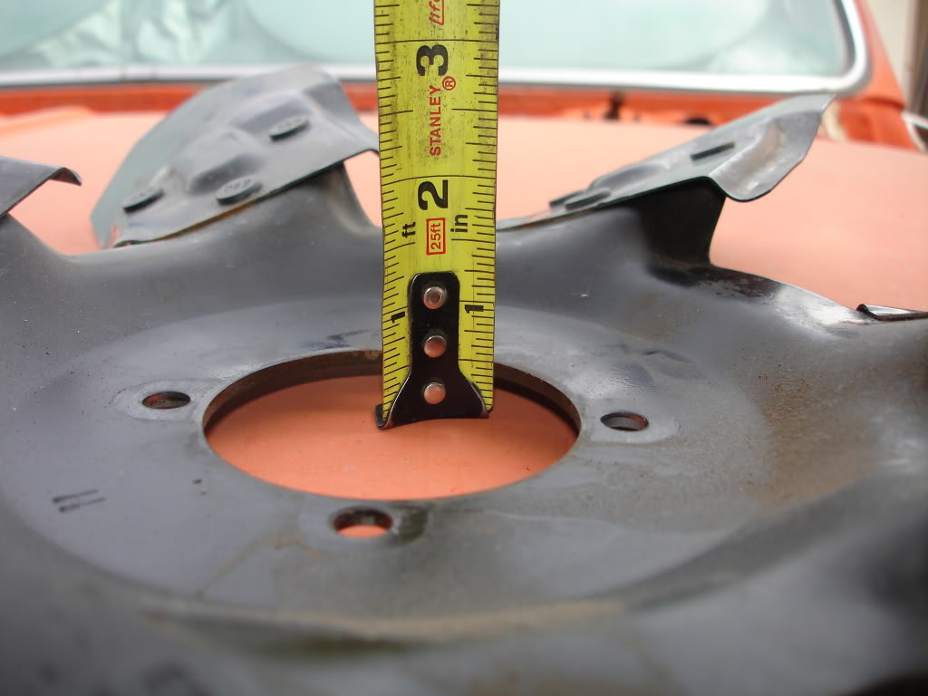

Not too strange looking, right?? Well, flip it over it gets stranger:
full
Add a tape measure and it gets real weird:
full
Yes, that is about 3/8" of backspacing on that blade. This may be typical of an inline motor, but as a purveyor of V-configuration motors it is real weird to me. Now, to use a stock blade I would have to find one that has LESS than 3/8" on the backside. Hmmm, does not sound like fun. I got no help from Dodge on what fan I could use because there were a bunch of variables. This motor, originally being non-intercooled, got a smaller diameter fan than the intercooled motors. That coupled with the using of the different hub got me nowhere. So, what to do?? I had one of the super-bitchin' big block fans (the one that the big seven blade fans from the 70's supersedes to because it pulls so much more air) from the previous motor, but the backspacing on it was tremendous compared to the stock Cummins fan. That's not going to work--or is it?? Hmmm.
full

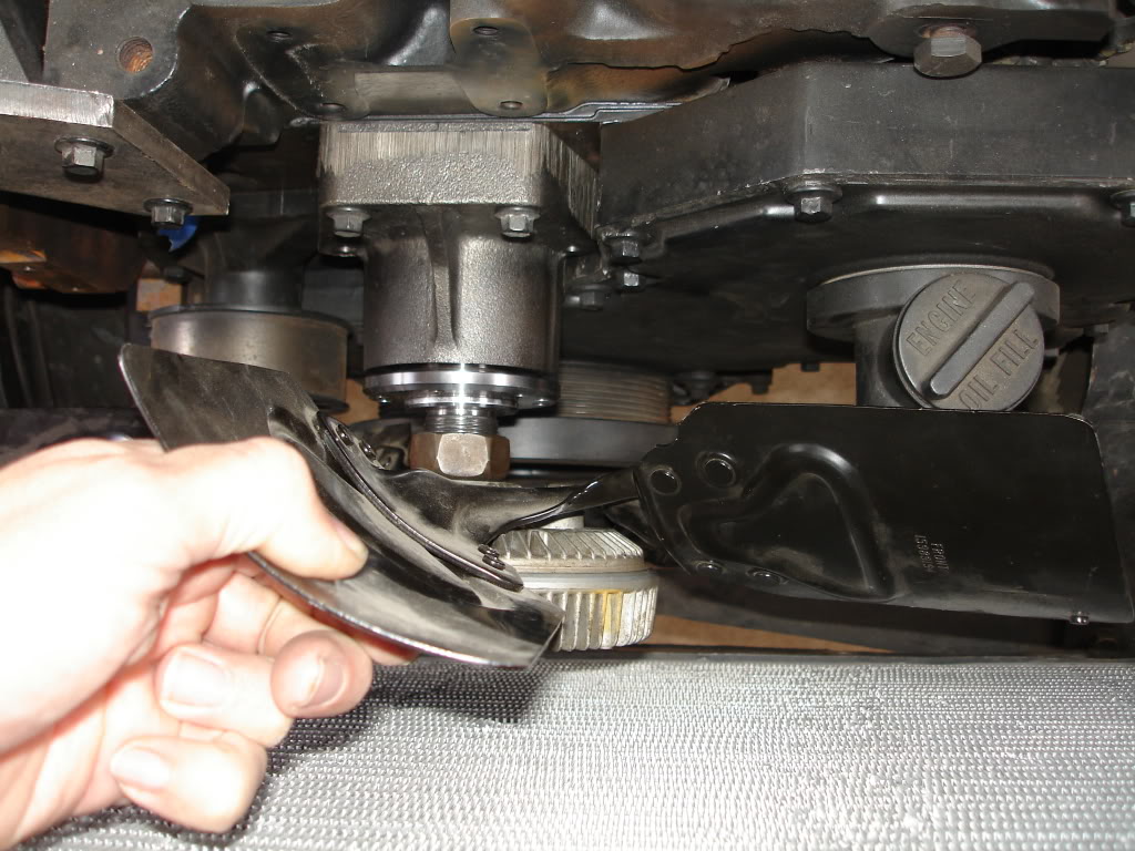

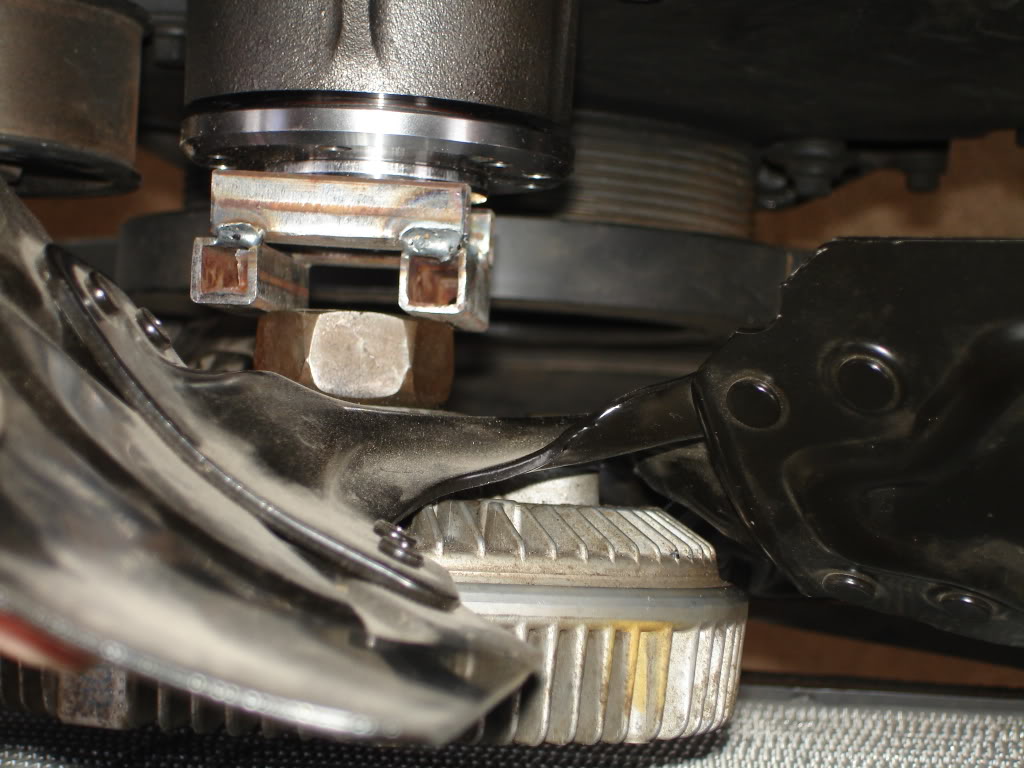

Man, that's a lot of backspacing. Probably can't be done so I think I'll give it a shot. Let's see here. May as well try a test fit:
full
Yup, just as I thought--it hits everything. Oil fill tube, water pump pulley and crank pulley. Not good. Well, what if it could be spaced out a bit. By my measurements it would take a fuzz under one inch. Hmmm, how to make a temporary one inch spacer to test my theory??

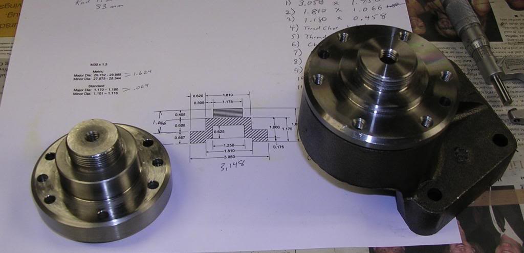

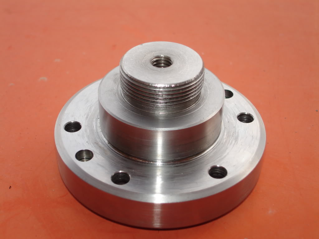

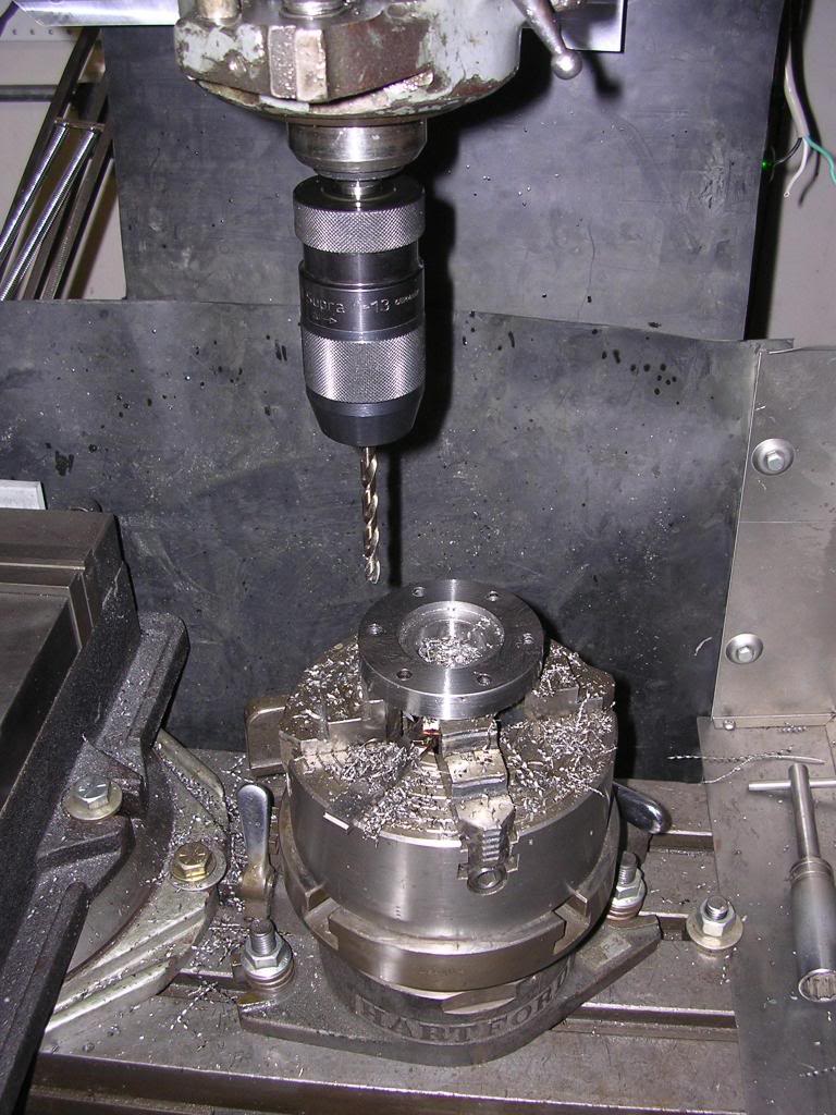

Ok, so where to get a slug that will be of decent enough quality to machine what I am envisioning?? Russ @BadDog has a friend with a machine shop that has bins of drops (cutoffs) and said he was going down there to get something and he would check to see what he had that we might be able to use. He found an unmarked slug in a bin of 4140 and 4142 drops, so it should be one or the other which would machine easily, but have good strength. Well, it turns out to be something completely different. Russ found this out after beginning the machining process. The material coming off of the slug was like a coiled up razor blade and would not break!! After some investigation, he determined that it is annealed 4340 spring steel. Way overkill for what we need, but it's what we have. He managed to find a feed setting that would break the material coming off into about 4-5 inch pieces (he was getting 4-5 FOOT long pieces of razor blades coming off of it). The material composition did not lend itself well to a nice surface, but it isn't going to be seen, so I don't care. This is what we ended up with: (no pics of it being machined, but here is one of the bolt circle being drilled)
full

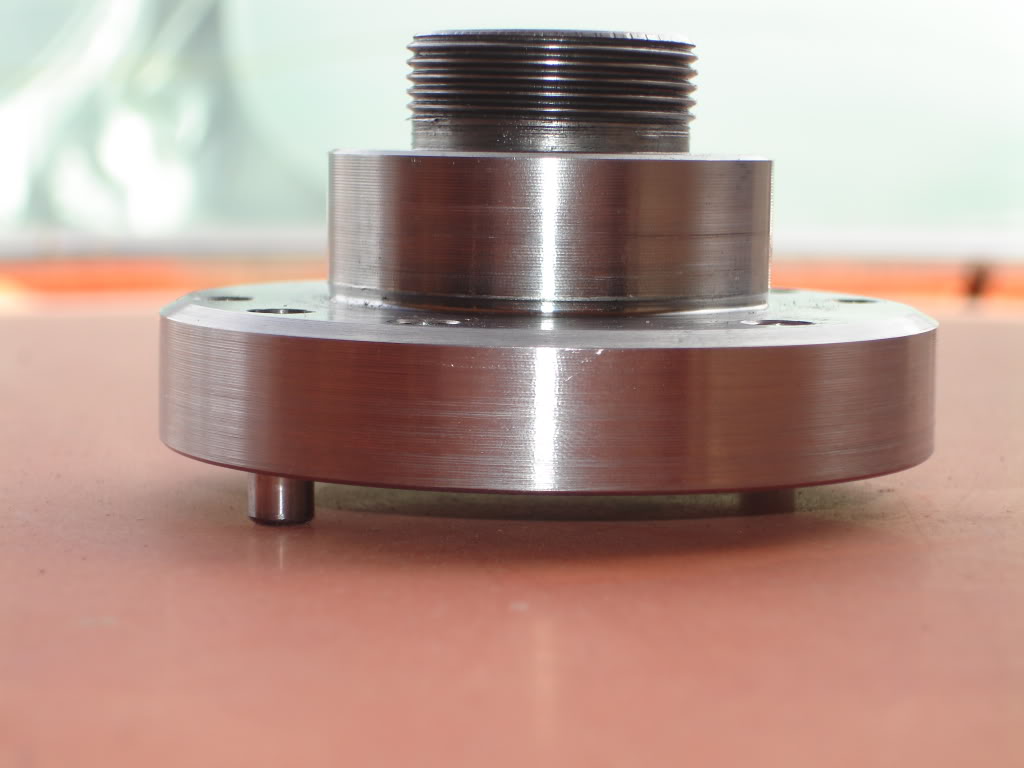

If you look closely at this pic, you can see the one dimension I gave him to start with (one inch):
full
The threads are 30mm 1.5 left hand threads. They turned out better than the ones on the stock hub. This pic shows the 1/4" hardened pins that Russ added for more insurance in alignment and strength:
full
Another angle:
full
We decided to go with the pulley for the long hub so the spacer could mount directly to the hub and have a nice shoulder for strength. Here is a test fit on the motor:

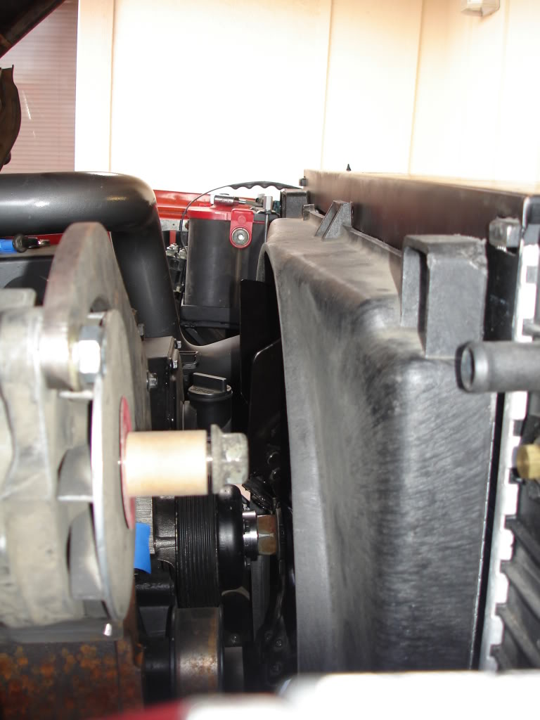

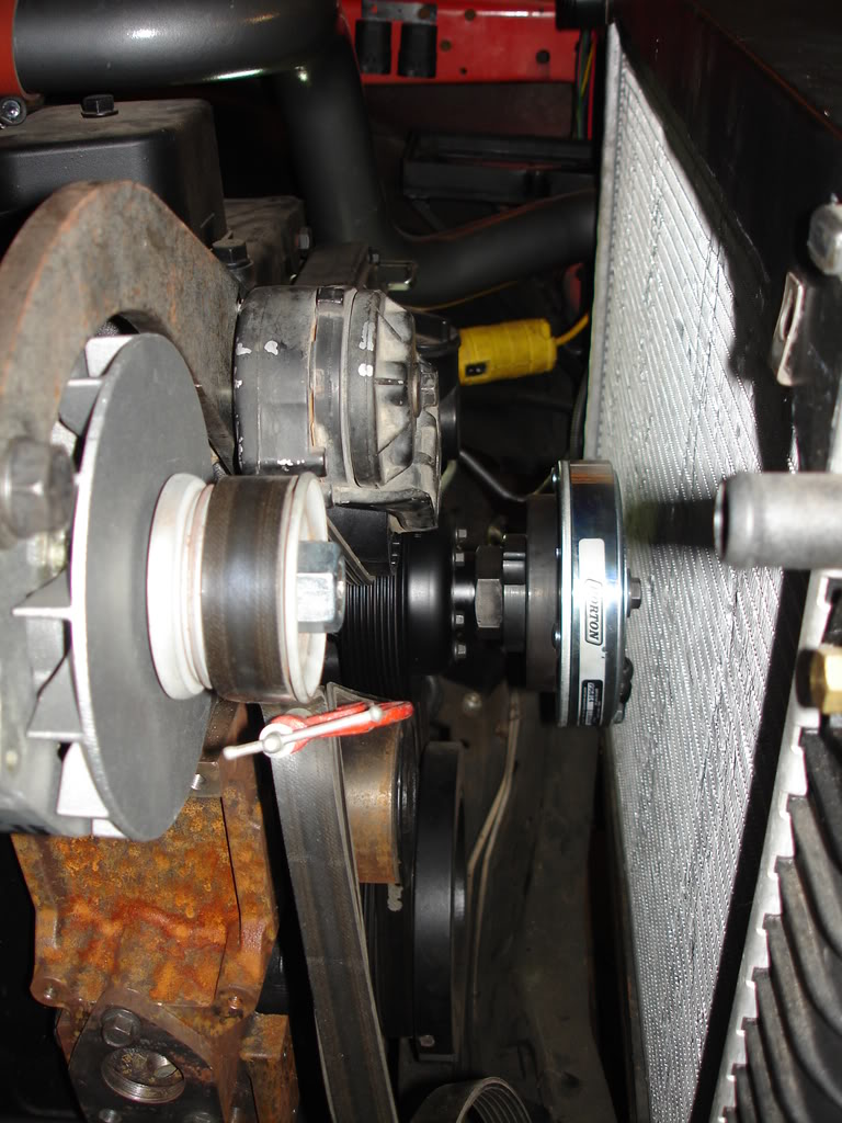

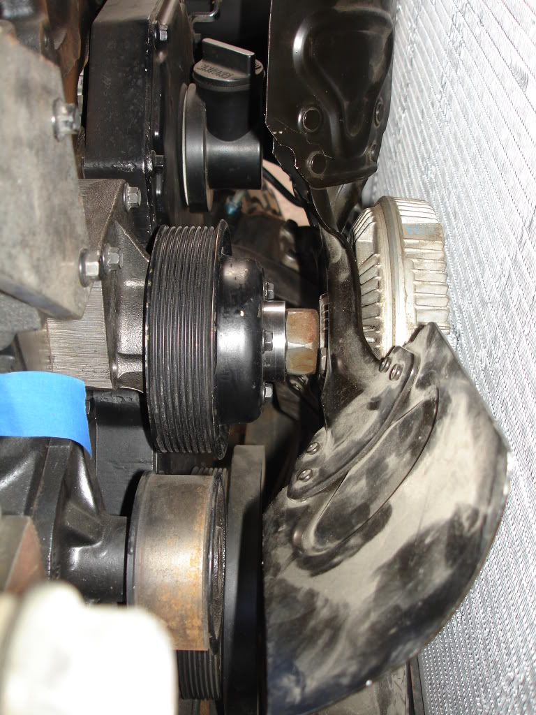

Looks sweet. Let's try the fan now:
full
It fits good with good clearance to the radiator (pic does not show this well) and 3/16-1/4" between the fan and the oil fill, water pump and crank pulley. Now for a shroud:
full
It fits good. Not quite half-in half-out, But I'm calling it good enough at this point. I did all of my test fitting with the stock viscous clutch because it is less cumbersome that the Horton that has a leash (Harness) that seems to always be in the way when working with it. The clearance between the clutch and the radiator is great enough that it will clear the Horton fine.
So there you have it. One bitchin' piece of engineering to solve a strange problem. Many thanks go out to Russ for his perseverance and skill in turning an otherwise generic slug of metal into spiral razor blades and a hub that alleviates a major roadblock on my path. Thanks again!!

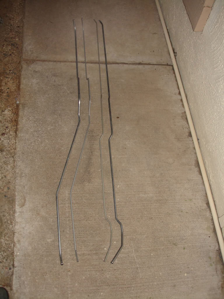

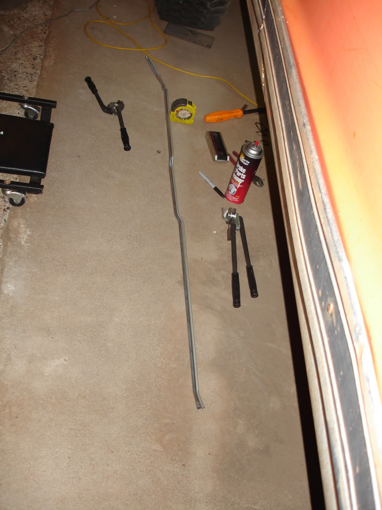

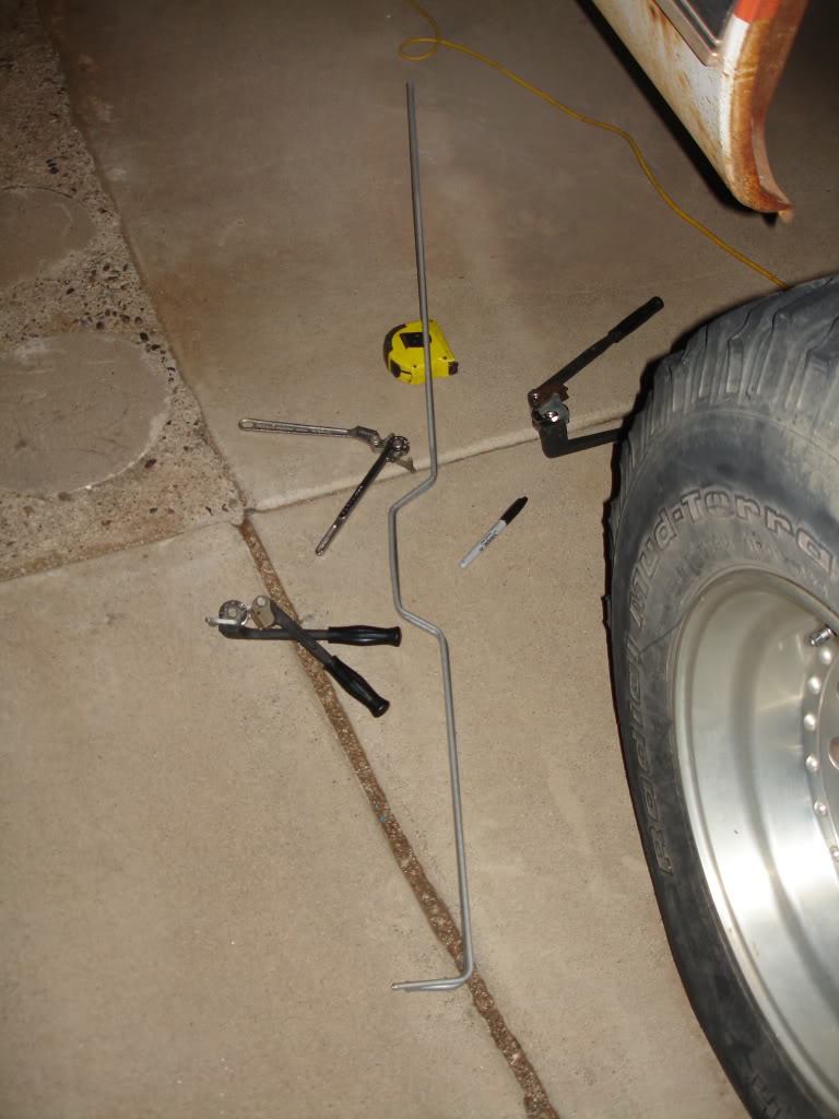

I have to stay up real late tonight, so I figured I'd go out in the shop and get something accomplished. I did not know what, so I decided to think outside the engine compartment for a change. Fuel lines, that will be the project for tonight, err, this morning. I was hoping to be able to use what is on the truck for fuel lines, but they run down the right frame rail and the fittings are on the left side of the Cummins. I could not devise a non-hack approach to get the fuel from one side of the frame to the other so, as usual, I had to make something different.
I started with the rear lines. The only specs I have to go by are the diameters of the connections on the motor. The lift pump uses a 5/16" hose barb and the return line uses a 1/4" nipple. My tank is set up for 3/8" line, so I decided to make the feed line 3/8" instead of 5/16". Now, I am no pro at bending steel line, but I have learned a few things over the years. I recently upgraded my equipment from a POS Snap-On tubing bender that did 1/4", 5/16" and 3/8" tubing in one tool that was absolutely horrible for anything over 1/4" because the handles are too short, and went to four different Ridgid benders. Man, what a difference that made. Another thing I learned long ago is that one line is simple to make, but making a second line match the first line requires some skill--which I do not have much of. I realized that, lacking this skill, I should start with the larger diameter tubing and match the smaller tubing to it. This made my life much easier as the smaller tubing is much easier to manipulate to match the larger diameter. It took me a couple hours and probably would have taken someone with bending skills about half an hour to forty-five minutes, but hey, time is cheap in the middle of the night.
Anyways, here is what I ended up with: Rear lines (there are two stacked on top of each other)
full
The variances in the ends are for hose clearance to each other. I am running them in factory type clamps that hold both lines tight together, so at the end the lines they have to splay out or at least take a different angle so that a hose and clamp can go on each one without interfering with the other.
The front lines:
full
All lines together:
full
Run the lines across the transmission crossmember that way they get to the correct side and they are protected by the crossmember.
good progress bro! I keep on wanting to give you a buzz, but I am unsure of when you are asleep or at work? Nice lines though and the fan hub thingermajig came out sweet! keep up the good work
I am working days this week and I will be around all day tomorrow, er, uh, today 12/28.
I have actually been making some progress on this, but I haven't loaded the pics etc, so here are a couple pics for now.
I got my power steering lines done!!
full

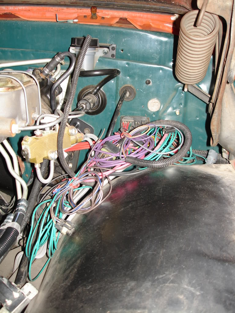

I know there are a couple people here who have been waiting to see this thing get wired, so here is the start of it. This is the big block harness that I made, grouped in circuits, awaiting routing and fitment.
full
Those of you who know my stash of GM electrical components will understand when I say that I am waiting on a large box of electrical stuff that I plan on working on this harness once. And nevermore......

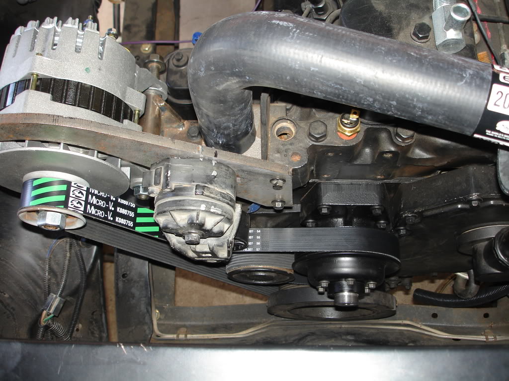

I figured it was about time to get a belt on this thing. The sticking point that I was dealing with was the tensioner. The water inlet housing that I used has provisions to mount a tensioner bracket on it in one of two locations. One is down low (there are two bolts in the lower holes in this pic) and one upper (you can just make out some silver spots in the pic where the upper mounting location is).
full

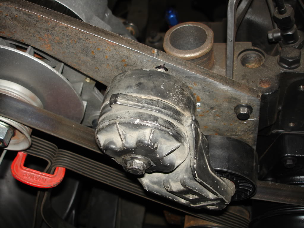

This plate is used to mount the tensioner to the water inlet housing: 3/8" plate
full
The problem with this setup is the location of the mounting holes in the inlet housing. The upper holes are directly in front of where the compressor will mount. This is bad. The lower holes put the bracket and plate into the frame rail. This is bad also. A plan "C" is going to be necessary. After staring at it for a few hours, I got an idea. The upper alternator bracket is a nice stout piece of 3/8" plate. Hmmm, that is the same as the tensioner bracket....
full
So I decided to route a belt on it and see if my theory would fly. I grabbed an old belt I had from a 4.3L and routed it around and used a clamp to make it the correct length. It looked like it should work, so I went ahead and drilled and tapped the hole in the plate to mount the tensioner. I did not drill the hole for the indexing pin yet.
full
It looks like it should work.
full
Now, it is hard to tell from the pic, but the routing of the belt was not ideal. It came straight up off of the crank to the fan hub, went around that, under the tensioner, around the alternator, down around the water pump and then back to the crank. I got a couple belts this length, but before I even tried them, I decided this was not a good setup. The fan hub had only about 90* coverage. When that Horton fan clutch engages, the belt is going to scream like a scalded ape. I decided to re-route the belt (I'm glad I made this decision before I bored the hole for the indexing pin on the tensioner). Now, the belt comes off the crank and goes to the water pump, wraps around it (over 180* coverage), then goes over to the fan hub and wraps around it (well over 180* coverage), then under the tensioner, around the alternator and back down to the crank. So with this change, I got excellent coverage on all the high-drag components without resorting to adding pulleys etc.
This is what I ended up with:
full
I was concerned with the location of the indexing hole for the tensioner, but in the end I got it right on the money. With the tensioner pulled all the way back, a belt can JUST be slipped on and when relaxed the tensioner is at 3/4 of its range.
With that done, I started looking in my box of stuff left to put on. Unfortunately, my box appears to have more stuff in it than there is room left under the hood for it. I decided to tackle the horns. They are Delco replacement horns, but they look like something off of a European import. I tested them out and they are loud as hell and have a domestic tone to them (no import squeak horns here). I toyed around with a few mounting locations. I do not recall this thing having horns on it when I got it, so I do not know where they are supposed to be, but I found a place that works well and would otherwise be unused space.
full
I'm getting closer.......
