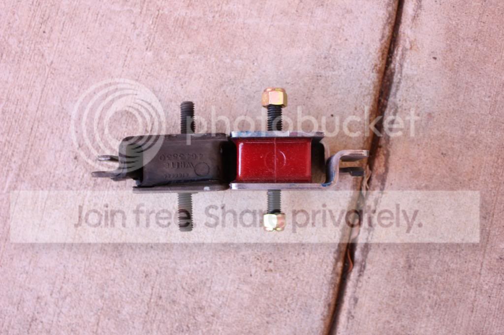

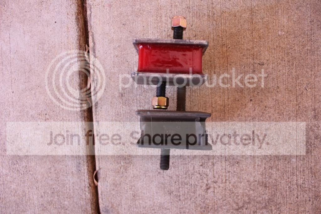

They arrived and I really liked what I saw. The next day I pulled the mounts out and replaced them with these. They are IDENTICAL in EVERY way to the original mounts. I could not find any discrepancies between the new and the old mounts. Very impressive.

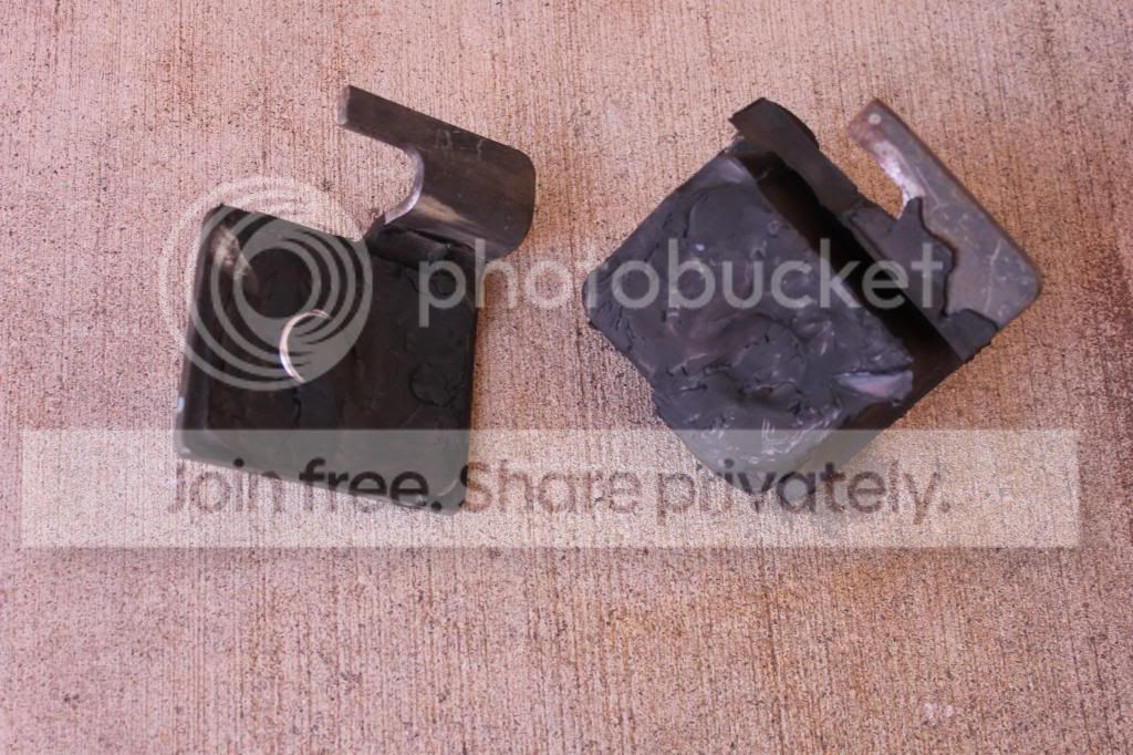

This was the cause of my new vibration:
No good no more.
So, a whole bunch of money on some super-double-throw-down-wizz-bang mounts. Yep. Worth every last penny too. I honestly did not think I would be as impressed as I was, but these things are everything the nice lady said they were and maybe even more. They dampen vibration every bit as well as the original rubber mounts did. Obviously I have not had them off road yet, nor on a super loose, super steep hill climb, but so far they are fantastic. I am very glad I found them.

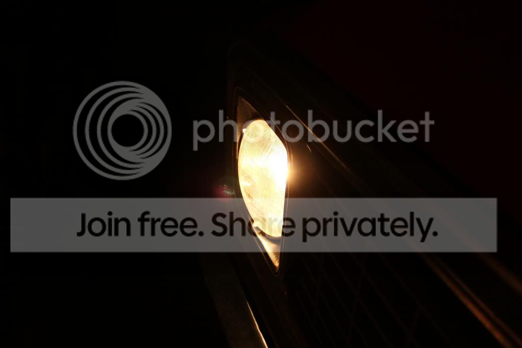

This is a shot of the old halogen:

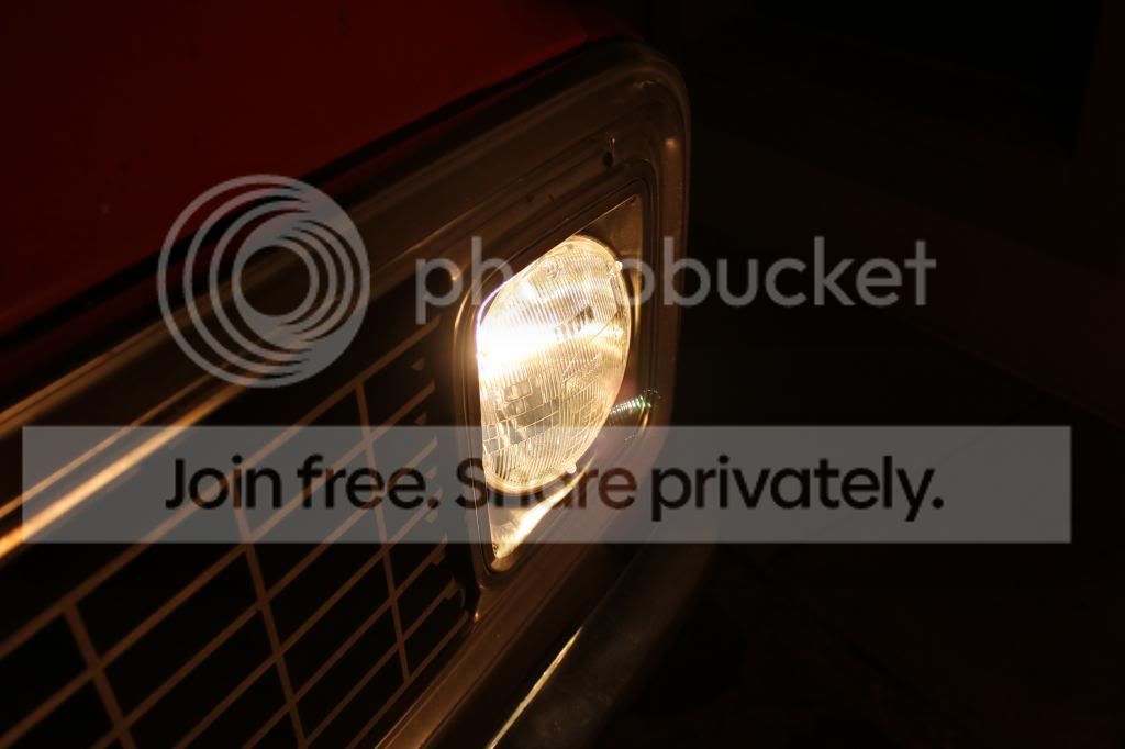

This is the Silver Star:
When I did this I realized I had never tried to take pics of headlights before. It is more difficult than i thought it would be. In the first pic it is pretty yellow. In the second pic it is more white. That is actually a pretty good representation of the difference in light color. The new ones are very white. I didn't want blue. I don't like those. Bright?? Yes, but not for me. I was really trying to determine if they were brighter and whiter etc, but I really couldn't tell for sure until one night when I was leaving work and pulled the headlights on and was amazed at how bright they were. Brighter and whiter than my work truck with two new composite headlamp assemblies running 9004 bulbs. Very impressive.

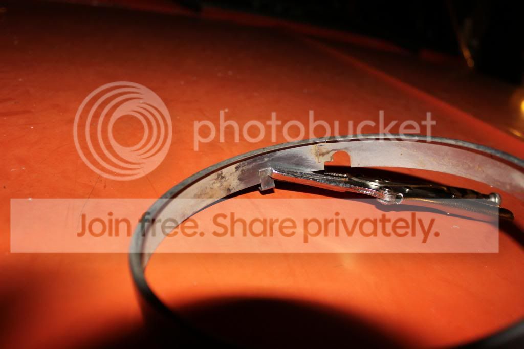

Simple headlamp change for a big improvement in light output. Well, not quite. Leave it to me to require a TIG welder to change a headlight:
The damn tab broke off the retaining ring. I went into my stash and found another ring, but it was too different, so I cleaned up the tab, grabbed the stainless rod and welded it back on.
Nothing simple for me it seems....
