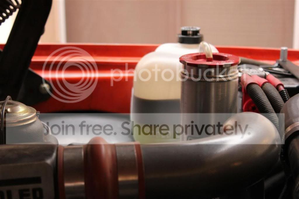

So we got home and had this in the reservoir:

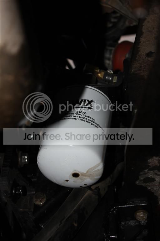

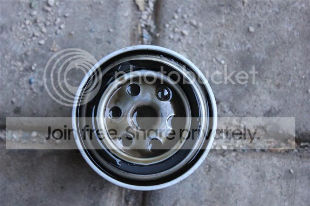

Is it bad when your coolant filter has an oil leak??
I don't think this is the right substance for the filter:

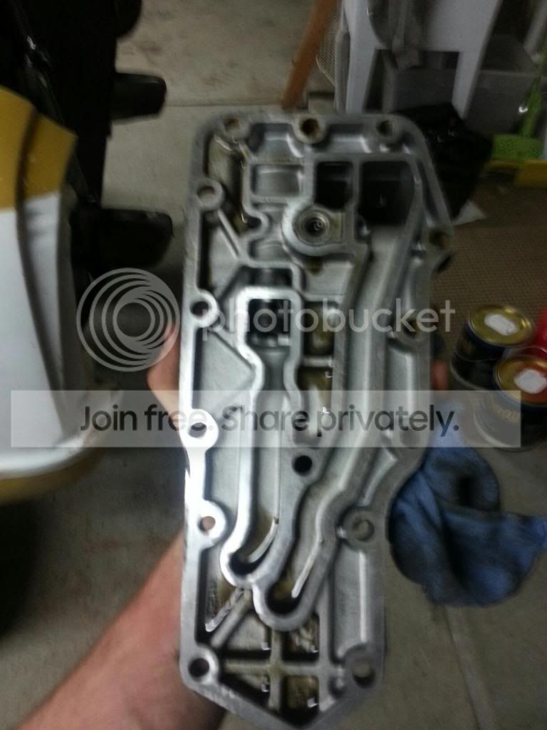

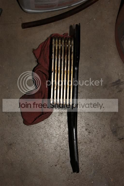

The first pic shows the plates of the cooler. It is a stout design that does not often fail. The plates sit in the cooling jacket of the engine.

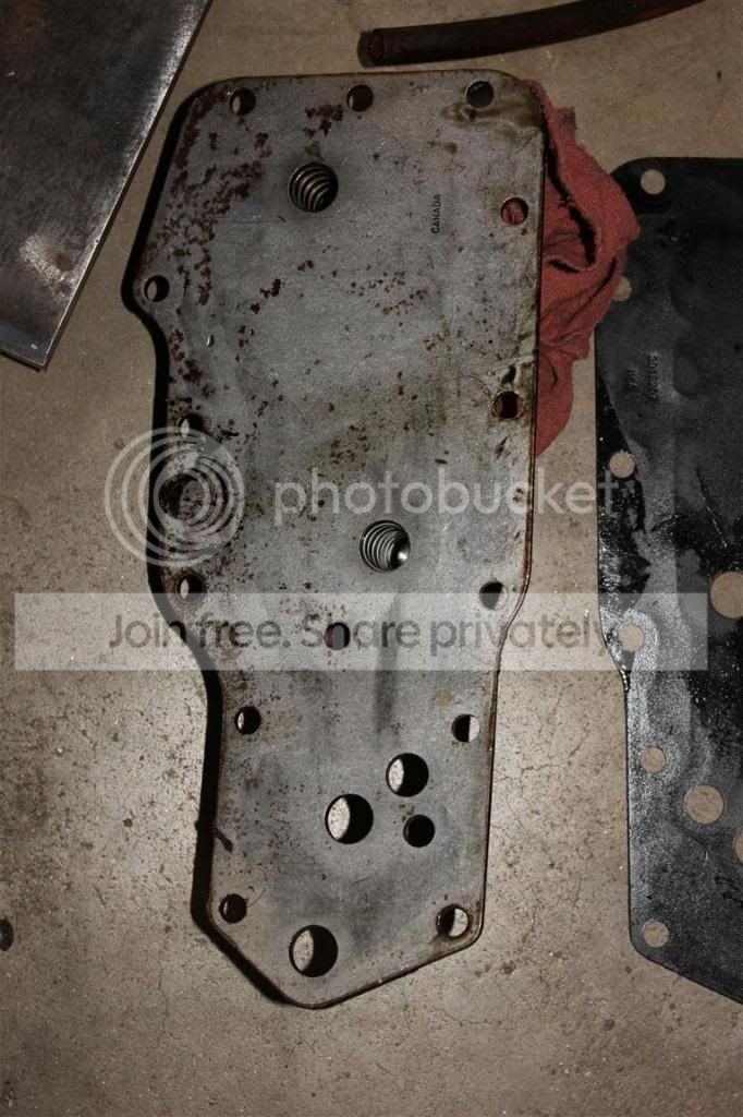

This is the side of the plate that the oil filter mounting casting sits against:

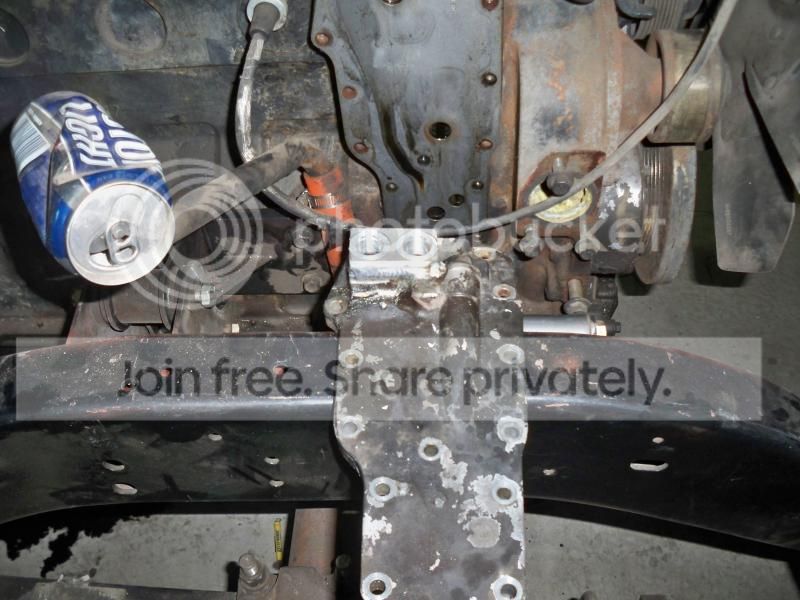

This is what the backside of the filter mounting head looks like. It has the bypass spring in it and it directs the flow of oil away from and back to the holes in the lower end of the casting which take oil from and return oil to the engine.
This is what the cooler looks like when it is mounted in the engine. The lower holes in the plate are where the oil originates from and returns to once it is filtered and cooled. That is the outside of the filter head in the pic also. The owner of this pic, ryanroo, cut the filter mount off the casting and welded on a flange with threads to create his own remote filter mount setup. Now, I swiped this pic, but he took the prior pic upon my request. He has his apart and it is hard to explain all that goes on behind the filter head whereas a picture explains it much easier.
So I guess it is possible to eliminate the factory cooler, but it would be quite the engineering ordeal. That coupled with the fact that they don't fail very often, seems to make it a less desireable project, for me anyways.
