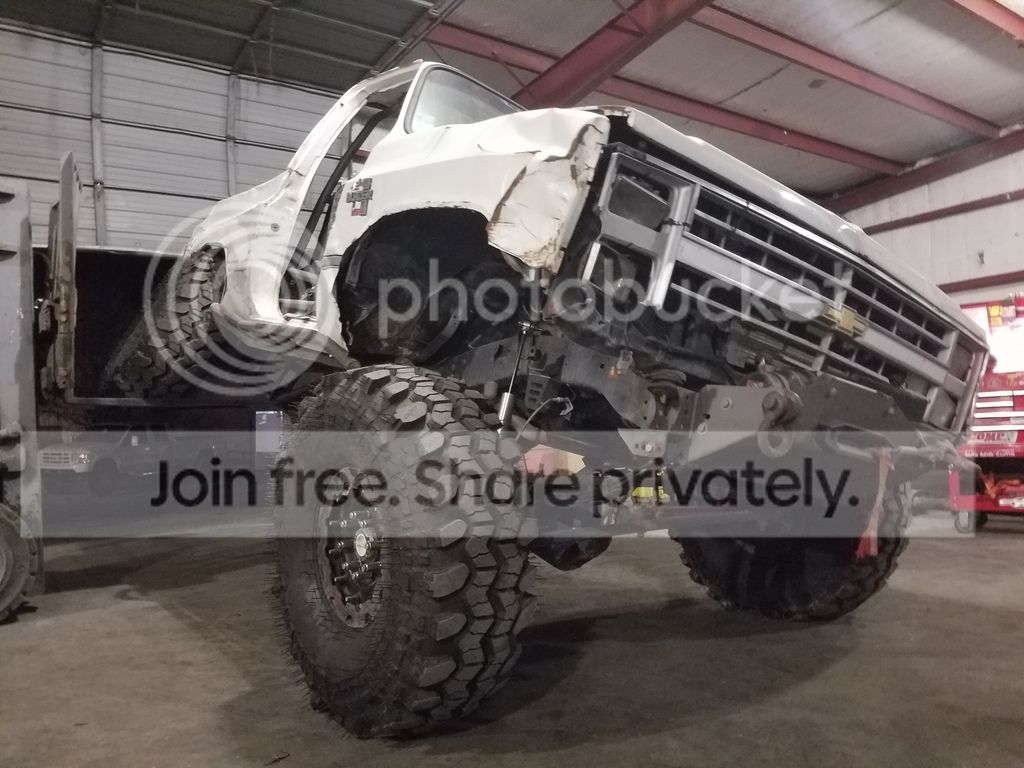

I have 56s and 63s on my off road truck. But have done 52s for other people.

I had 2 sets of 52s on the front of my burb. First were the half ton units, rode great, scary on the highway. I swapped them for 3/4 ton units (I now have 4 identical springs on my burb) . Ride is much stiffer but not near as scary on the highway. They still flex like crazy though. I installed the long bump stops from ORD and have the overload leaves flipped upside down. Ruined the 1/2 tons in just a couple trips without any overloads. Im not satisfied with the ride, but aired down on the trail its fine. One day I'm going to just bite the bullet and get custom springs made. Hope that helps :)
Mine are 1/2 ton 52s with a leaf added. Manners are just fine even at highway speed.
Flex very well
I do have mine setup with limit straps and bump stops. I don't need full travel and they have worked fine.
