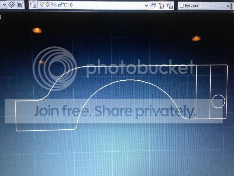

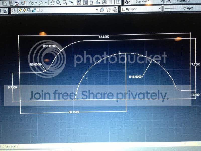

3/16 wrap around body armor ..laser cut . Hope it all got measured it all correctly :popcorn:
Was pondering 74628 ways to home brew these or use my contacts, i did get access to a 10 foot sheer and found a company with a die the radius I needed but figured my trusty collection of angle grinders wasn't going to cleanly pull this off.
Laser it is :pimp:
3/16 should survive some good times with me behind the wheel :p
You should make 10 sets and sell them.
Sadly I do not think there is a market, too many choices, 1/8 or 3/16 steel or aluminum , stock wheel well or bigger radius, stretch or not, tsil light holes, gas filler or none.
A lot of thought went into each one of those based on wheel base and wants. I will be pointing people to the guy making them though, with a digital file and baseline numbers from stock it's now silly simple for anyone to order a set that's custom.

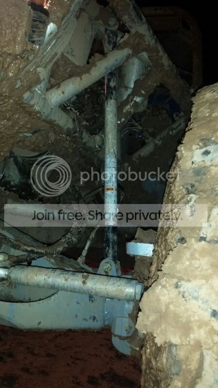

Ori failed..
High lift handle stepped up with the help of a drill tossed on my spare starter to replace the crushed one and I got to keep going the rest of the night.
:pimp:
And to think I almost went out their last night. You will have to post up when you do so I can catch a ride in this madness.:pimp:
did ya tow it home with a Ford?
Hell no..worn out front suspension ifs gmc..I can say the ride in the bogs with the high lift handle on one corner really didn't seem that bad lol

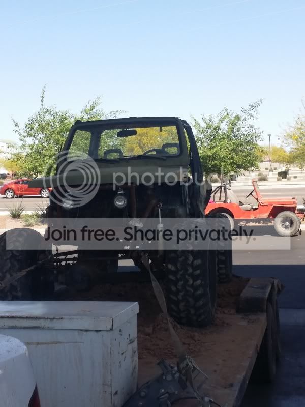

After I adamantly decided against yota axles I need up getting another pirates members old ride and hauled it home. I think that makes six parts or parted our vehicles now to build my willys lol
Was neet too see a couple kids driving an old flat fender in the background too. Cool parents for sure.
Yota axles
4.10 gears
Welded "I'll be changing that"
Already modified flanges to bolt up to Sami drivelines
The have high steer and cross over installed too! Not sure if the raised arms will work for me.
Saves me some dough too, now I don't need to buy rear u bolt plates or custome brake lines to convert from metric to waggy axes.
I'll sell the waggy axles and now I don't have to spend the time narrowing them.
