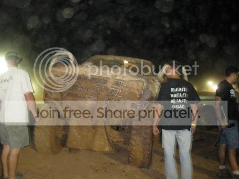

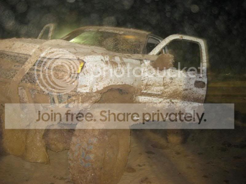

Truck did good, never got stuck which made my day. Had some real good runs and had a lot of fun. The only issue was it would not start after the 1st run. Trans wiring plug came off since the clip is broke from the install.. after a couple minutes it was found. Motor was getting hot but that was the trade off I took to keep the radiator and engine blocked from mud. Used a huge entry mat for a business and it worked great.
