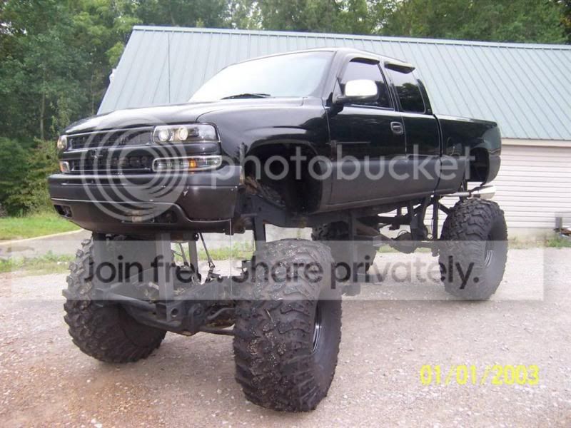

You should lift it high, but try another suspension design. This one looks well engineered..... It even has a ladder....
That thing is still IFS. That's what you should do Shawn...copy this. It's got to last a long time with that complete subframe up front so as not to wear out parts on the original. Plus, it will still ride like factory.:whistle:
I didn't realise last tiem this got posted that they just cut off the front frame section of another IFS truck and mounted it down lower.
