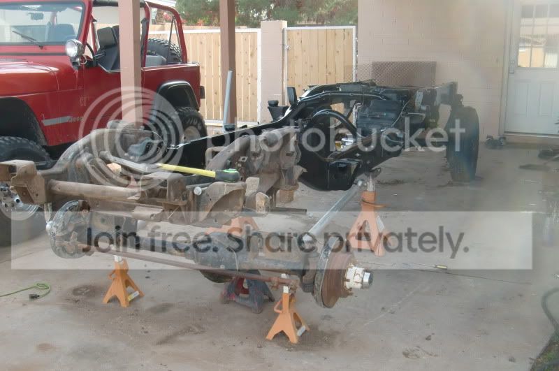

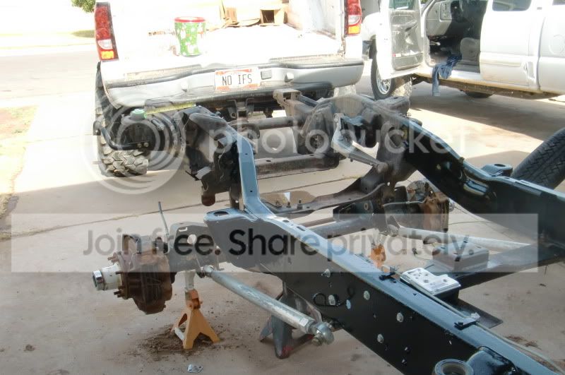

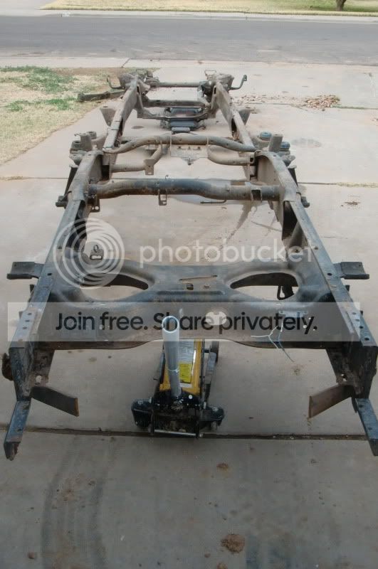

Moved my new frame for the 06 to the front and mocked up a 14 bolt I had around here for another project to make it a roller, put in the new 4" lift 63's and set it in place.
Dragged the frame out to the front then used my creeper and floor jack.. went much smoother than I thought:popcorn:
No pics yet but also painted all but the front of the frame with a few coats of Rustoleum black. I decided I might as well make it look nice and most of the coating gm uses had been wore off already..looks much cleaner.

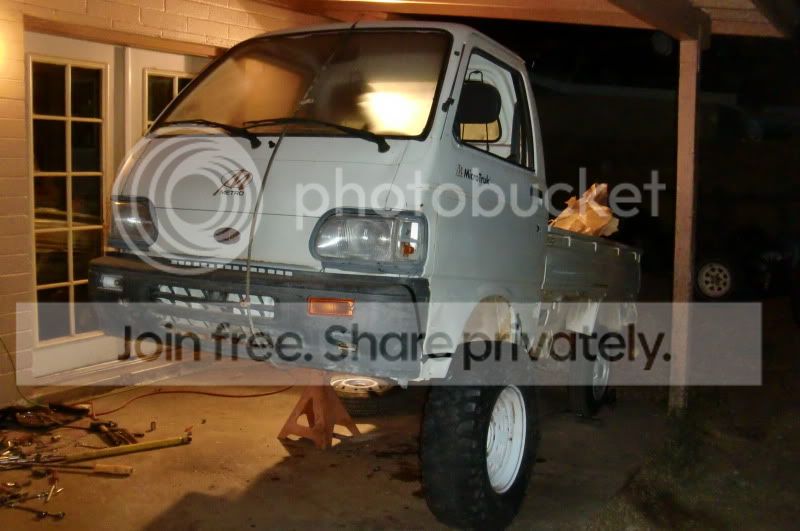

Also ripped the front suspension out of the Korean mini truck and picked up a sami that will donate its axles, steering box and drivelines.

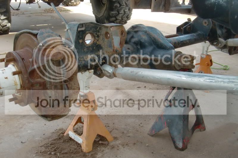

Today woke up and decided to mount the fuel tank, abs manifold, do some more paint and take a look at my front axle..
I then got out my cut off wheels and was about to go to town on this dana 44 and get it ready for some new leaf perches when I sat back and thought hmmmmm
Went to the back yard and grabbed a couple link sitting around and started playing, :doah: Might just link it now:pimp:
Also thinking about 37's and some hutchinson or h1 beadlocks now too:pimp:
That looks like a d44, Are you sure that will hold up?
Better go find a HP 60 before you get too far.
Yes its a 44, plan was to stay with just 35's and run a 44 till I came across a good deal on a 60.

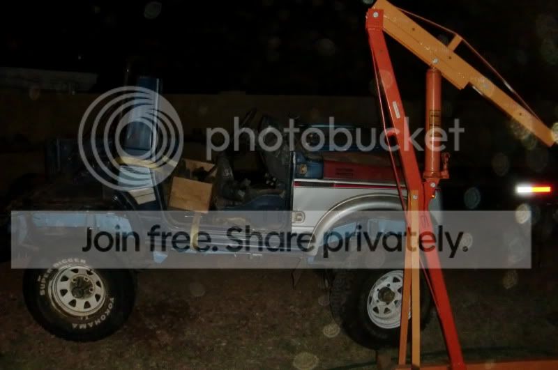

As for the jeep it is the neighbors , replacing the spiders gears in it, new radiator and getting the driveline fixed. I have no issues helping the neighbors as it keeps them happy and they don't bat an eye when I work on things:thumb:

Jealous! That mini truck idea sounds legit. Will be watching, wonder if it would be feasible to rig on with Toyota running gear?
