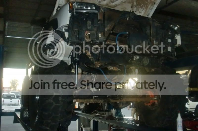

He replaced 1 out of warranty and to be nice, but we just had to swap out the case that I broke and a new input. Then when I blew up that one I REALLY killed it.. The pocket is crying but its worth it I think. Ended up doing a shift kit, some redlines some anti walk bearing or bushing thing and some lucas trans fluid to fill her up.

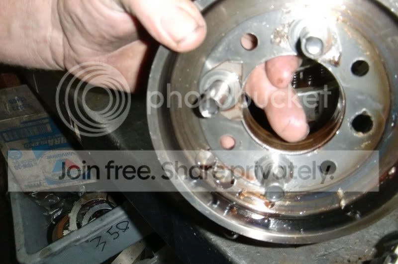

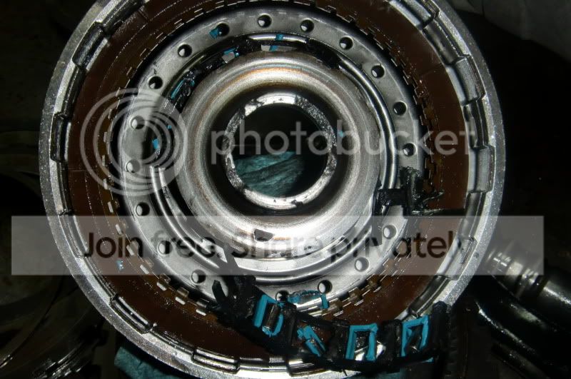

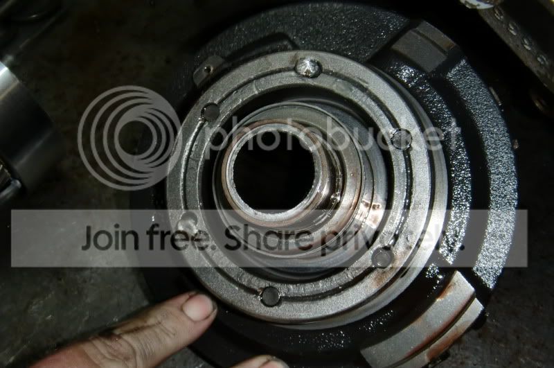

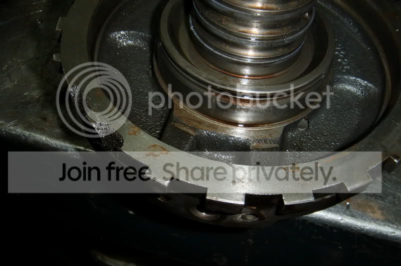

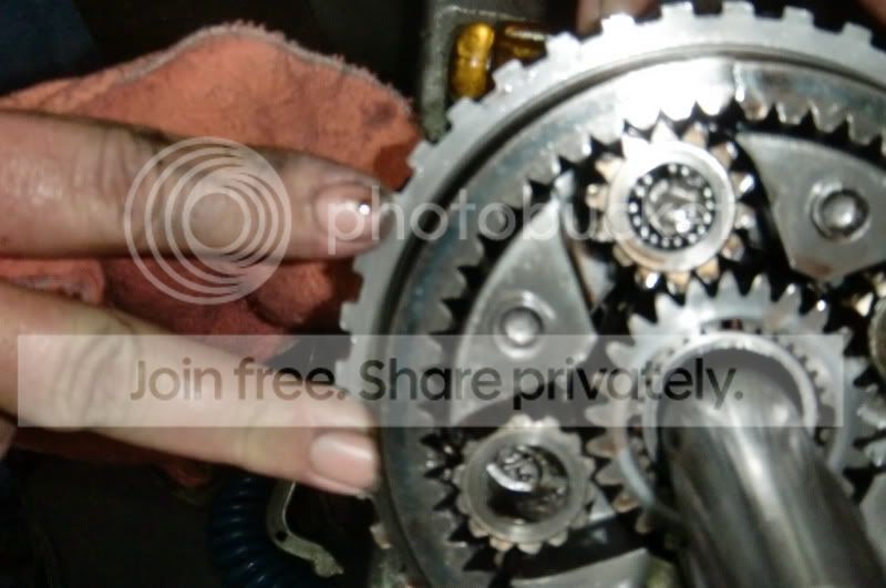

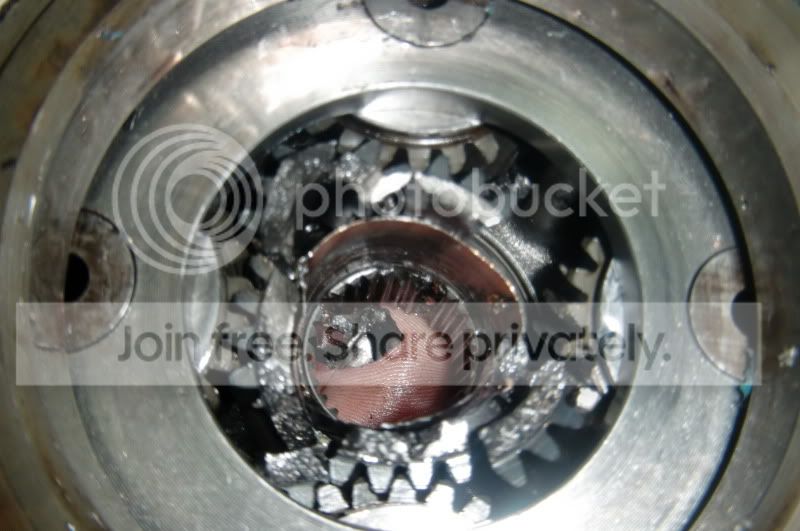

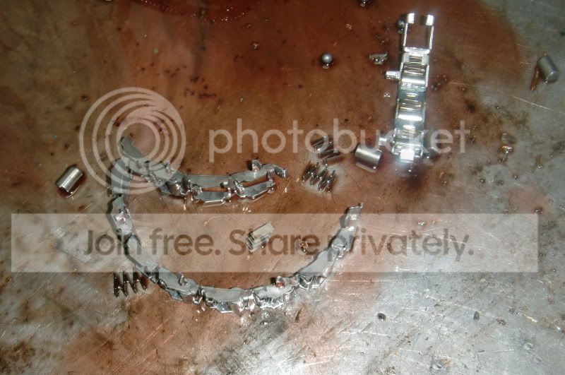

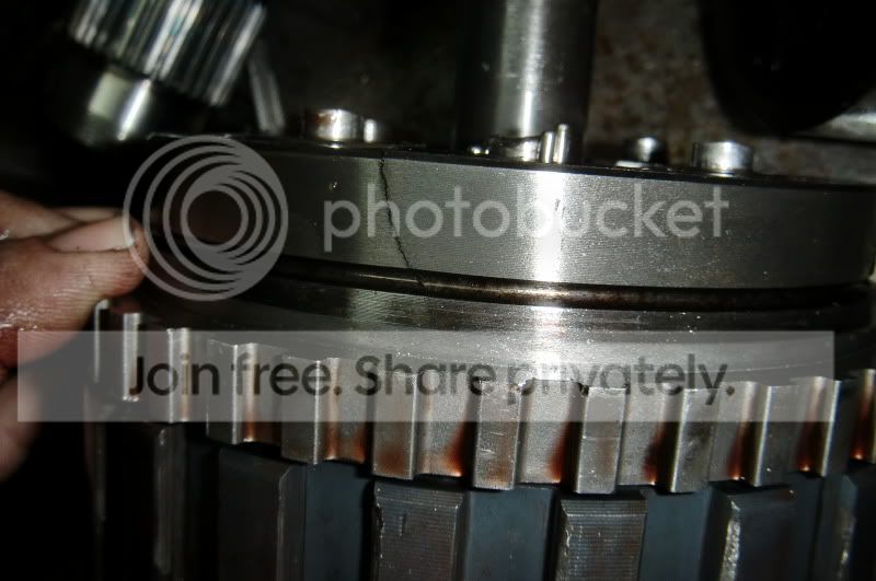

here is the parts from the last one we took apart today to build.. wound up having to replace some parts from another one of my cores:eek1: The pics are from the trans that was locked up and I had to yank the truck off my trailer with my dads D-max.
input shaft..
1 of the 2 sets of planets
sprag
pretty crazy stuff, no wonder the truck was locked up:haha:

Well, the 400 has the same low roller clutch and planetaries as the busted-ass ones you posted pics of above. They also have a MUCH weaker intermediate sprag unless you replace it and the direct drum with the 4L80E parts.

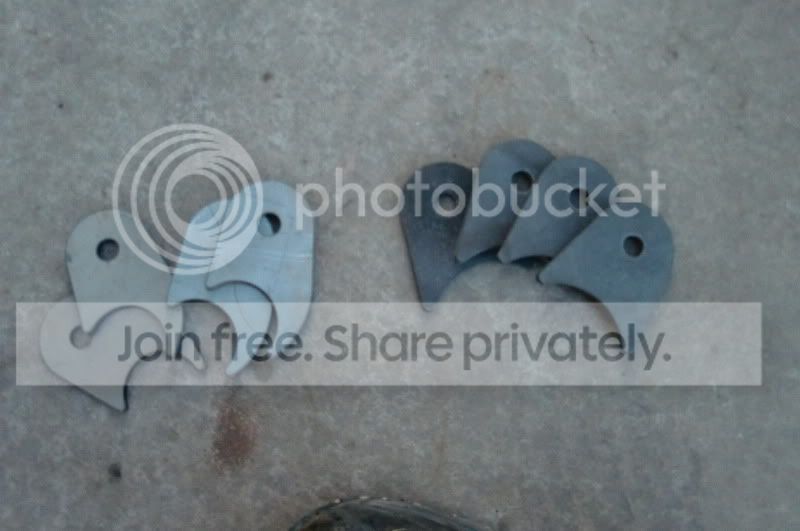

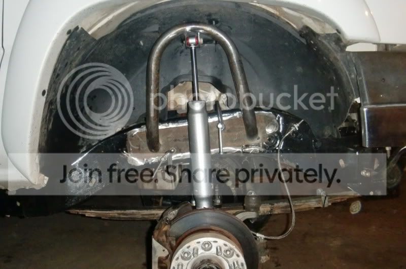

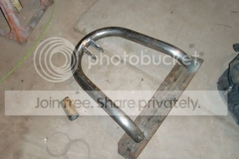

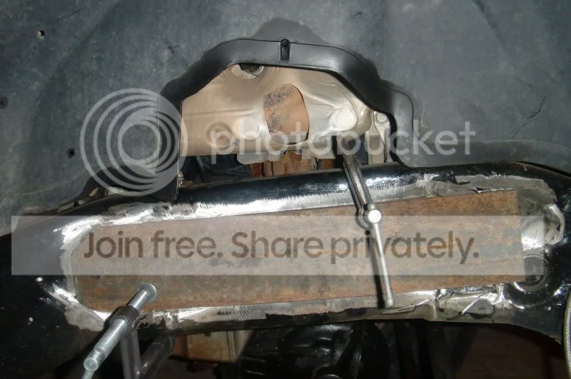

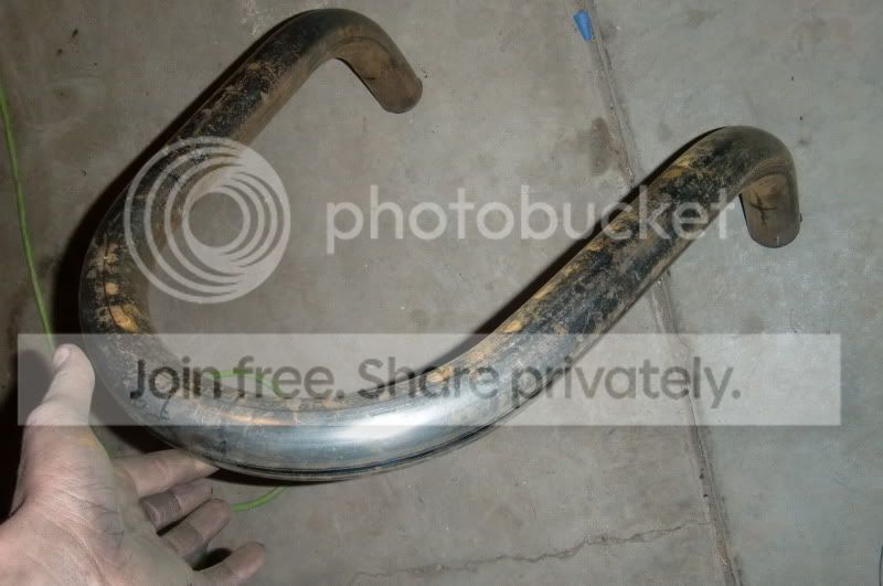

Its 4 am and I am loosing steam. Earlier managed to get the hoops figured out, cut and the plates made. Passenger side is welded on and I decided to change the shocks too, these are about 2 inches shorter than I want.
plus this
plus this..
plus this..
is
