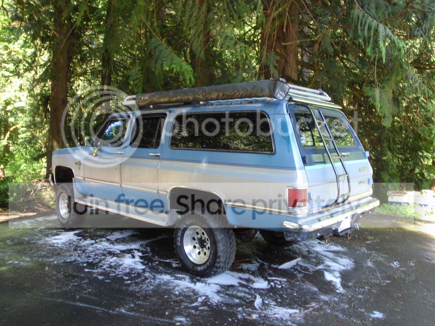

time to tie the rack down

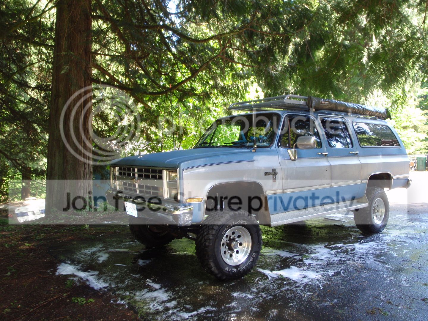

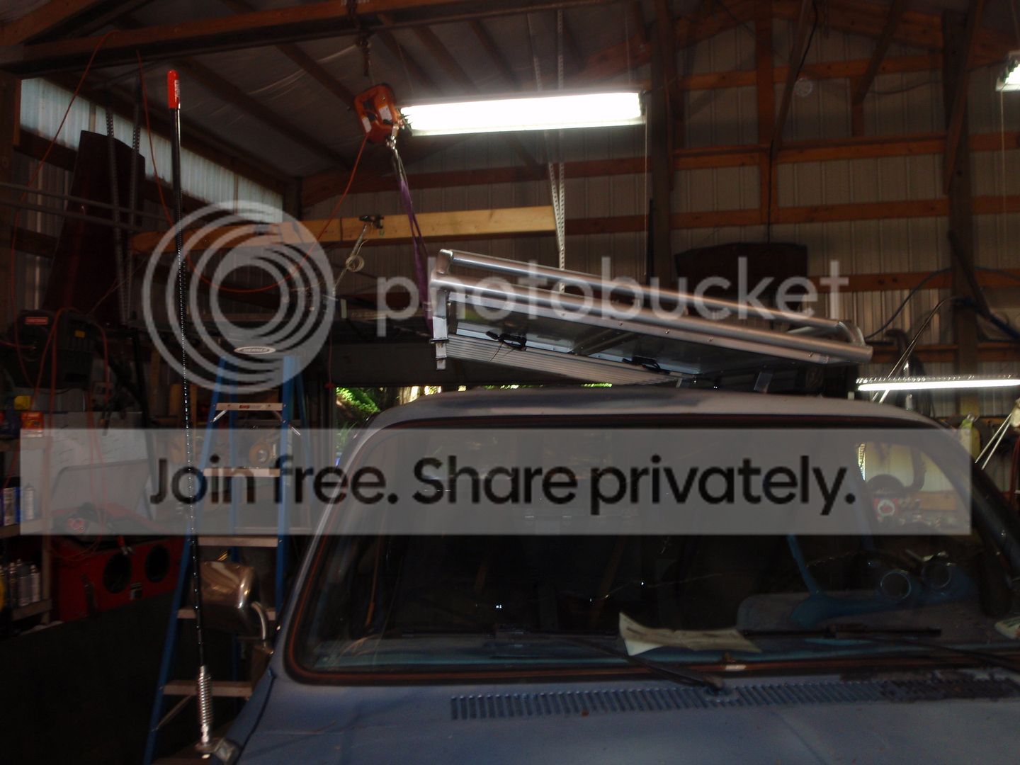

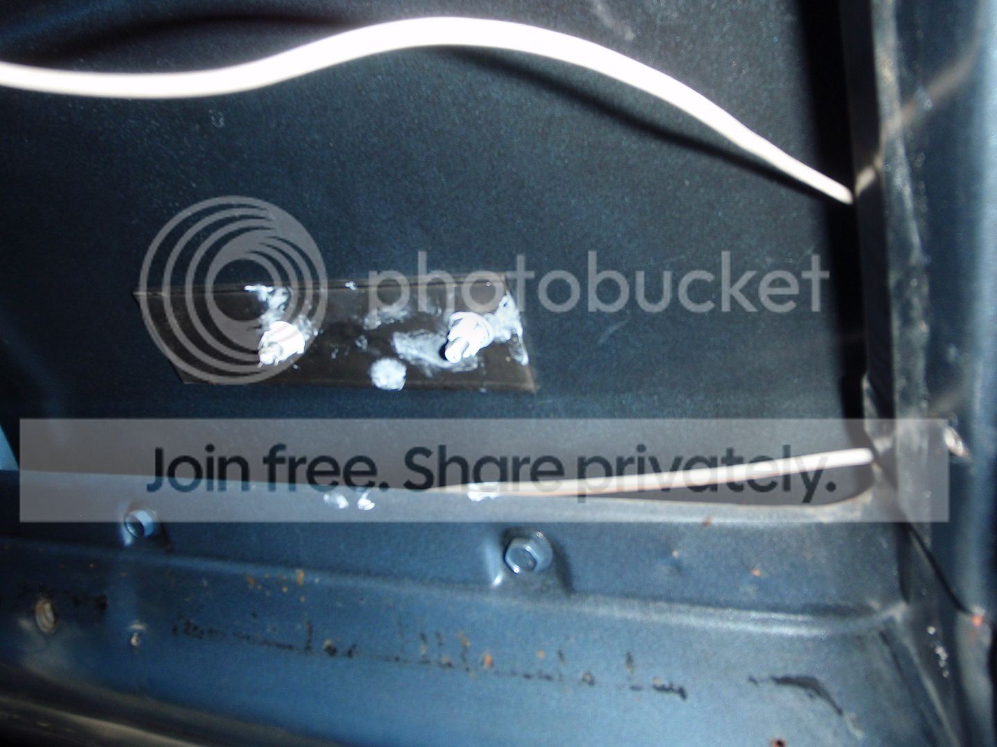

lift, drill holes, put rubber seal on, then vulcanized rubber caulking, then 1/4" washers or plates under then bolt down...
I have such a love/hate relationship with this Warn lift. It has the strength of 10 wet noodles, but it is pretty handy when it works

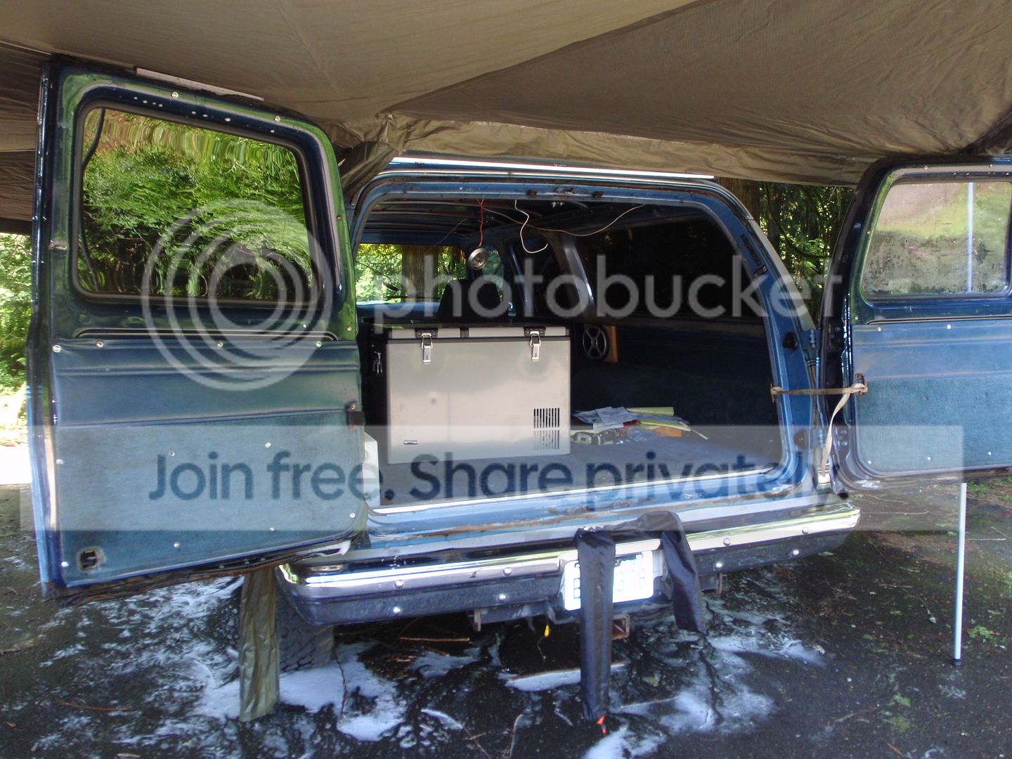

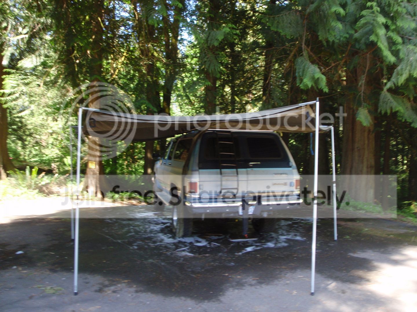

now I can test the awning (and give the truck a much-needed bath)

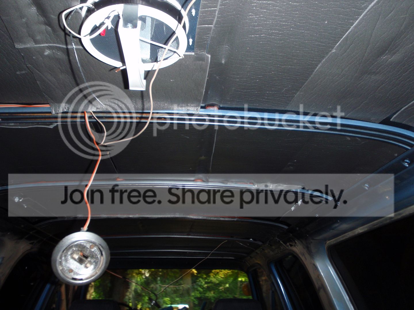

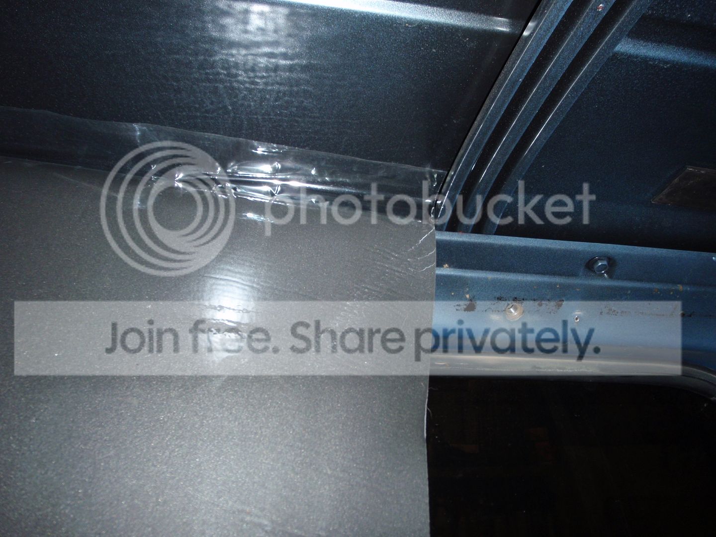

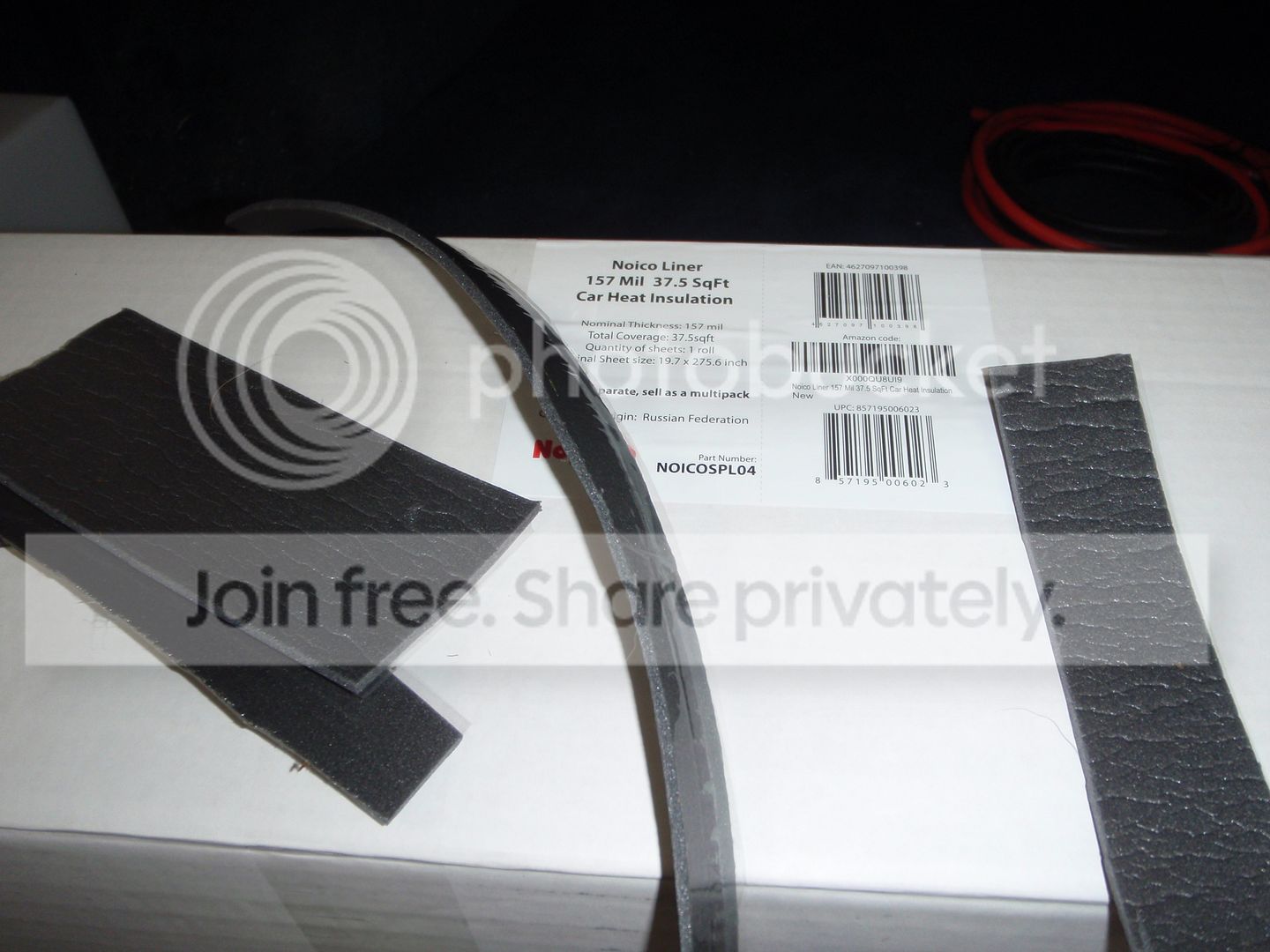

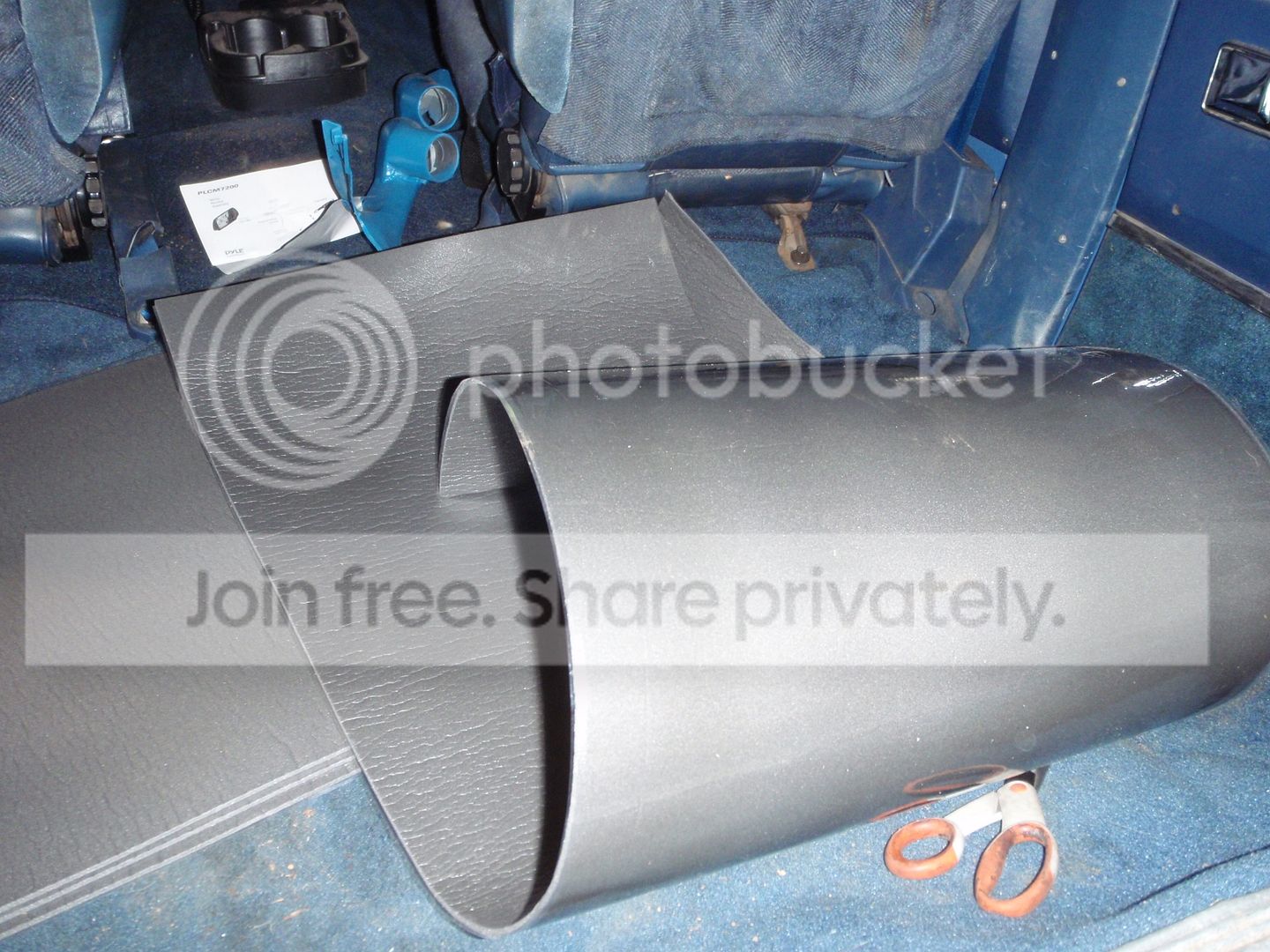

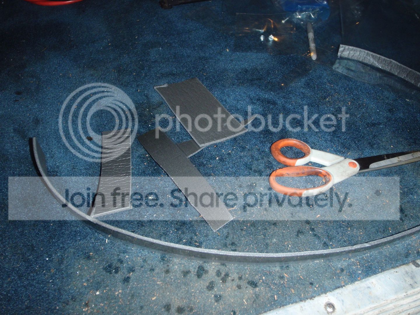

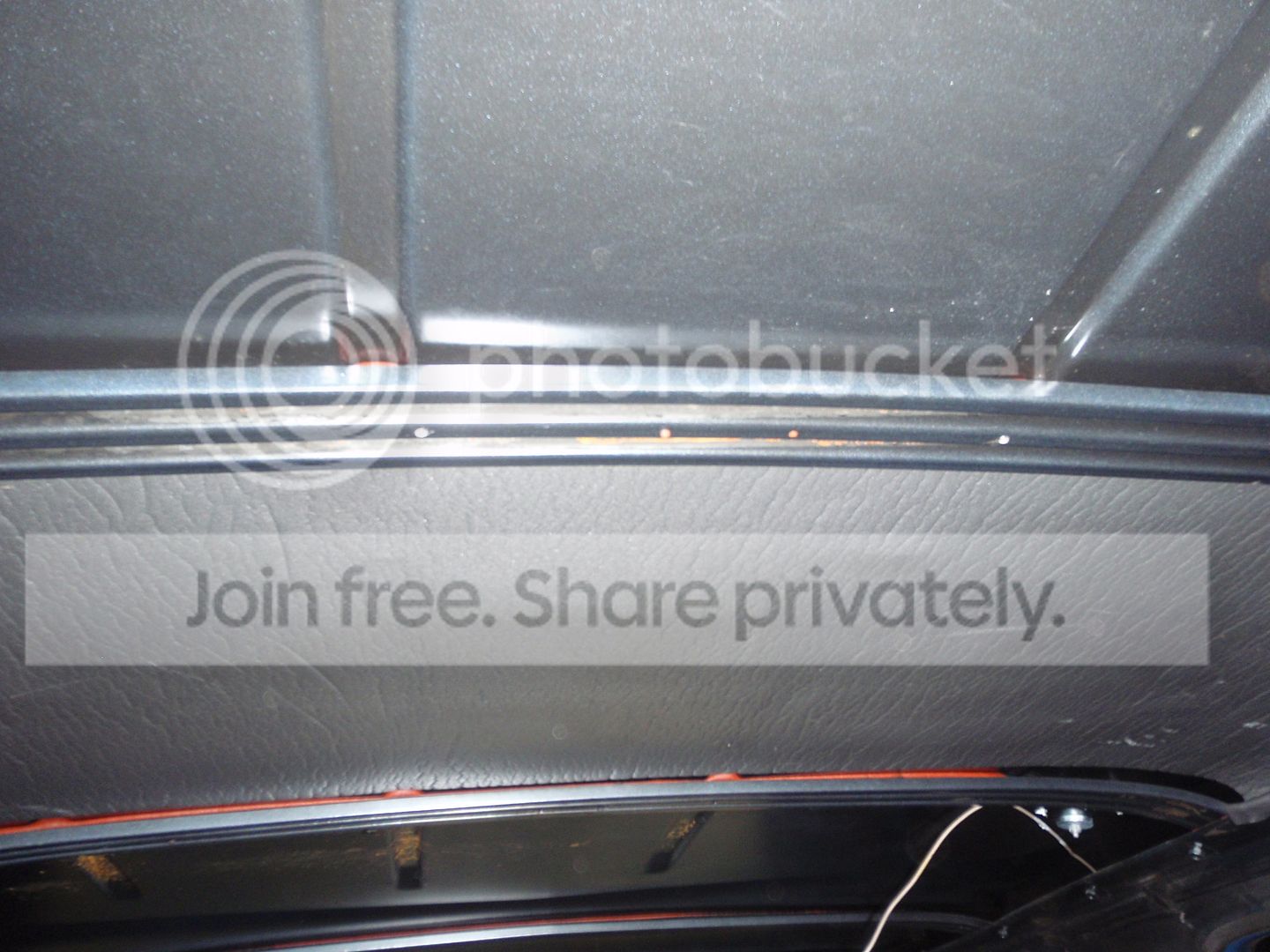

now I can insulate the roof.... this stuff works really well (well, it adheres really well.... dang)
peel the backing off and it will stick to everything
installed
60 feet and this is what was left

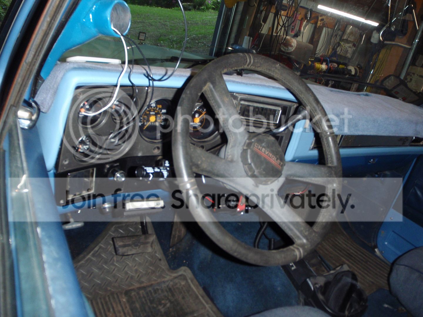

I like these steering wheels better...

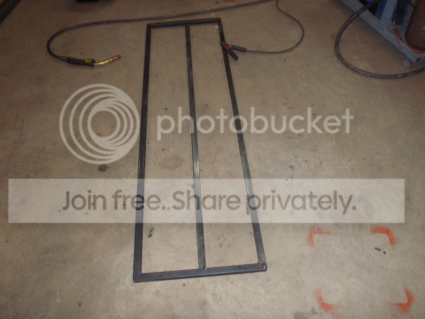

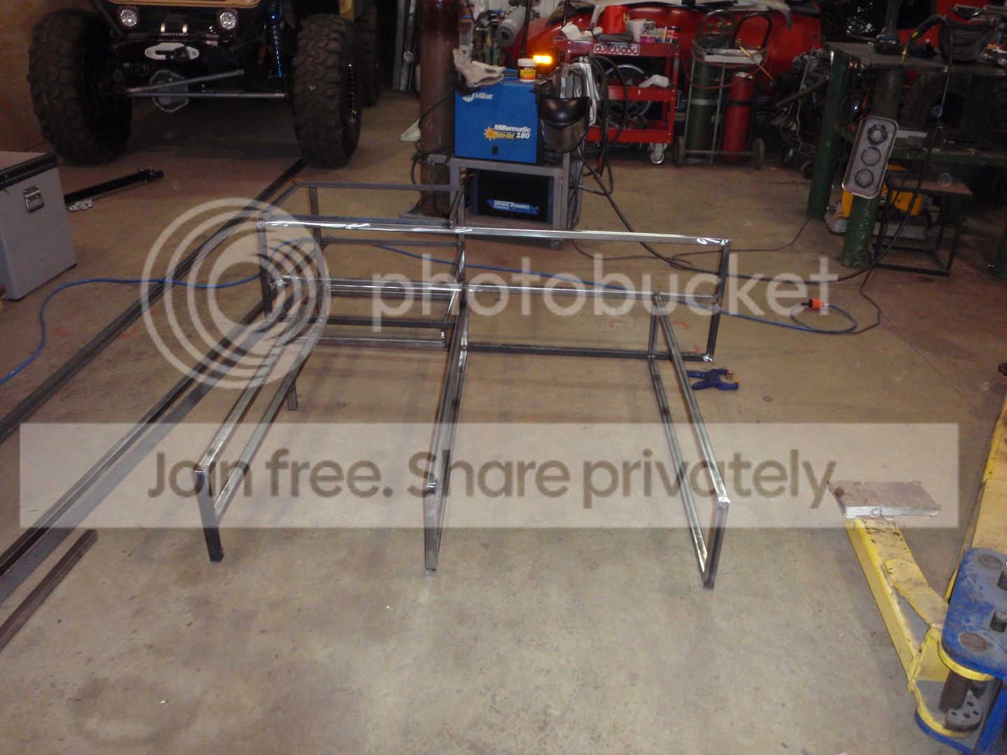

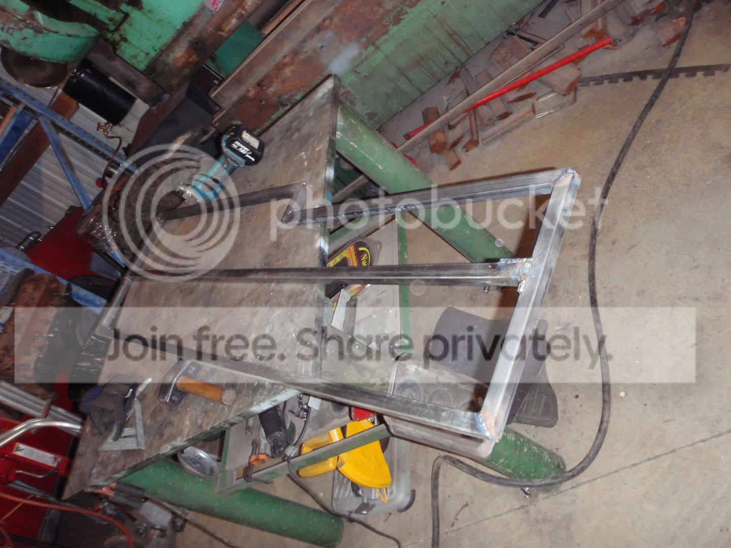

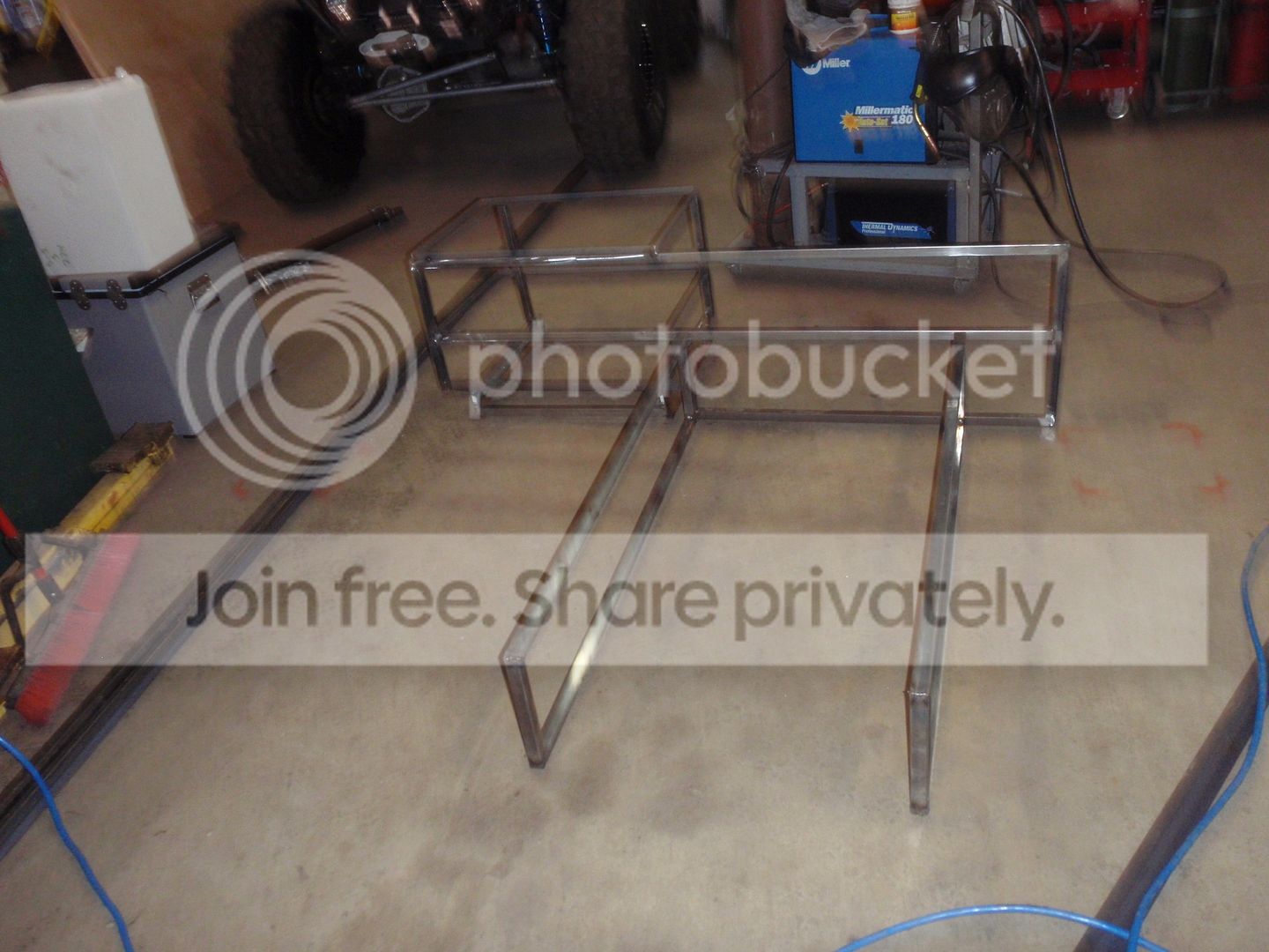

tomorrow, inner frame work
Looks great, I've got some of the Noico stuff I need to install too, but it's the 80mils. How'd you like the 150?
maybe it was the migraine last night (imagine a headache with concussion-like-symptoms), but I'm still seriously considering wiring this for 24 volts, then running a second inverter and battery charger so that if the solar panels are not keeping up, that I can plug in the battery charger to the engine-based inverter or a gas generator.... everything I have so far works on 12 or 24 volt, and the benefit of 24 volt seems that simply adding a second, 12v inverter is making more sense then it should....

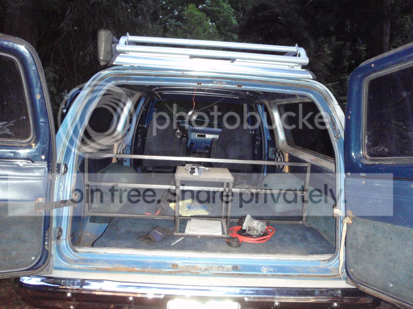

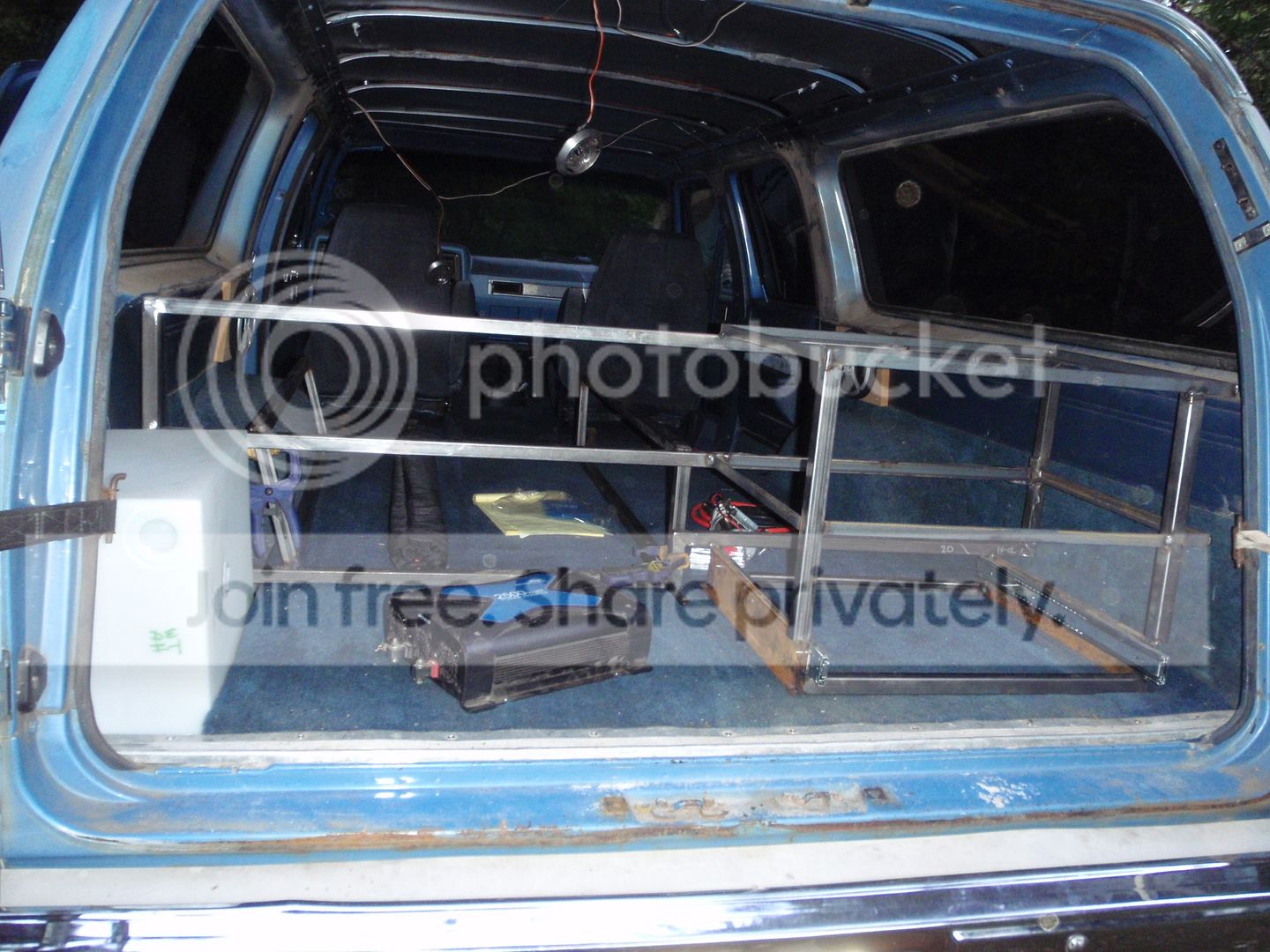

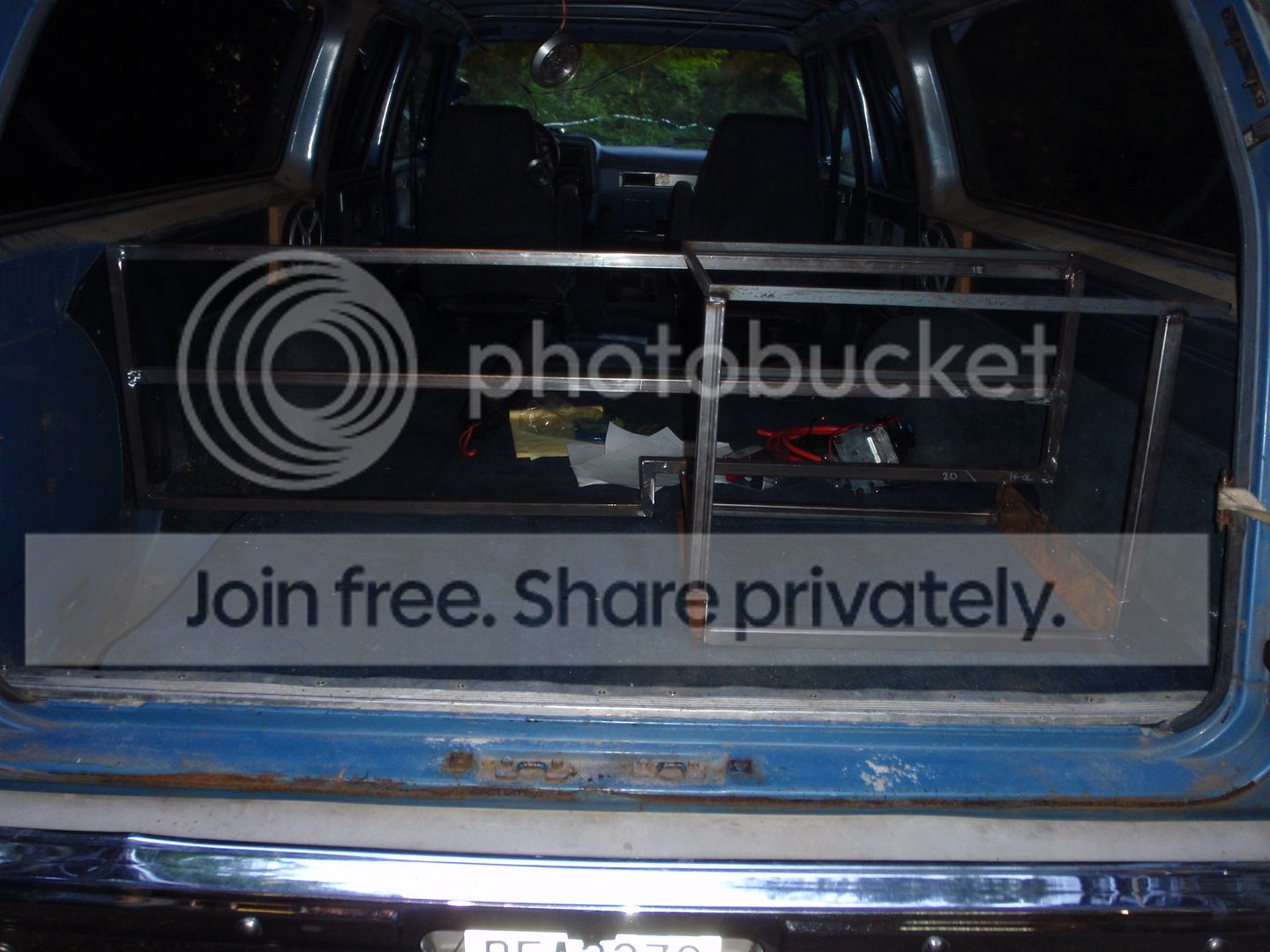

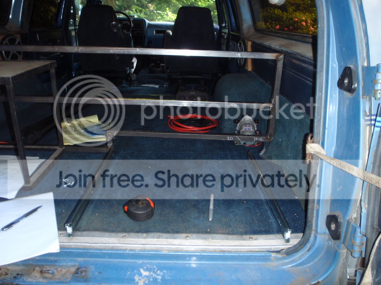

everything is built off the bulkhead so here it goes
close

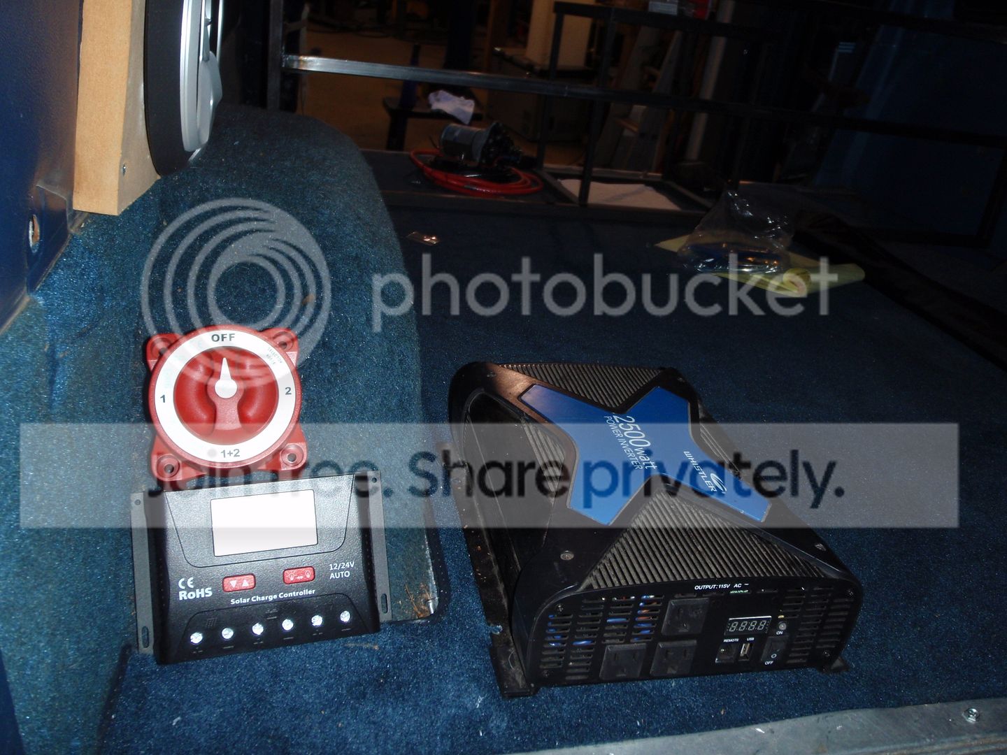

this stuff goes here (it's really close to the batteries)
notched

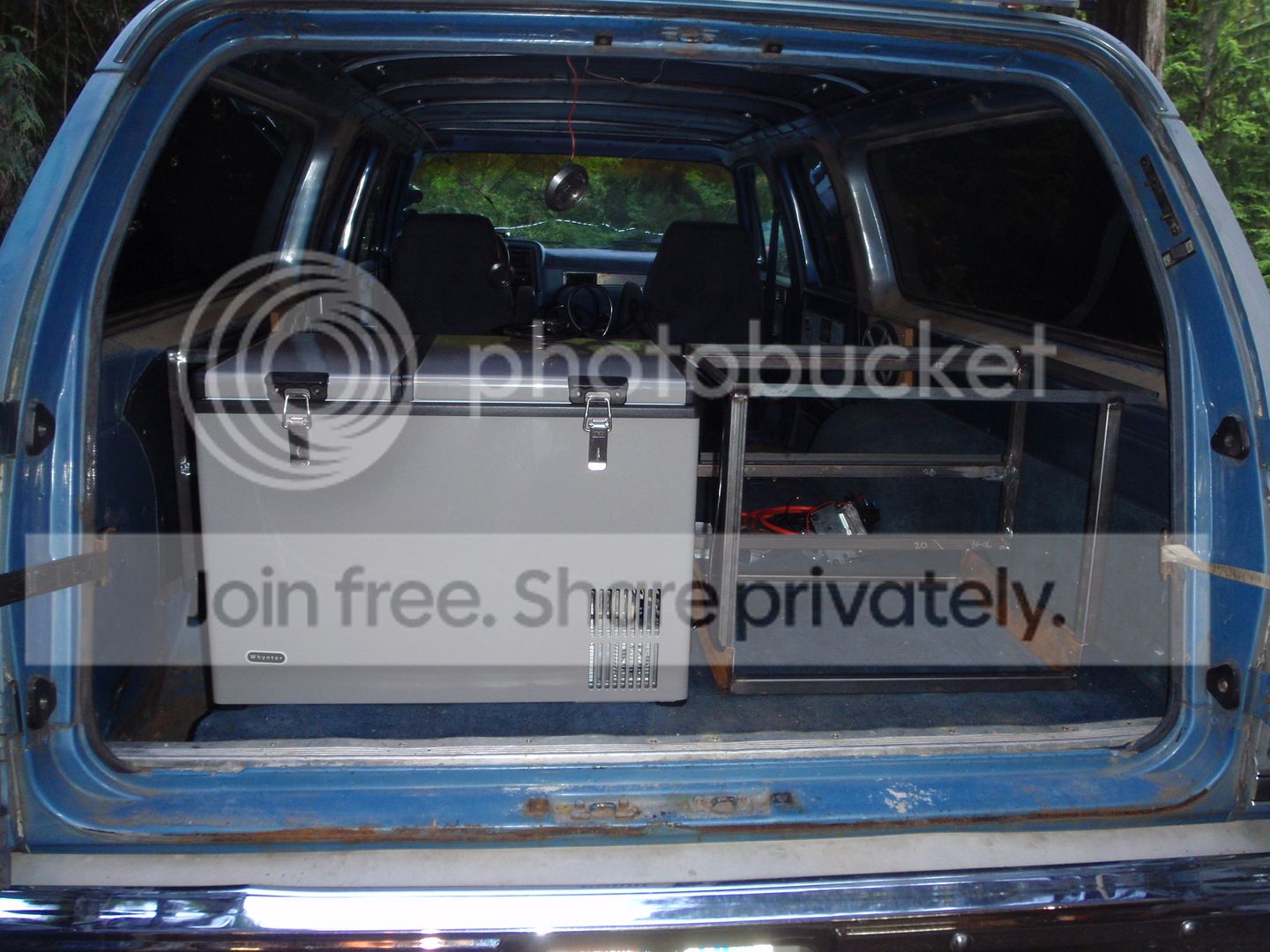

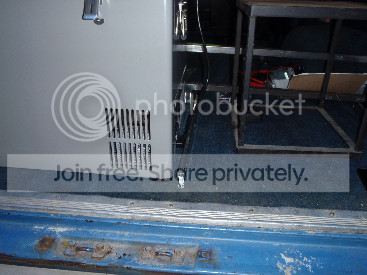

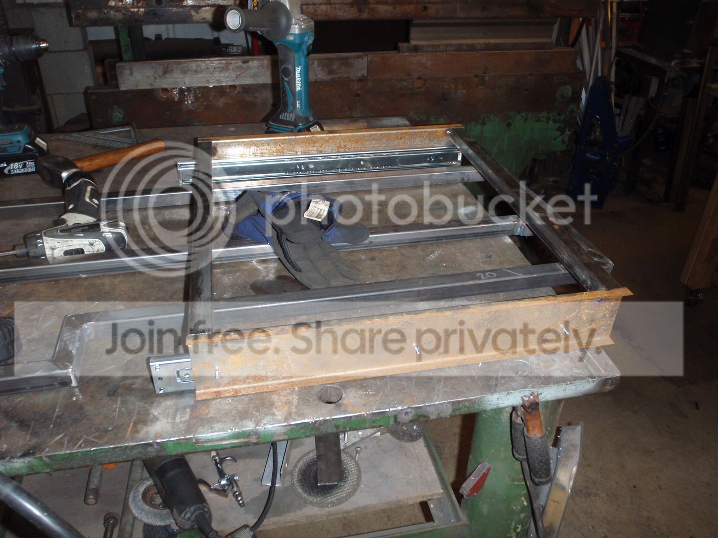

the plan is a sliding table that gives a prep surface when it slides out....
