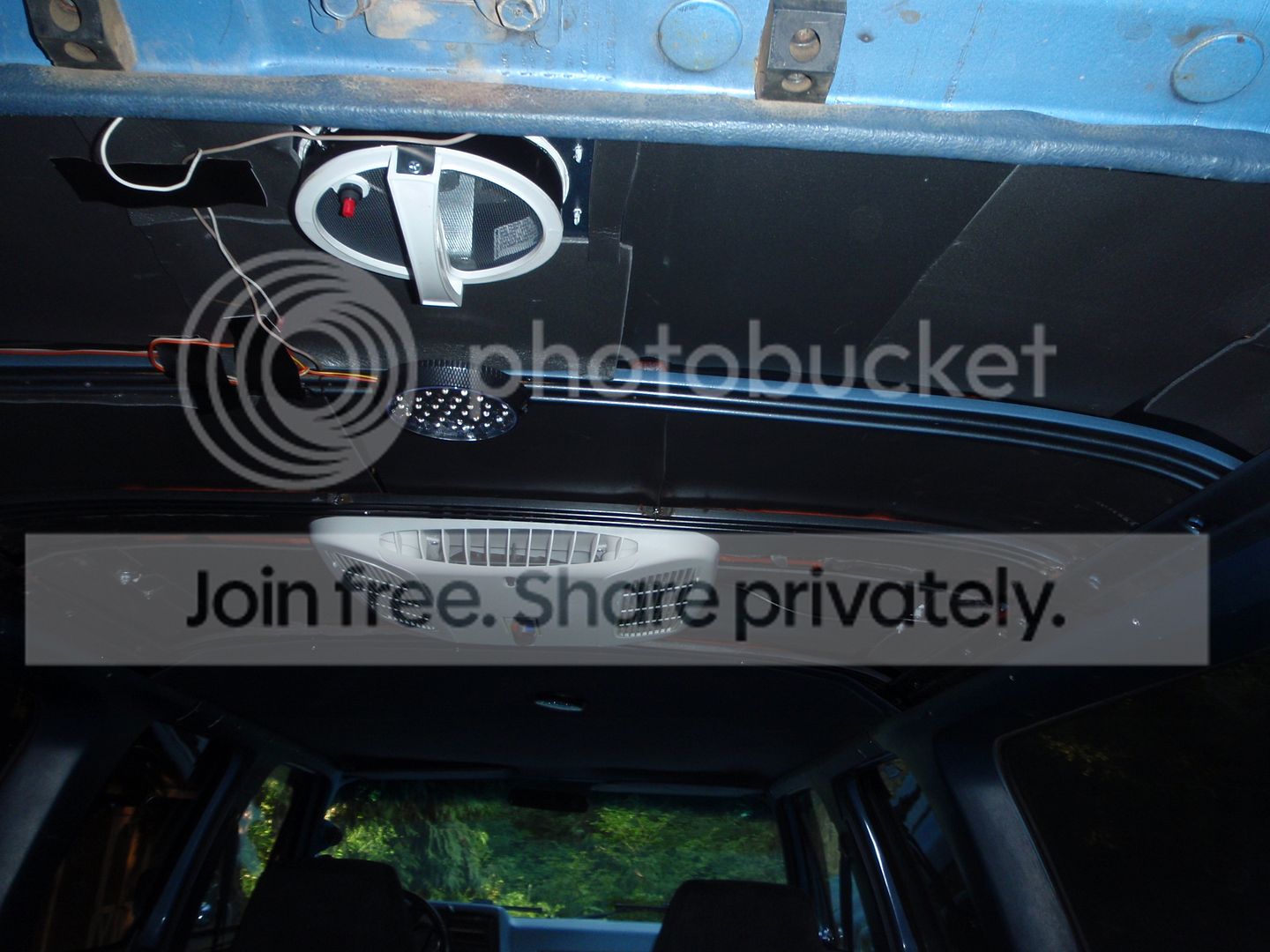

so pictures

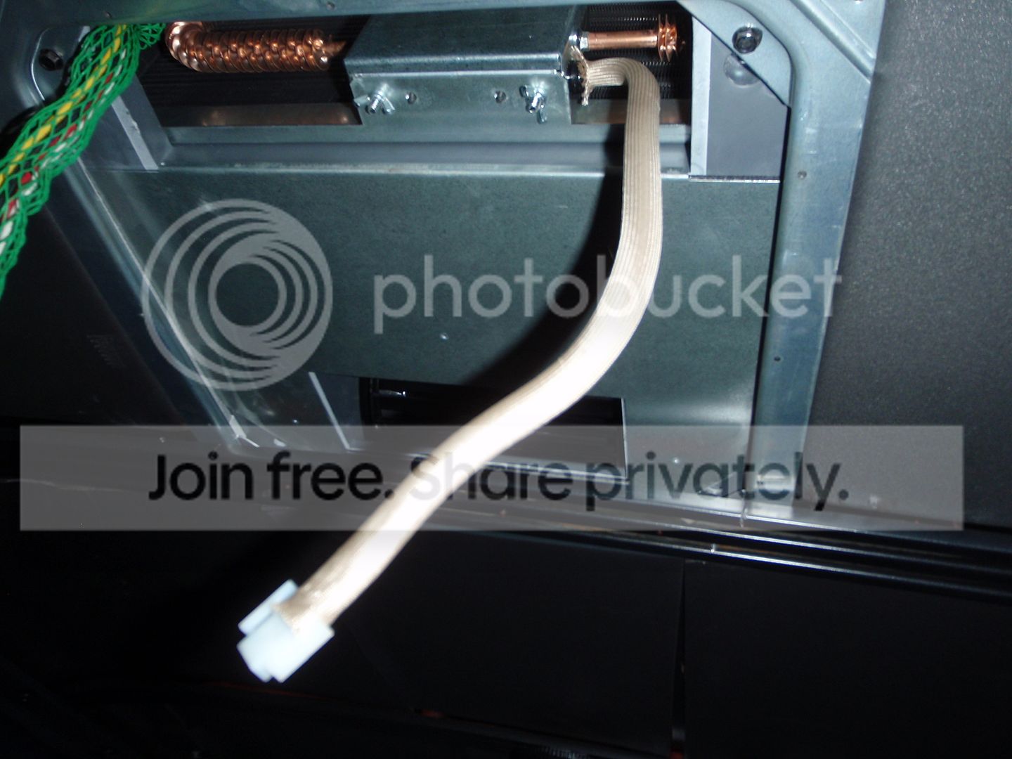

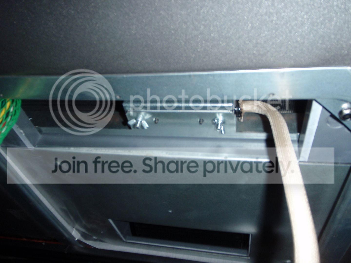

for those who want a Mach 8 with a heater, this is how it goes in - their instructions are abysmal. This picture is look from the front of the unit towards that back
another view
yes, I ran an extension cord from the unit.... as you cannot clearly see, it's drawing 1400 watts

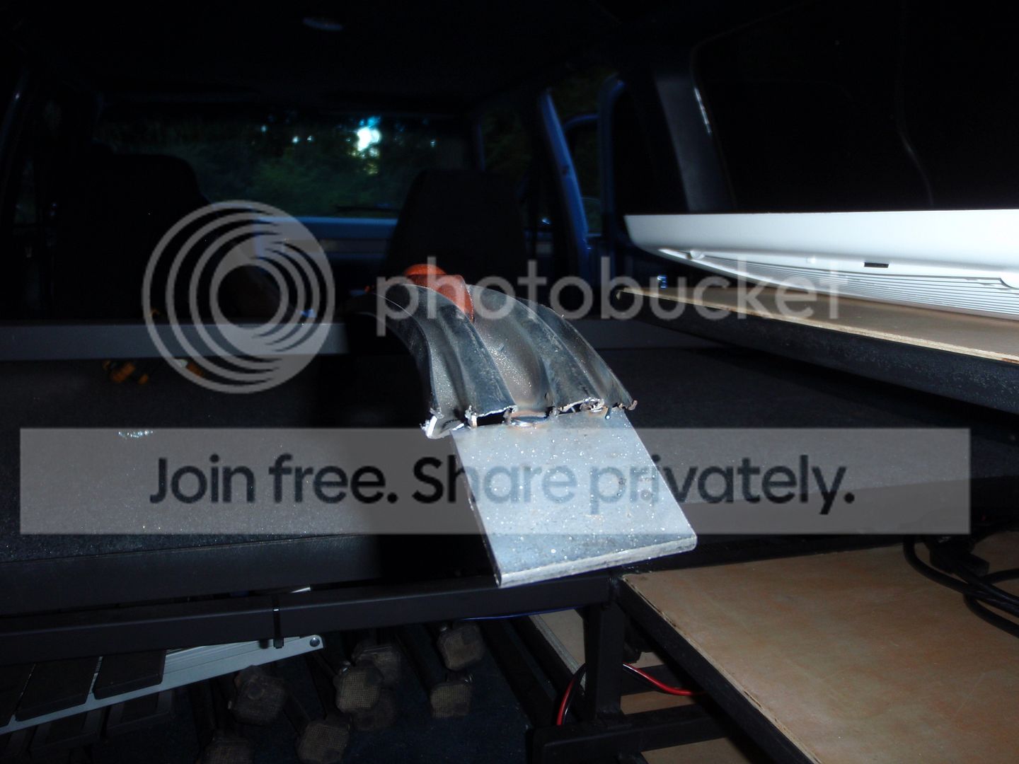

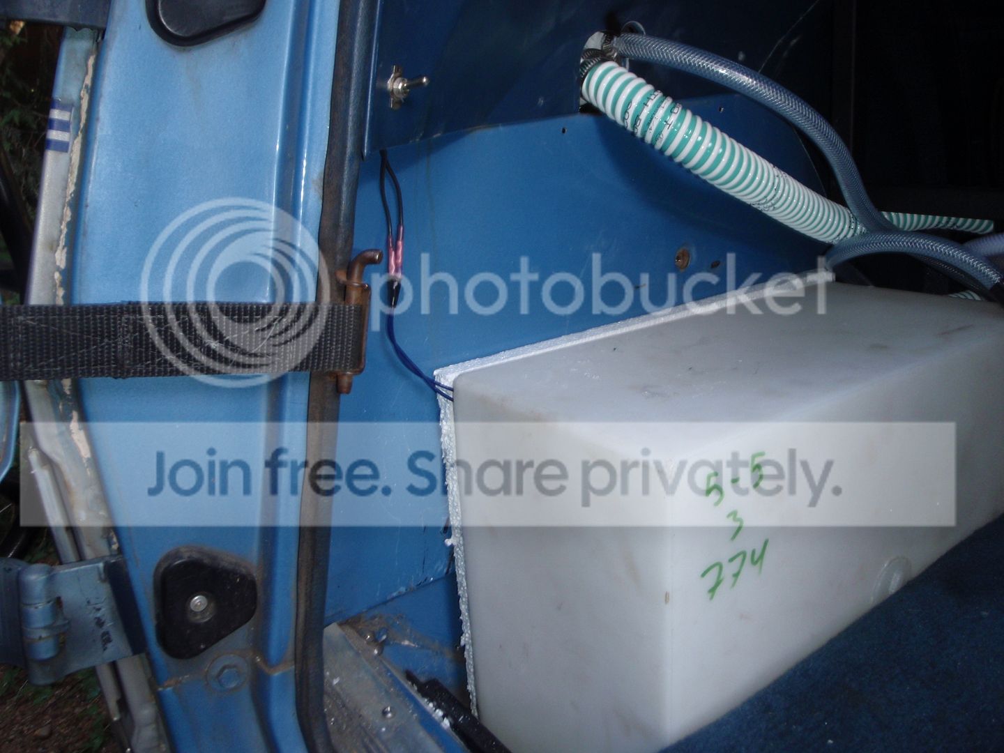

Insulated the area around the water tank
all the while running the a/c - I can't believe I'm saying this, but it was too cold inside to work... ran for 2 hours, used 27% of the battery (and had little, direct sun)
reinstalled the support

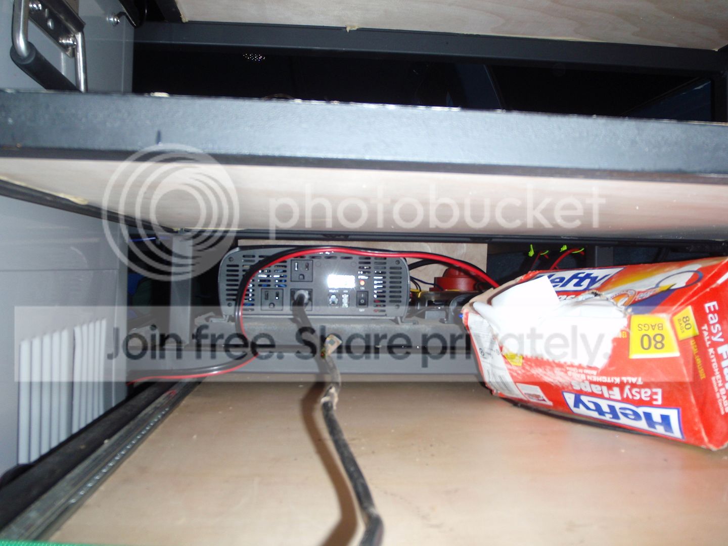

I am going to have to do something about the inverter. I was unwilling to pay for a new inverter (this one I had used in another vehicle for a couple years) on this experiment. The issue is occasionally it thinks it got overloaded (it's a 2500 watt, the max observed has been 1440 watts) so I have to hit the reset switch... problem is I can have that when dogs are being cooled... ah well, I'm far more willing to get a better, more efficient inverter now.... for those counting - it costs about as much as the RT AC ... ugh. I have Corvettes to build.

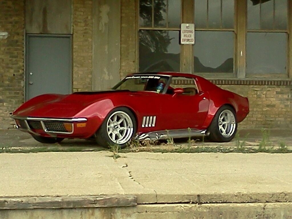

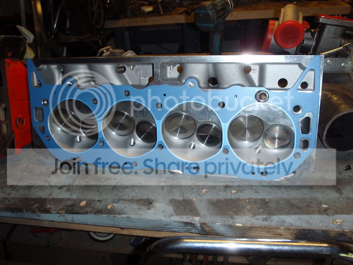

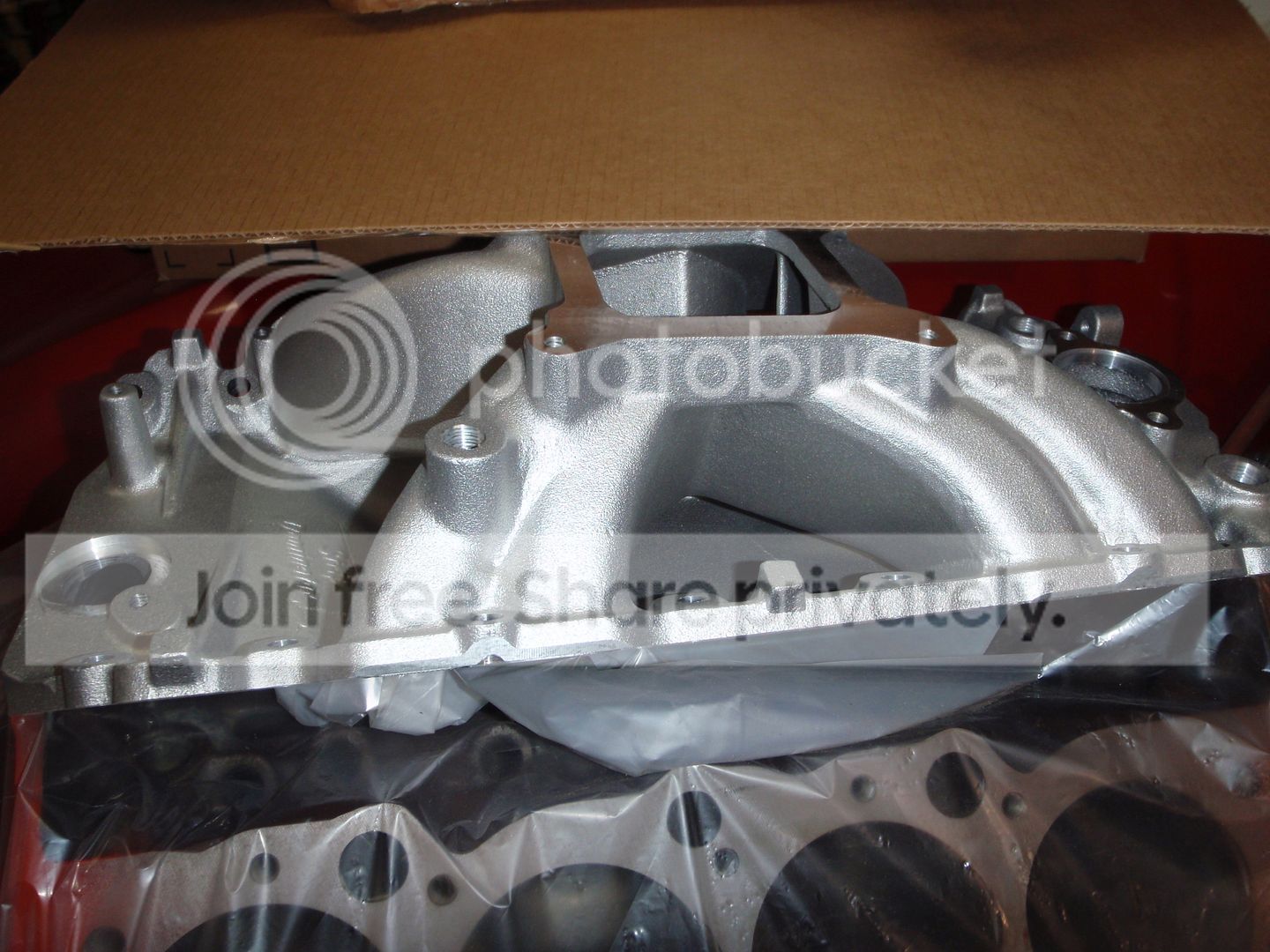

427, 10.5:1 compression, aluminum square port, ported heads, single plane intake, 850 double pumper, 4 bolt main, bottom-of-the-page cam, side pipes. about 700 hp, hopefully it'll do burnouts.
Important commercial, Corvette break.
I`m betting it will! Nice!!
that is awesome... what's in it for a motor?

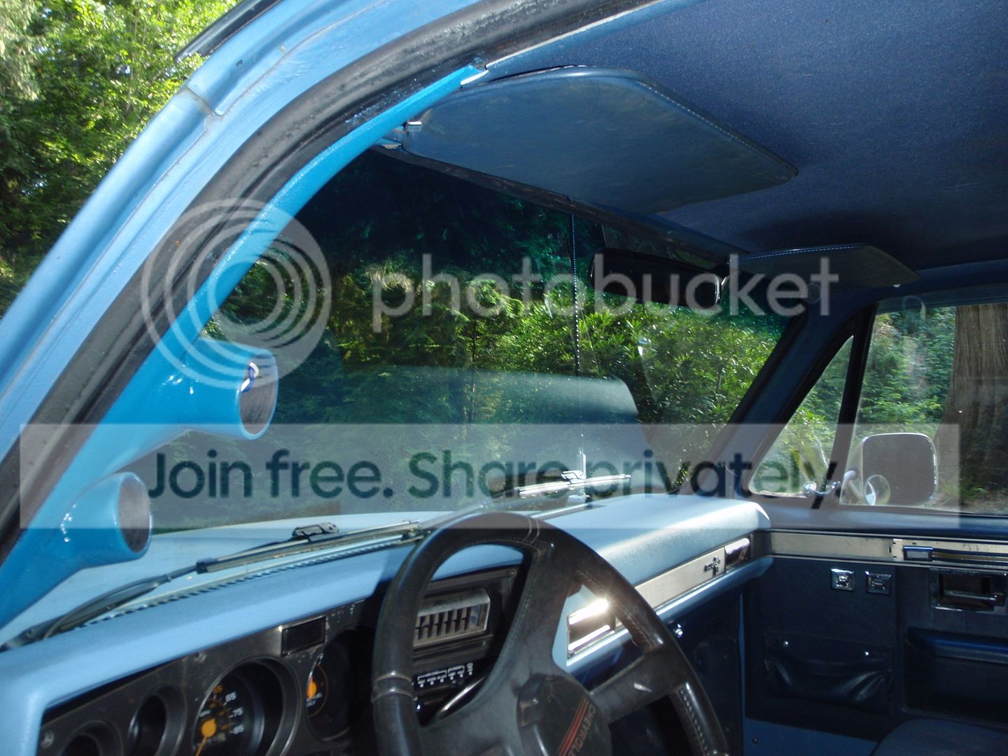

Working on my Suburban and found a Buick

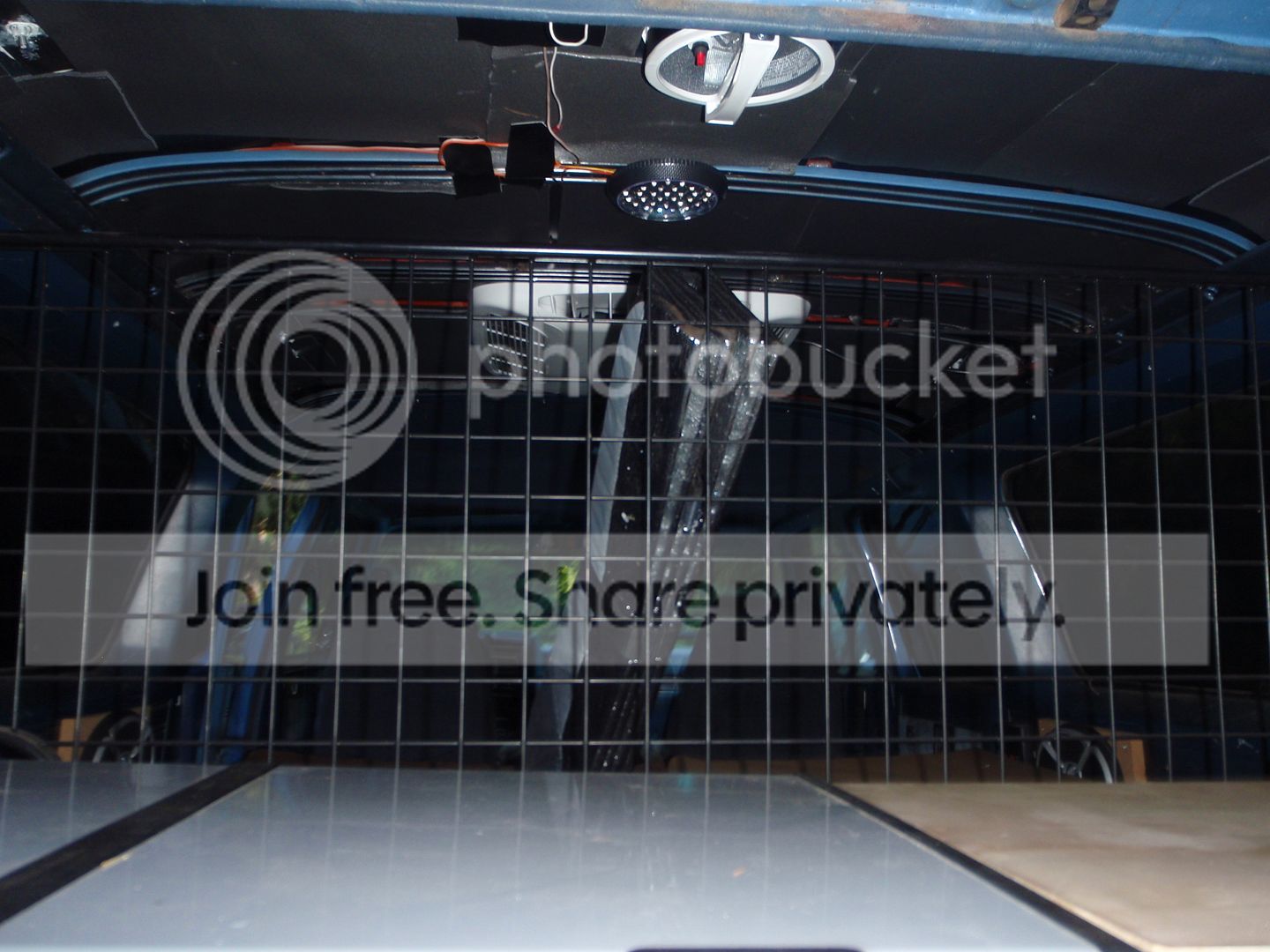

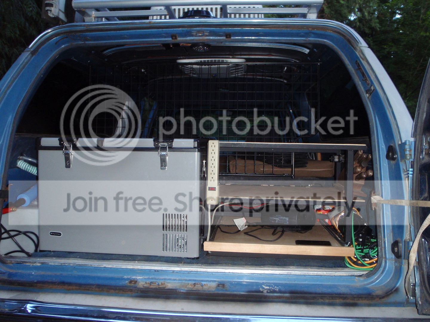

realized I didn't do a global view

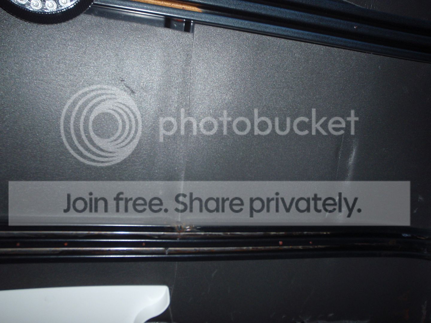

still not sure what the ceiling finish product is going to be. I could cut up the ceiling panel - but there are issues (like dogs would eat it) that I don't need...
in the protective level.... dog gate
on the front will be another gate and a divider to haul two dogs that will be removeable for camping (which is why there is carpet on one side and solid wood on the other side of those floor panels)

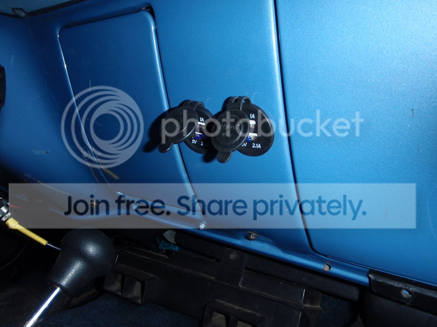

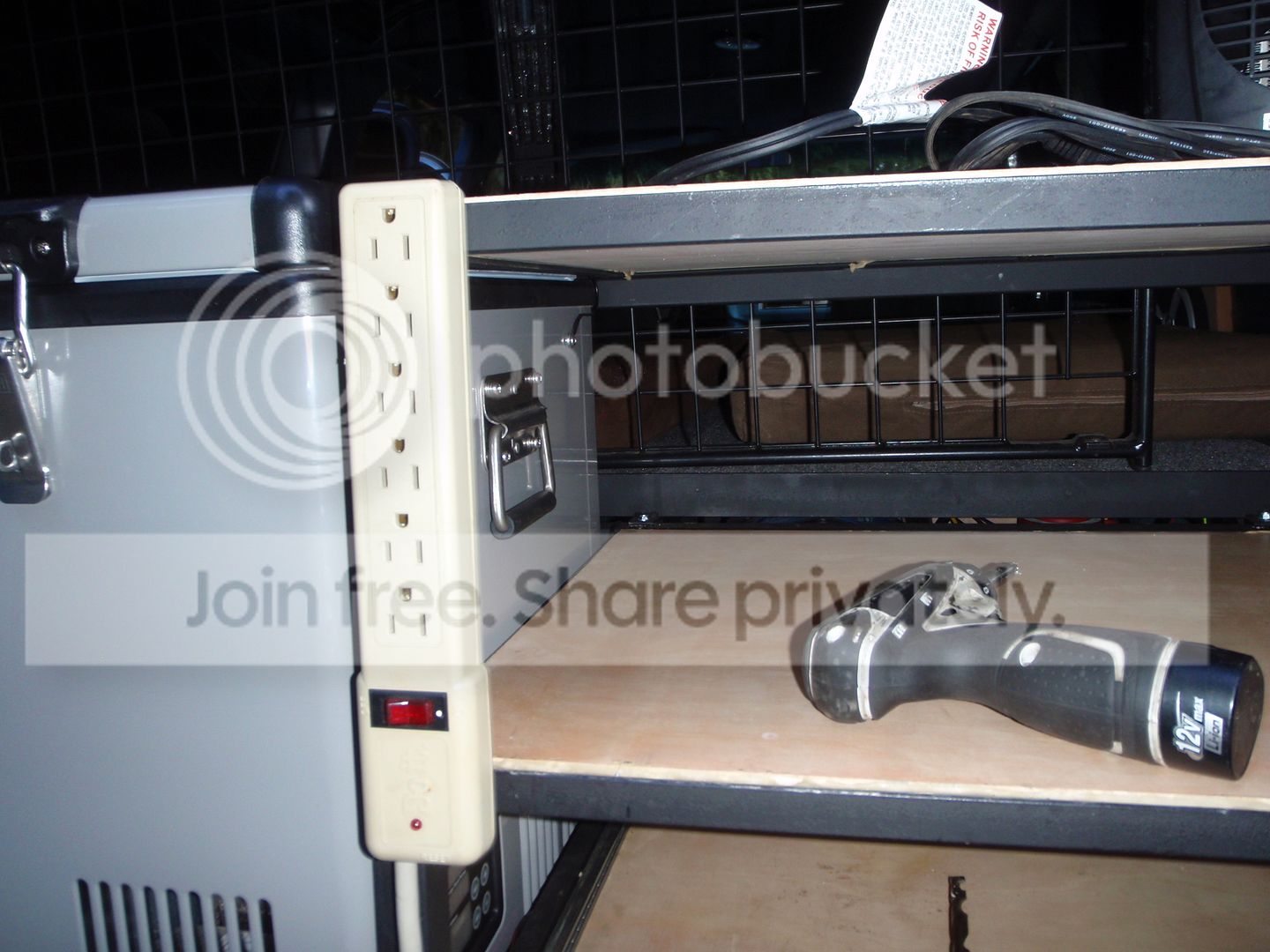

can't have enough power strips
all that is left is shelving and ways to tie down what is stowed
more power
and a way of seeing what the dogs are doing
and a outside shot.... still lots to do, but I finally feel it's useable (but the propane is next, which is frills)

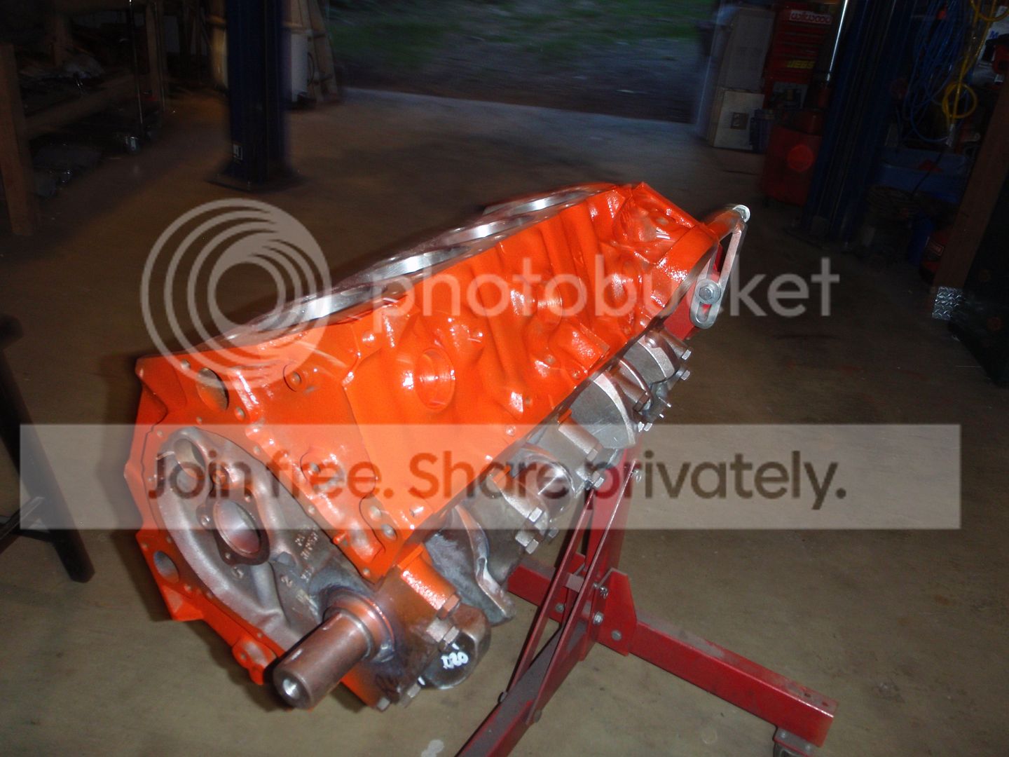

my prior Corvette. The current build will be the same color but turned up to 11. The motor in this one was a 355 SBC, aluminum heads, stupid-radical cam, 4 speed, manual steering, lowered... noisy, harsh riding, hard to drive, carb'd and the most fun I've ever had in a car...
