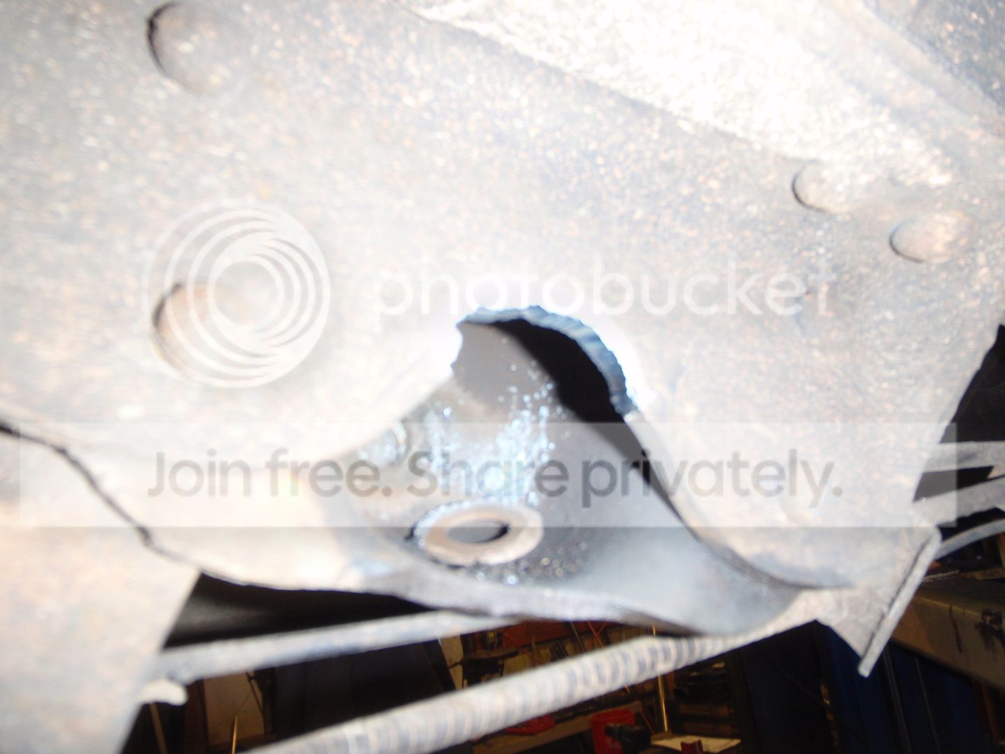

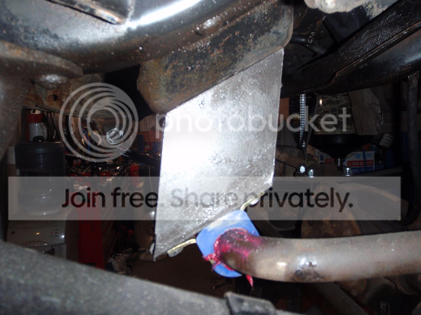

Most people frown upon dropping the tcase like that. If you do plan on keeping it dropped, run a 1"square tube instead of the spacers.
Why did you lower your transfer case?
Martin
reduce vibration by reducing drive line angle and preserve u-joints. This is a tow-rig, camper, occasional driver - it is absolutely not my off-road rig. If it were, the 10 bolt and non-float 14 would be scrap already.
*shrugs* I may weld a brace between the two washers - but then again, listening to people whine is music to my ears
:thumb:
Using those spacers incorrectly is a good way to break the frame.

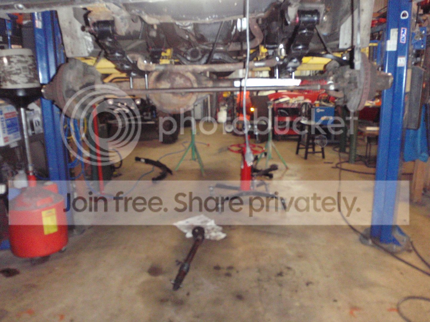

back to fun after showing off my '40 today at a car show...
riding on air
now steel

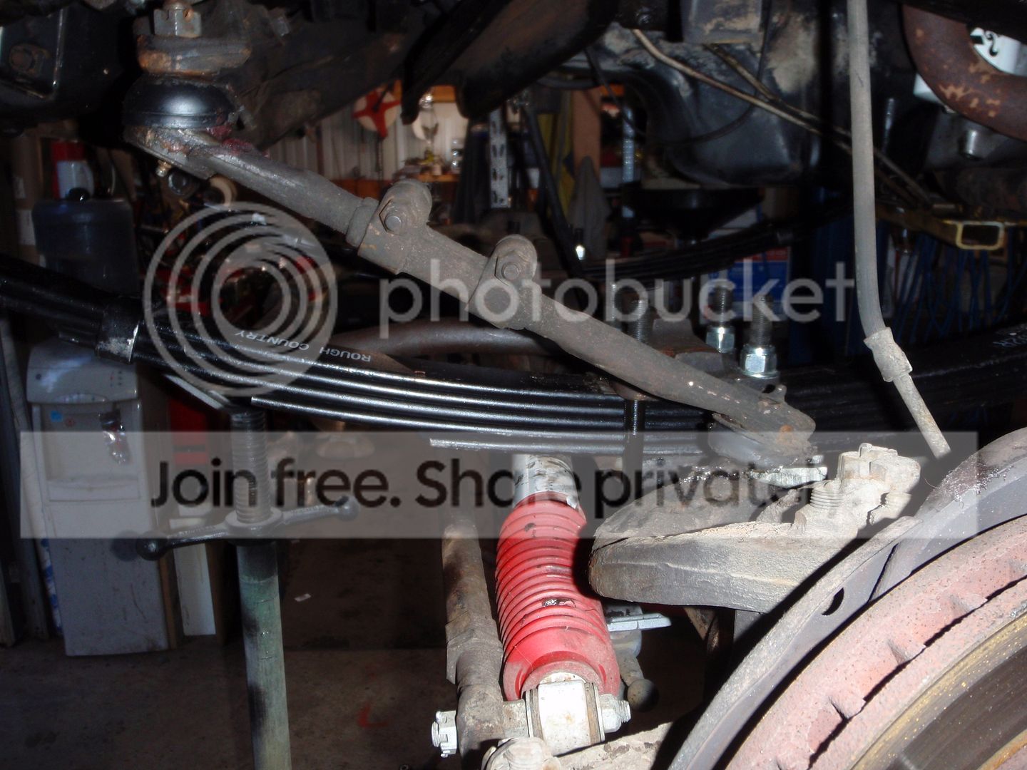

I paid someone, once, to take this off.... feels so foolish every time I do it now because it's so easy
getting there
I gave up trying to find my brake hoses... I bought a second set that I didn't use on the fj40 build... no idea where they went. I'm sure they'll turn up a day or two after I get the new ones on.
riding on air
now steel
getting there

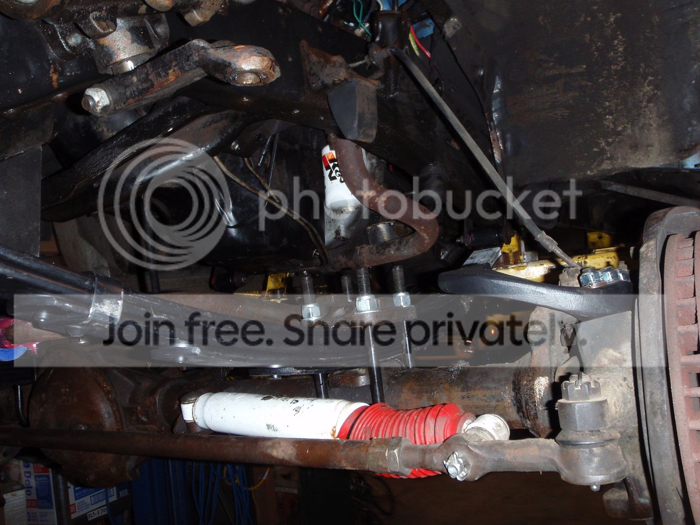

If you find them let me know, as I am in the market for some new ones.

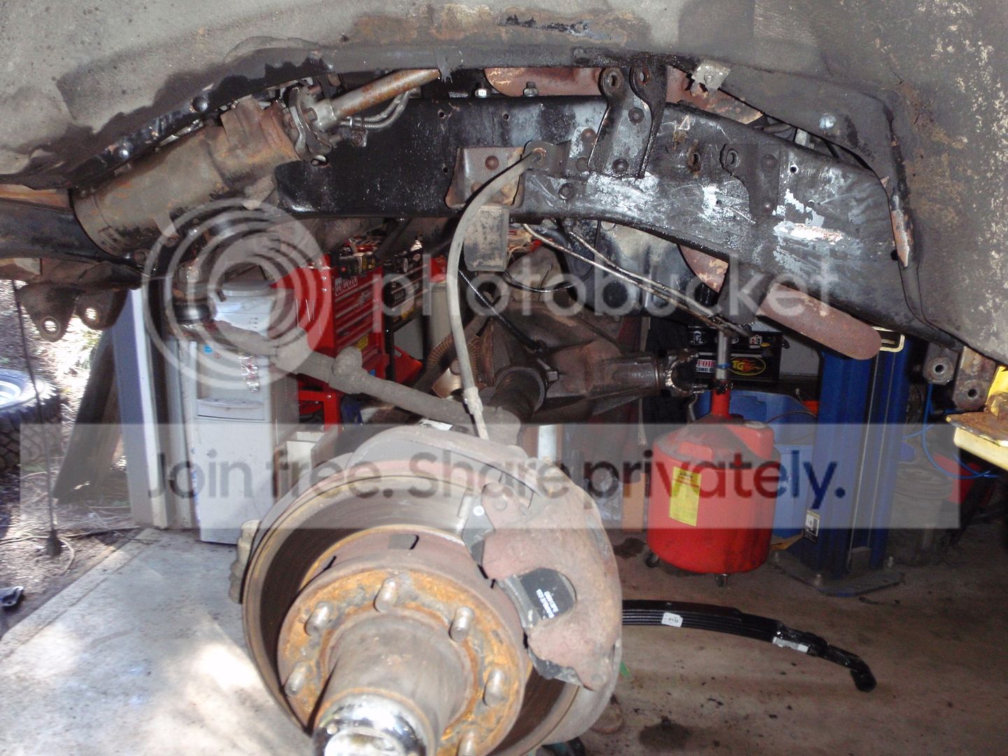

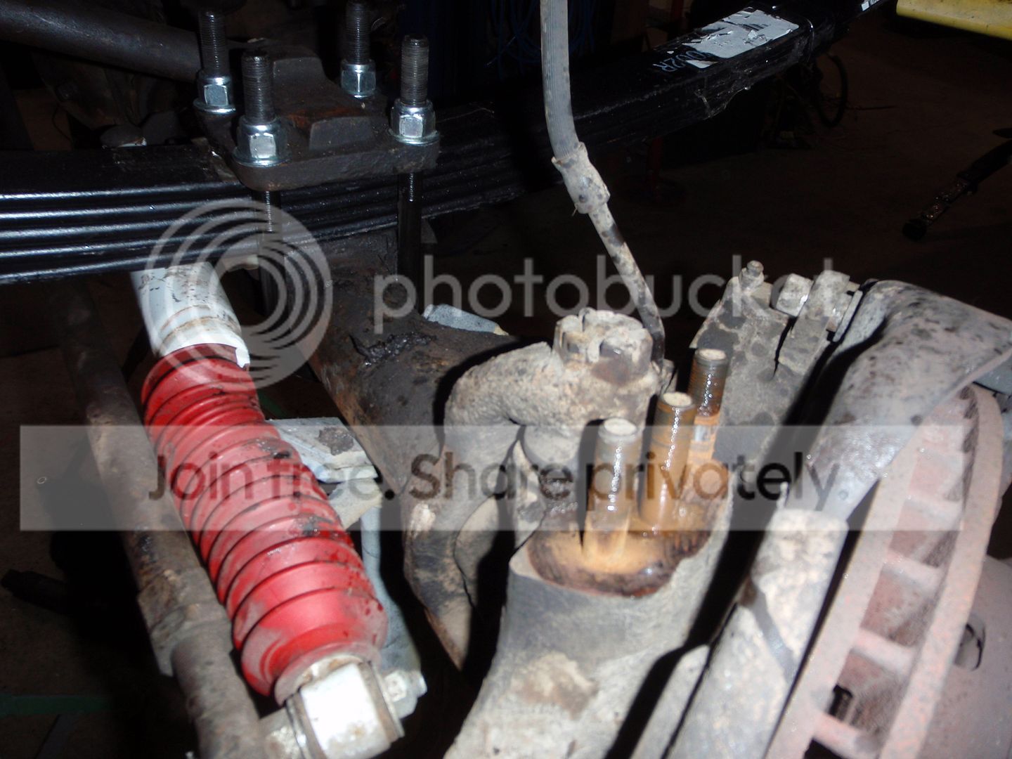

Do tell. Not that I need to do it any time soon, but as I recall it was a royal PITA when I did it last.
Take wheel off, put the axle on a jack stand, turn the wheel left, toss some WD-40 on the washers, knock the ball joint out, take the 3 nuts off, spray again with penetrating spray, hit the arm where the ball joint was with a BFH or even sledge hammer. Watch the washers, they usually loosen from the forwardmost to the back first and they don't move up much - but the second they start moving up get some vice grips or channel locks and pull the washer off. Hit until the next loosens even, repeat until they're all removed. Lift the arm off. Very rarely, the washers don't want to lift, so tap them with a drift to get them to turn a bit - once that happens the penetrating lube can get down to where it's needed and it'll come right out.

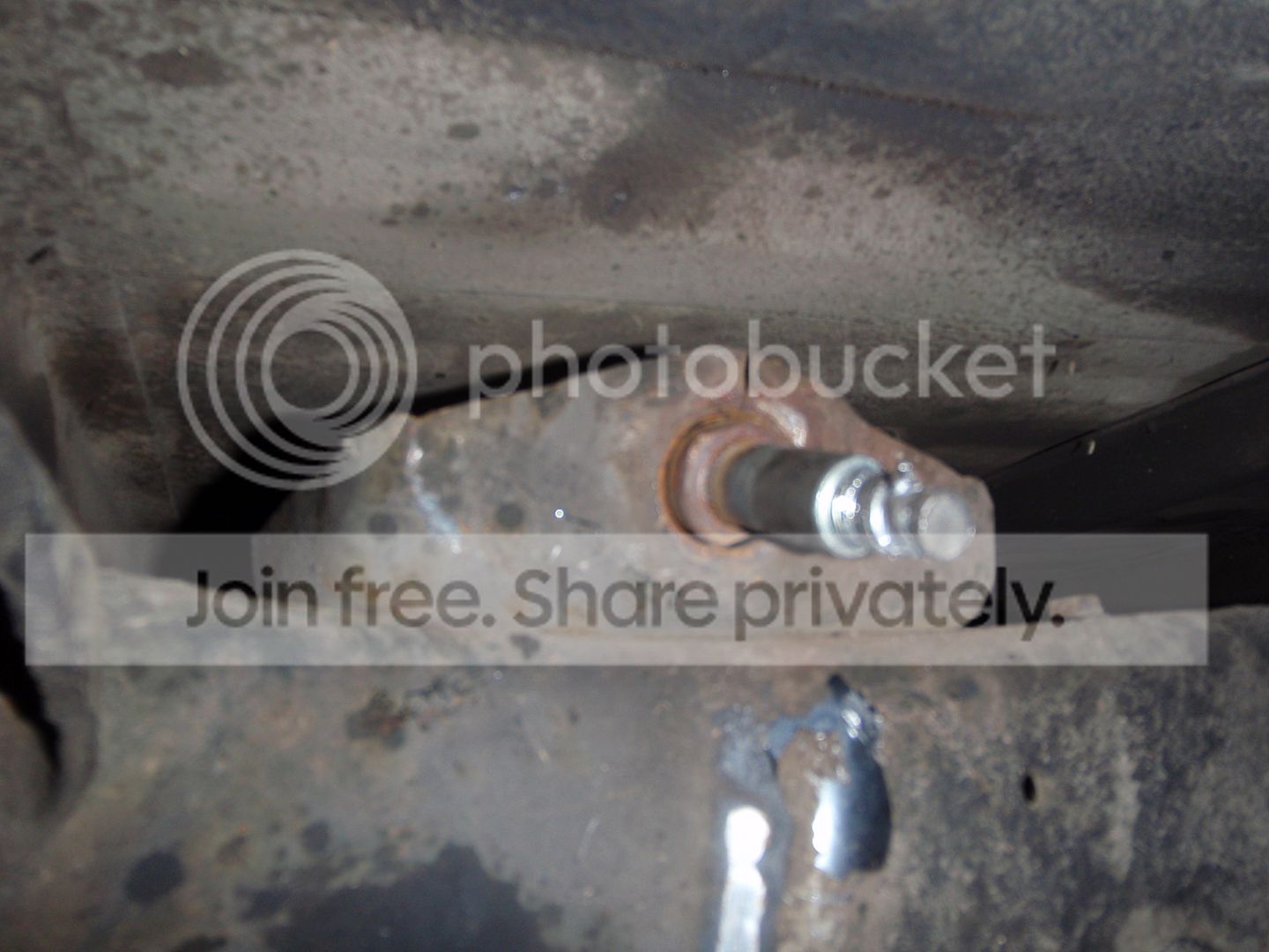

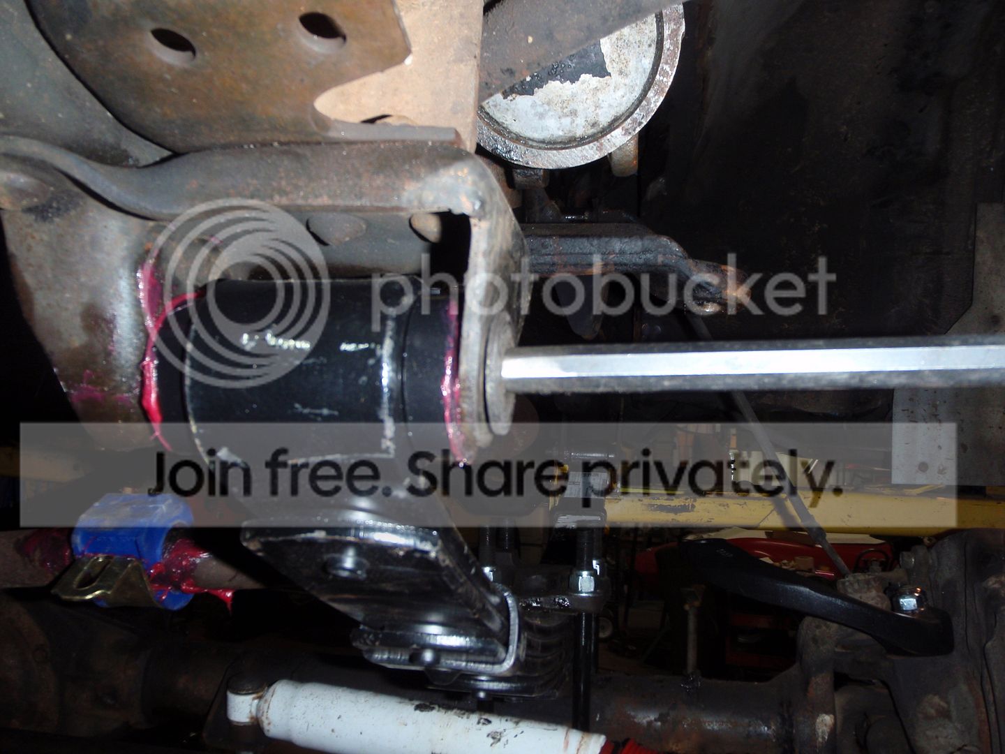

continuation.... like the new front bolt?
I found a rattle
I may have cheated
not going back on

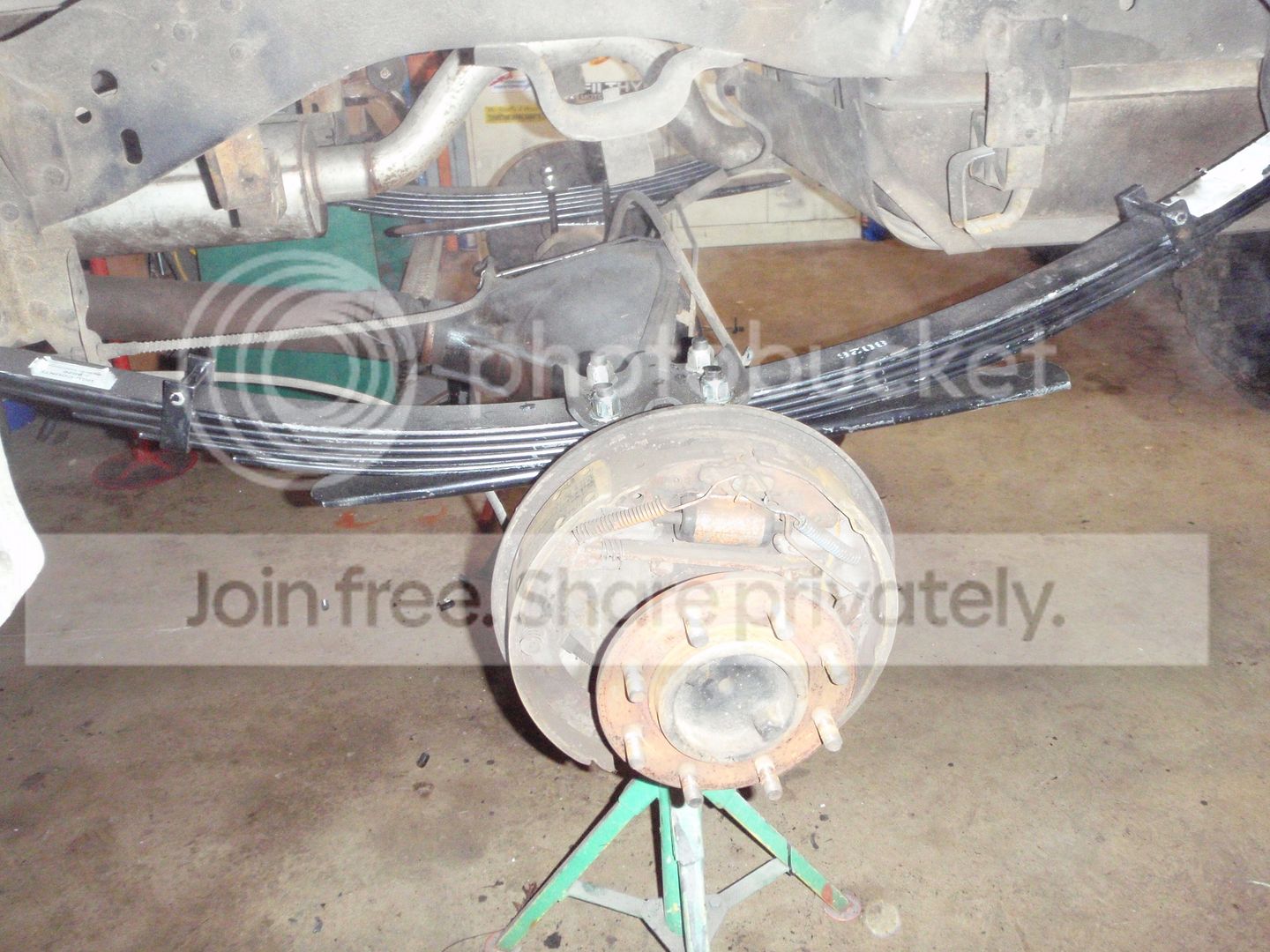

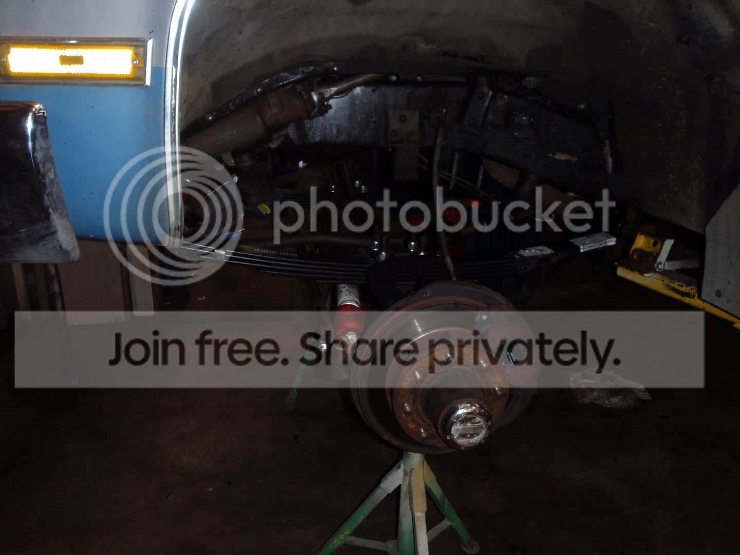

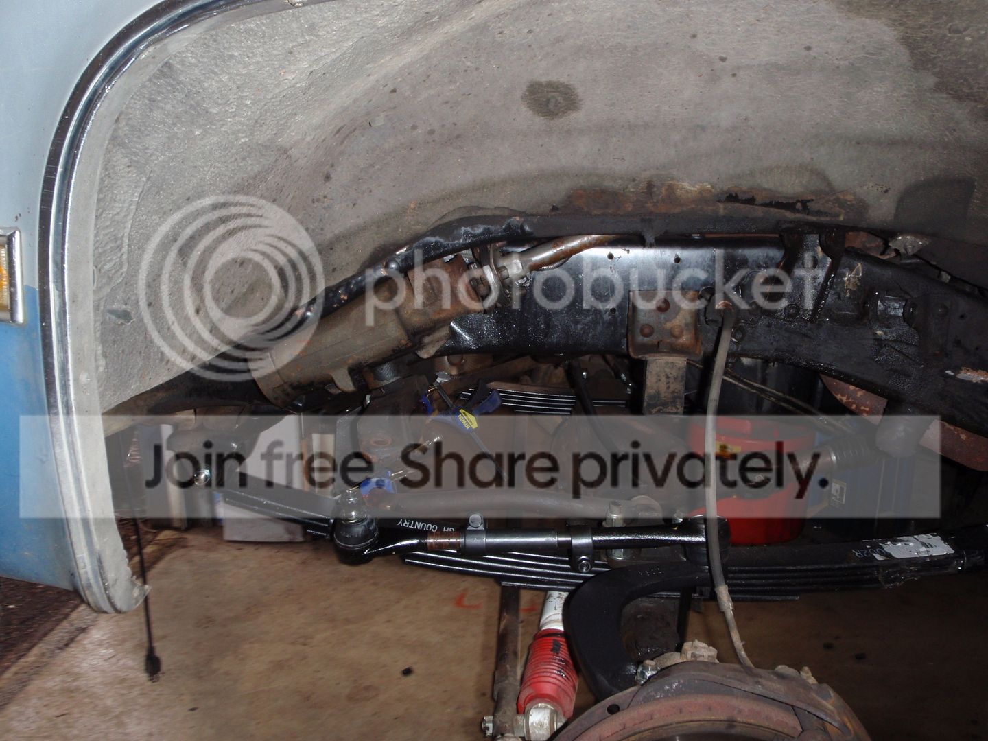

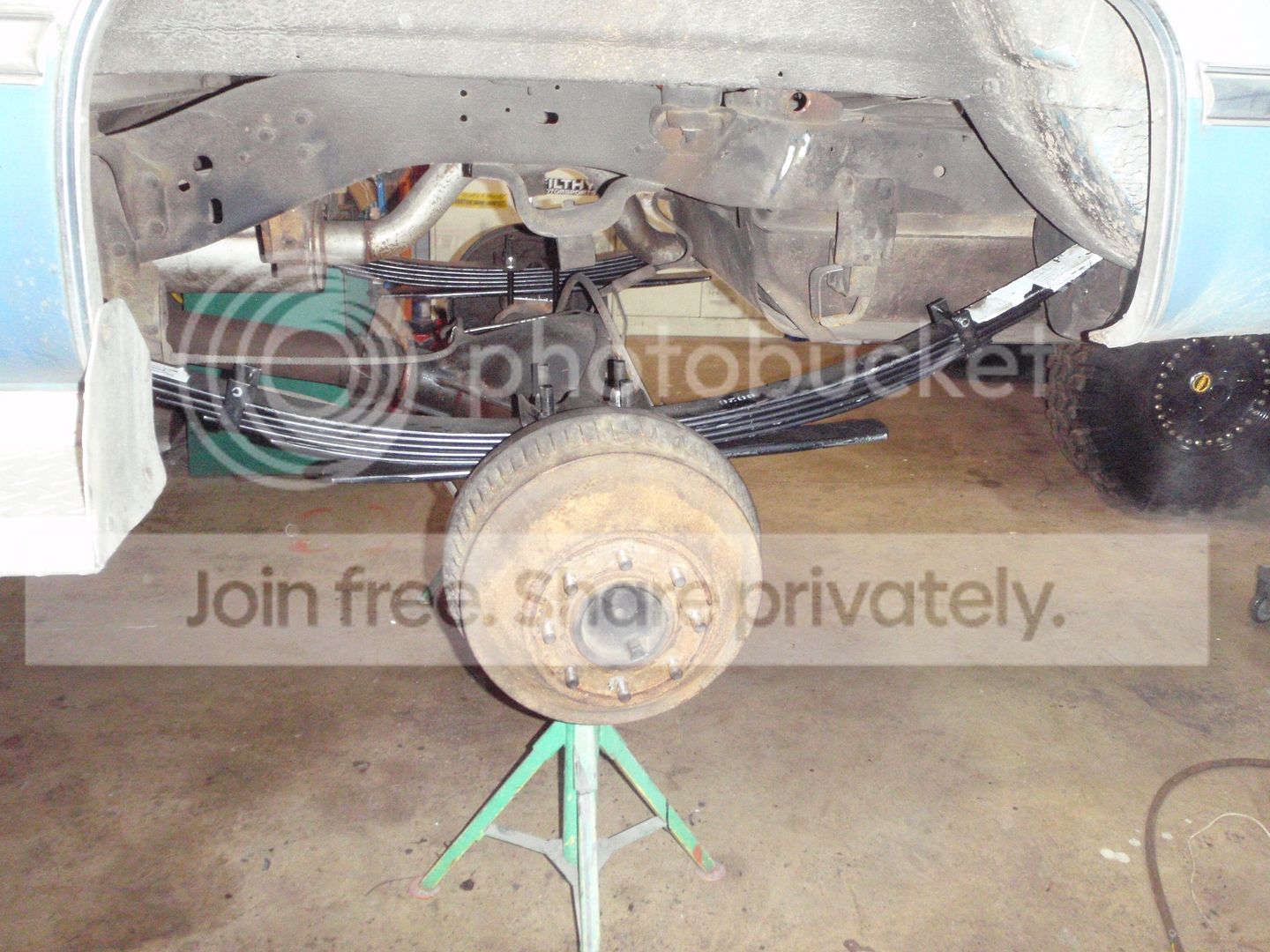

and getting there... not light springs, not light at all

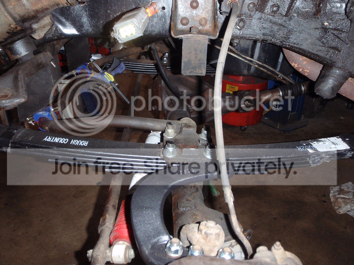

started to mount the sway bar, then realized I really need to buy some more 3/8 grade 8 bolts... tomorrow for sure

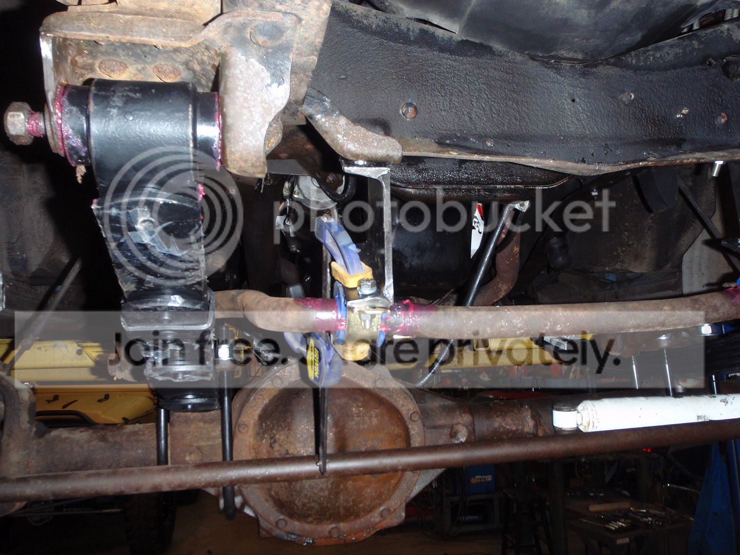

yesterday was air spring, now air steering

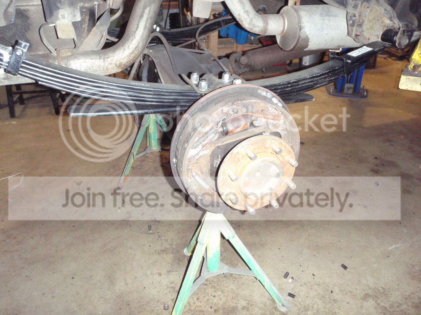

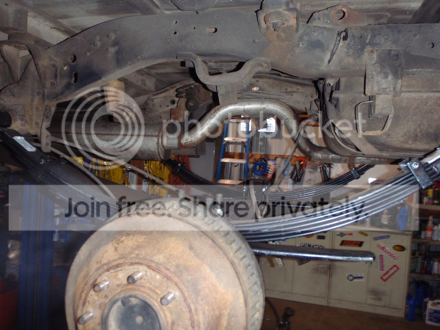

rear getting there
I always feel like, somebody's watching me

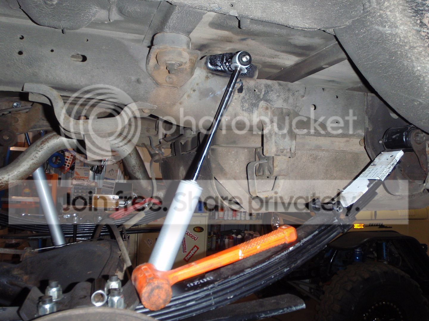

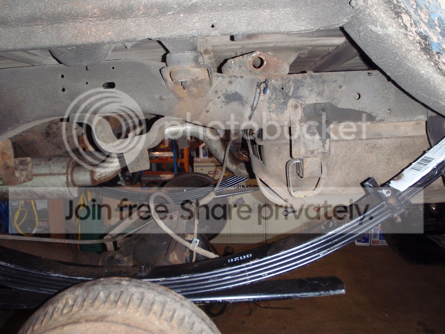

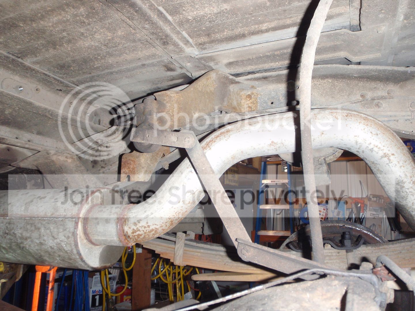

cut the ubolts down
I swear the back spring was harder then the front

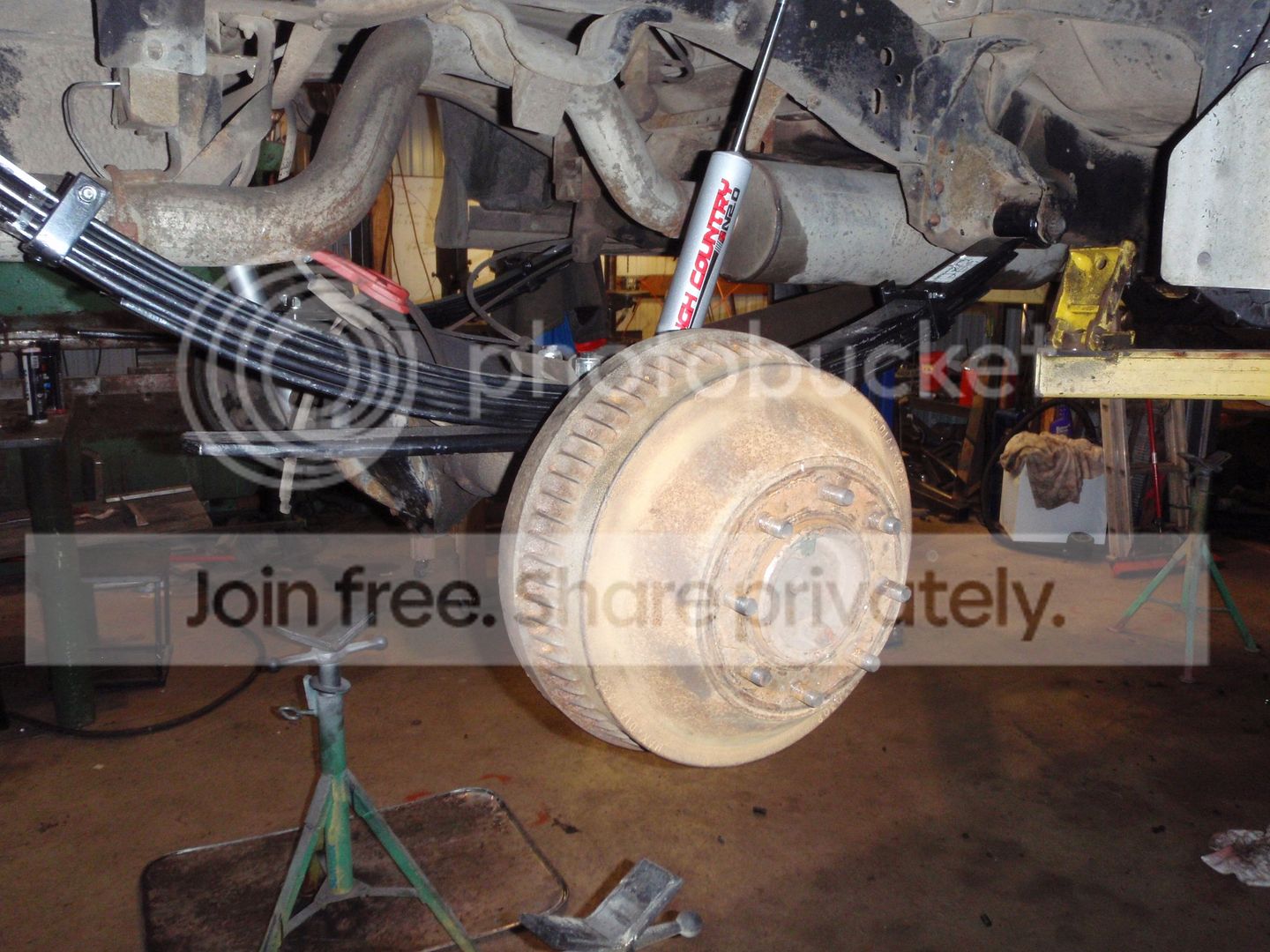

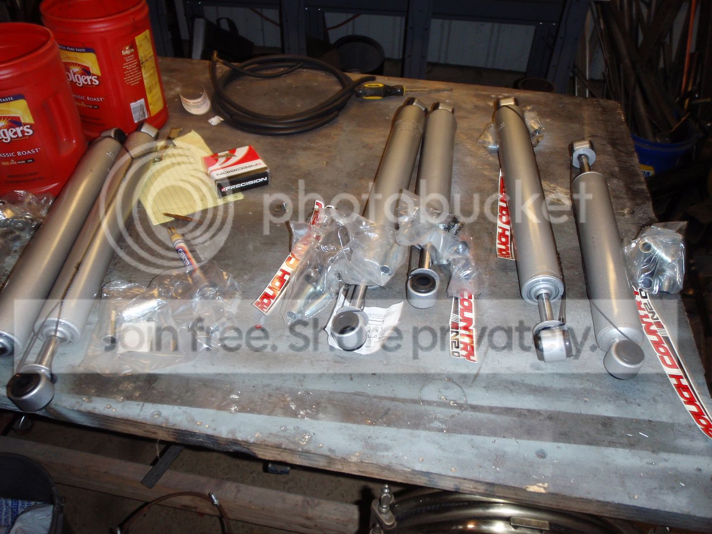

sorting shocks

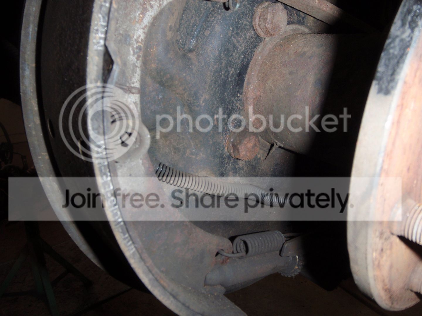

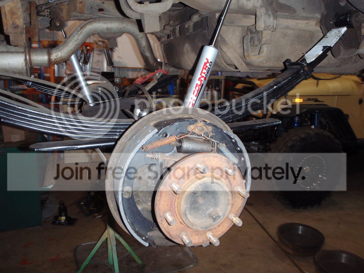

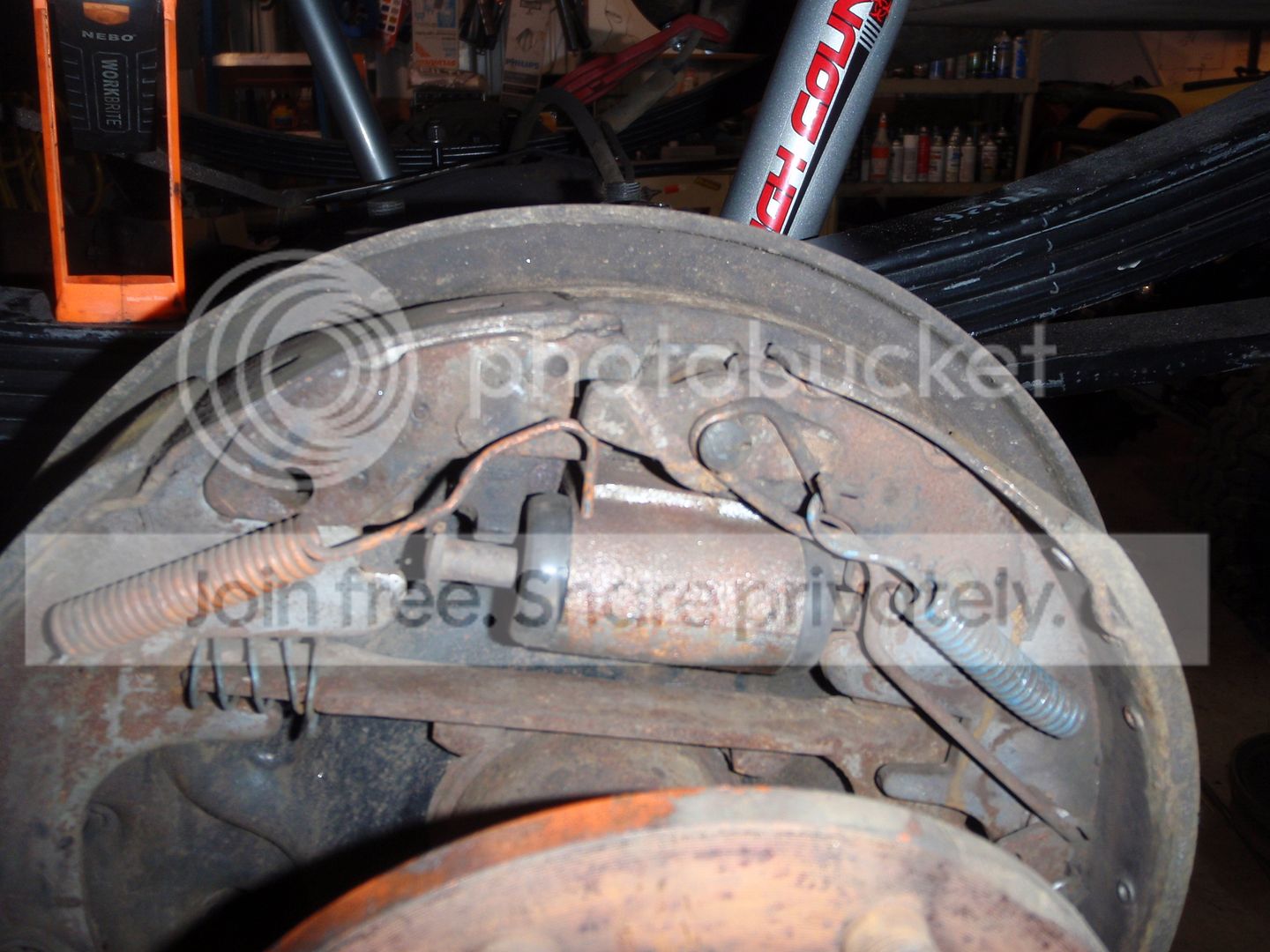

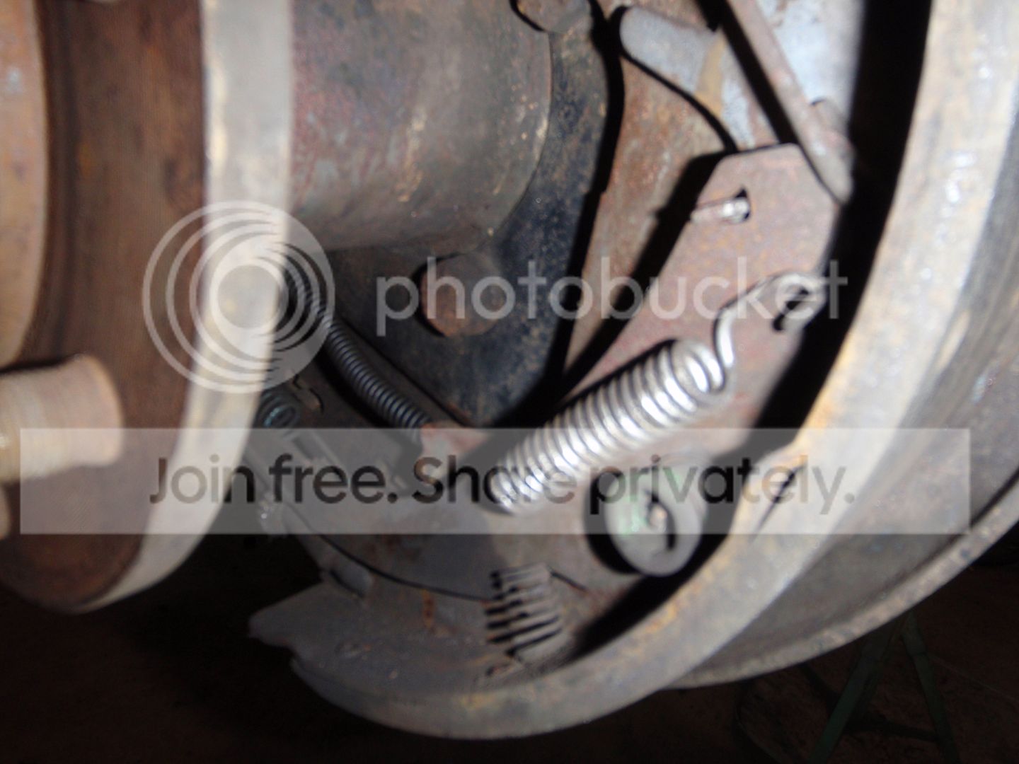

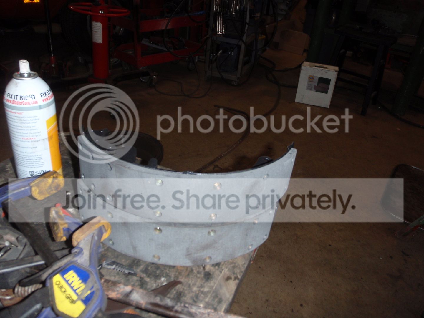

so I did it, I pulled the drum off.... 40%, maybe... time to turn the drum and put new pads.... but I do like stopping so it is what it is.
and good thing I did, passenger side was leaking
steering is no longer an air connection
nor is the sway bar
shocking development....
whoa
new whoa

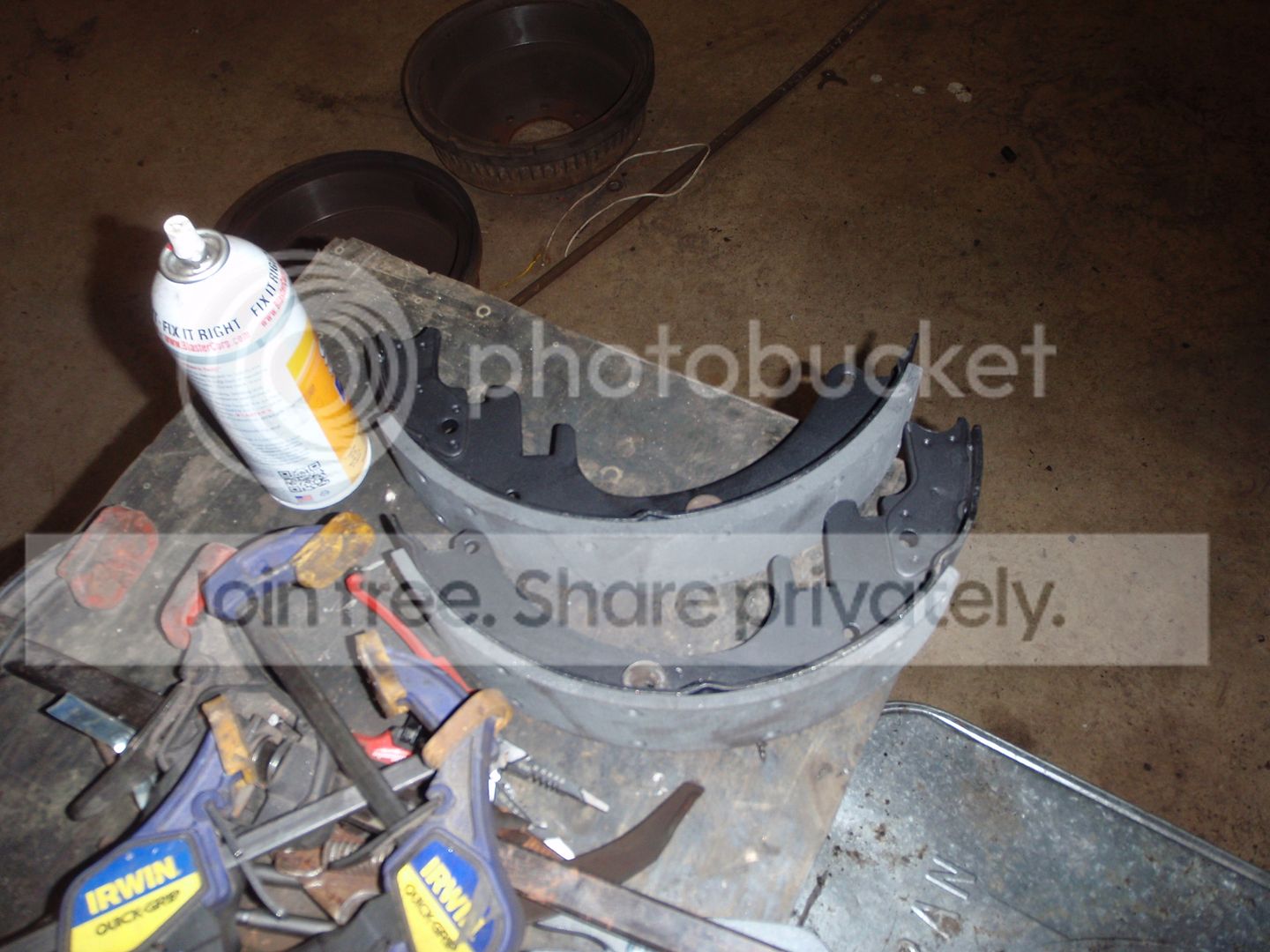

front pad is on the bottom - notice how it's shorter?
thicker pad goes on the back (the longer pad)
apparently the PO didn't notice that. The driver's side was correct, passenger side not so much
assembled with go fast stickers on the shocks

Were the springs off the brakes when you pulled it apart?!? I've never seen that happen before. Whoa indeed.
they were assembled correctly, just wrong pad order. I'm sure what they did was copy the passenger side with the driver's side.... there was also no fluid in the driver's side slave cylinder.... anyway, it'll have brakes and that is a good thing :)
