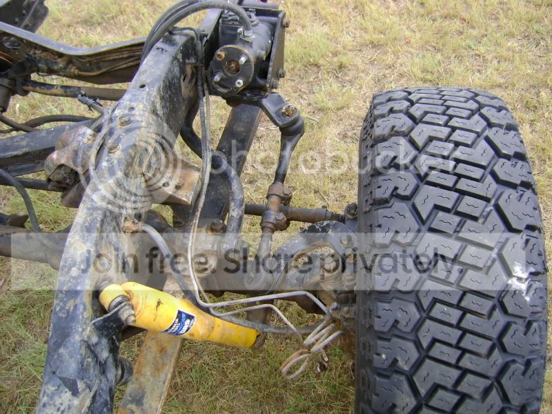

Steering set up on my old K20 with RHD pwr steer direct to the frame, no surprises here the frame was cracked and the box ended up tearing from the frame.

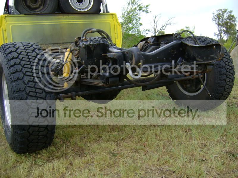

My current K20 has a lightweight version of the outboard box, I'll be giving it the flick and replacing it with a 3/8 version before I put it on the road again. The relative thinness of the steel and lack of contact against the frame means this one stresses both itself and the frame too much for my liking.
