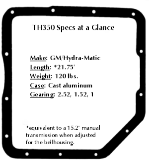

you should have a TH350 in that year. doubt its a TH400. it is a 3spd automatic correct? 4.11's should be fine
A 700r4 would have overdrive. Here is some pictures of the shape of the pan, just crawl under and have a look.
Th350
700r4
This should help..
Click for fullsize picture... this is a TH350 oil pan

Yeah, 3 spd automatic, so the TH350.
