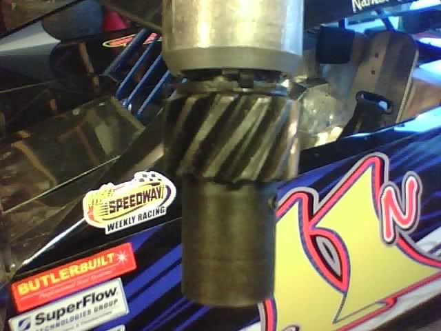

So I walked out in the garage and dug the spare distributor out of the race car parts. That turns clockwise.
That means the gear pushes forward. The flat tappet cam is tapered, and keeps the cam from walking out the front of the engine (and spins the crowned lifters). Why do you think there is no thrust plate. Then when Chevrolet went to roller cams in 1987 (roller cams are flat, they want the roller to contact as much of the lobe as possible) they added a thrust plate to hold the cam in the block. The same as if you put a retrofit roller cam into a non roller block, you have to use a cam button.
